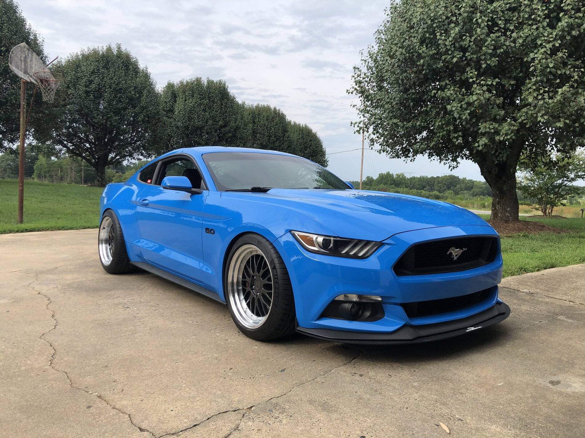

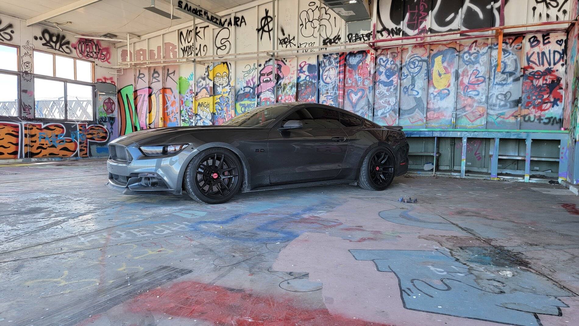

Had the 19x11 square set up installed today and took off the 20’s square set up that I had on the car in Matt black. The 20’s ran Dunlop’s 305/30/20 rear and 285/30/20 fronts. The 19’s are running 305/30ZR19 Goodyear Eagle F1 Supercar 3R all around. Springs are H&R’s super sports if I remember correctly. These are some quick shots I took when I got home will try to get some better ones later in the next day or so.

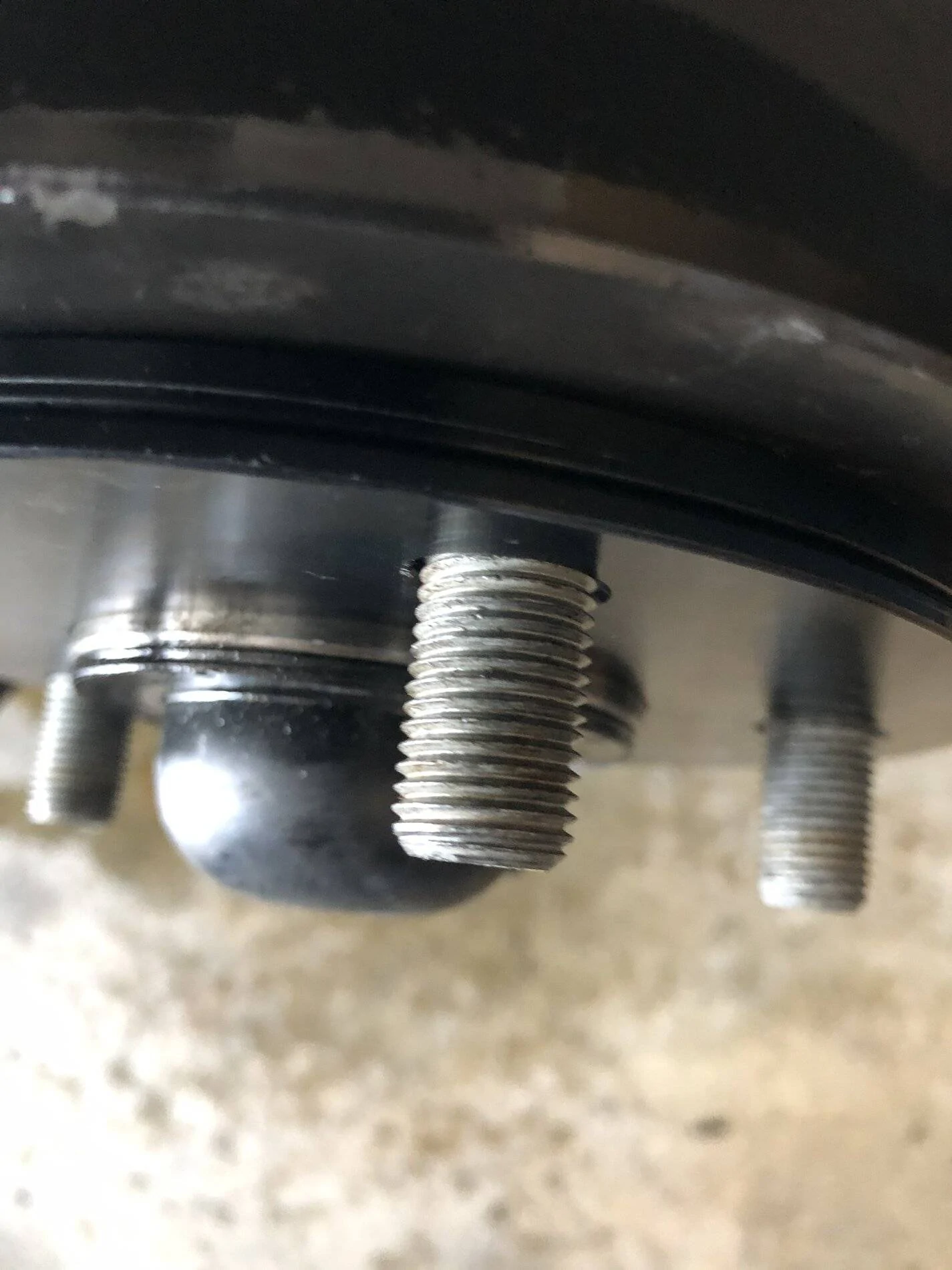

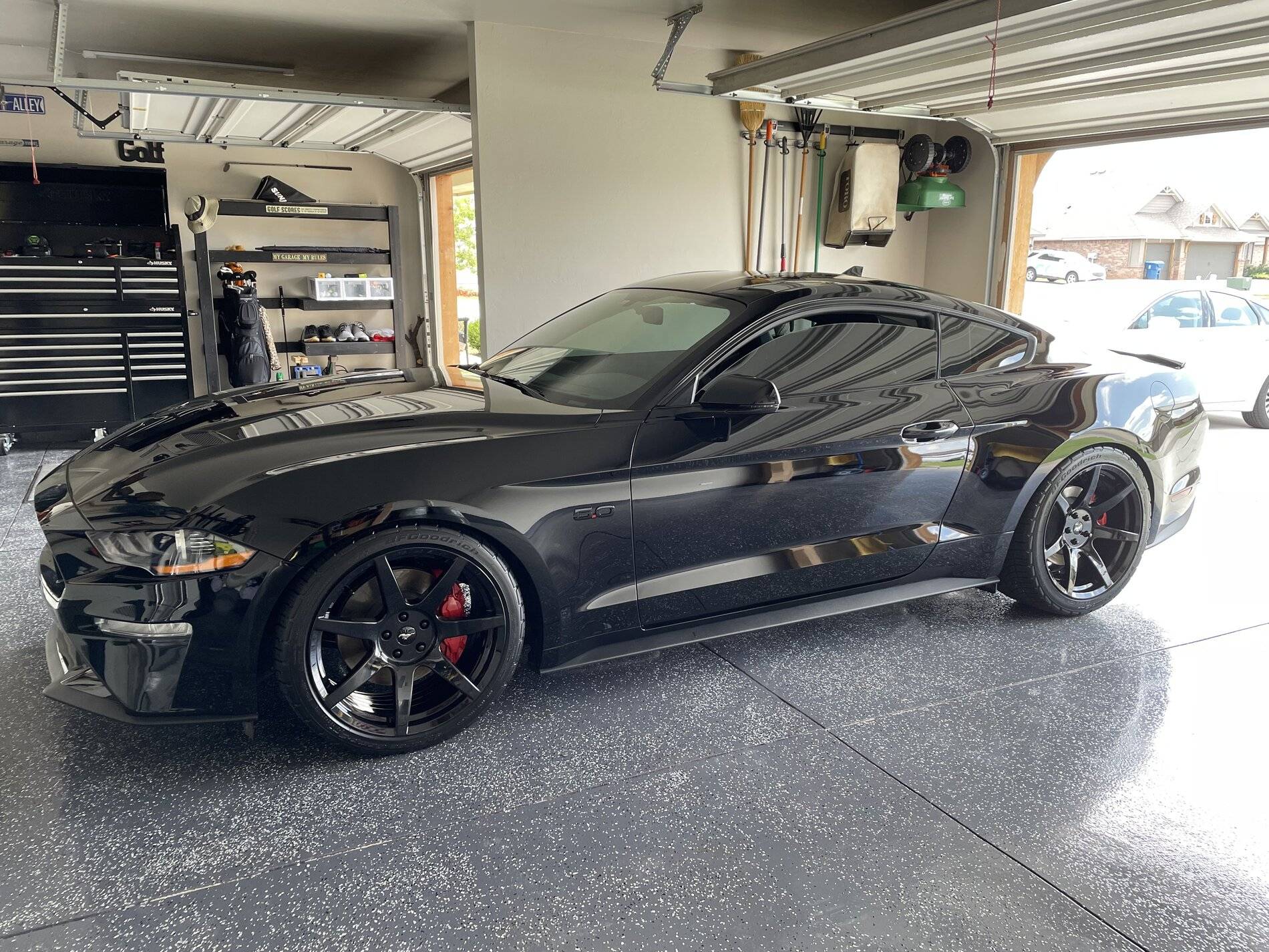

What’s up every one? After doing 2 months worth of research this is the end result of the wheels and suspension set I got. Here is the details and some pictures.
Michelin pilot 4s
275/40/r19 in the rear
255/40/r19 in front
The tires are stretched just a tad.
ESR SR05 graphite color
19x10.5 in the rear +22 offset
19x9.5 in the front +22 offset
sport line lowering springs-by Eibach
1.5inch in the front
1.3 inch in the rear
I bought from CJ pony parts a 5mm spacer and a 1/8 of an inch spacer to make right at 8mm of space and the wheels fit perfectly!
i bought a pack of chrome lug nuts from orielly’s. The stock ones are to fat.
little bit of camber in the front and rear. It does rub without rolling the fenders. I haven’t rolled or pulled mine yet but plan on to here in the near future. Just from the tire going up
