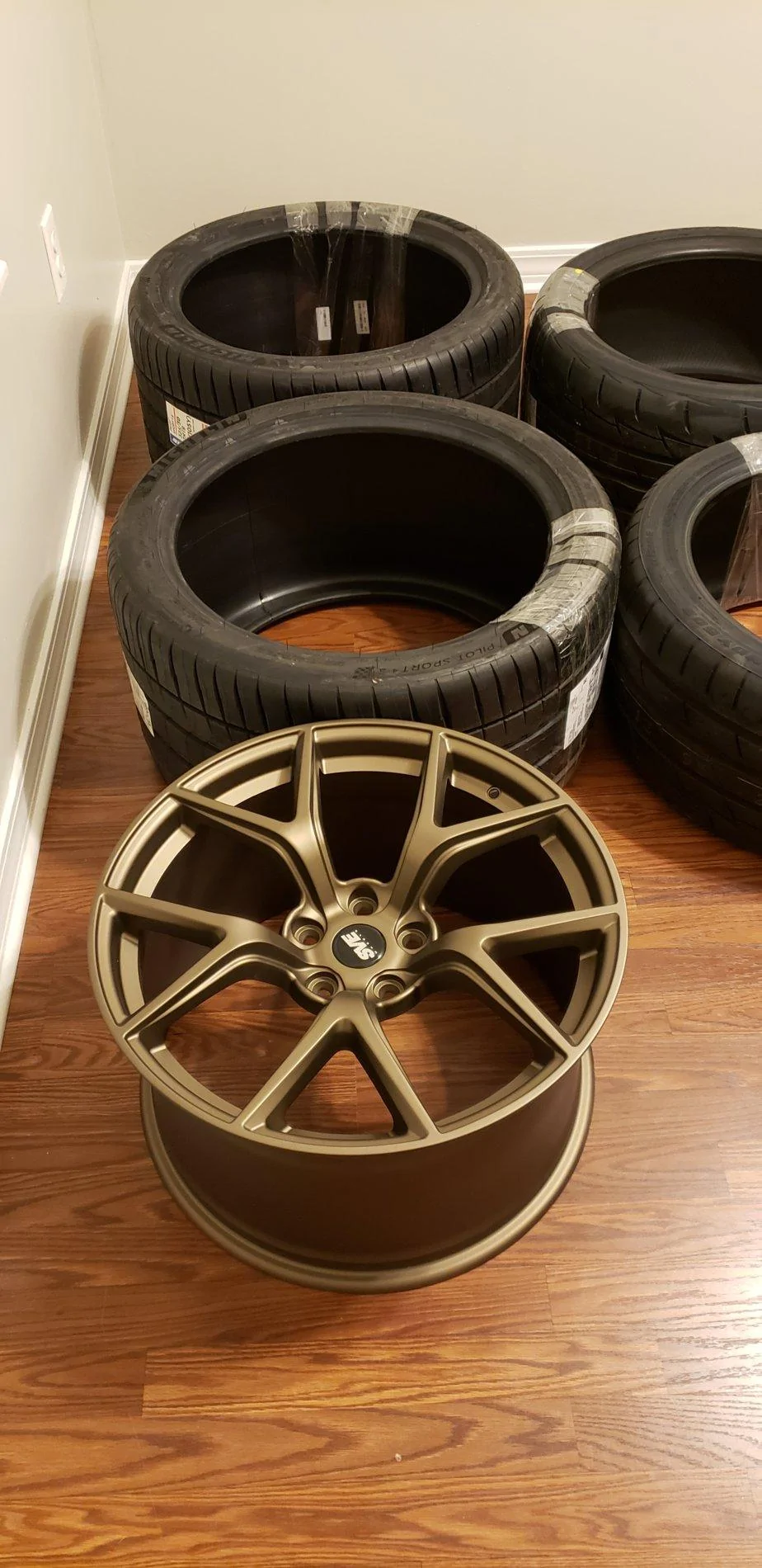

I was looking at this same wheel to the point of hitting the checkout button. When I saw your other fitment posts I figured it was this. Why didn’t you just a spacer? And you got a whole side shot?
A spacer won’t help because it hits the barrel. I love the wheels, but honestly this is too aggressive in the rear. 10.5 with a +35 or +40 would be much better.
And no side shot yet. Only one tire is mounted. It will be a few weeks to ceramic coat the wheels, mount the tires, put onto the car and pull it out of the garage.

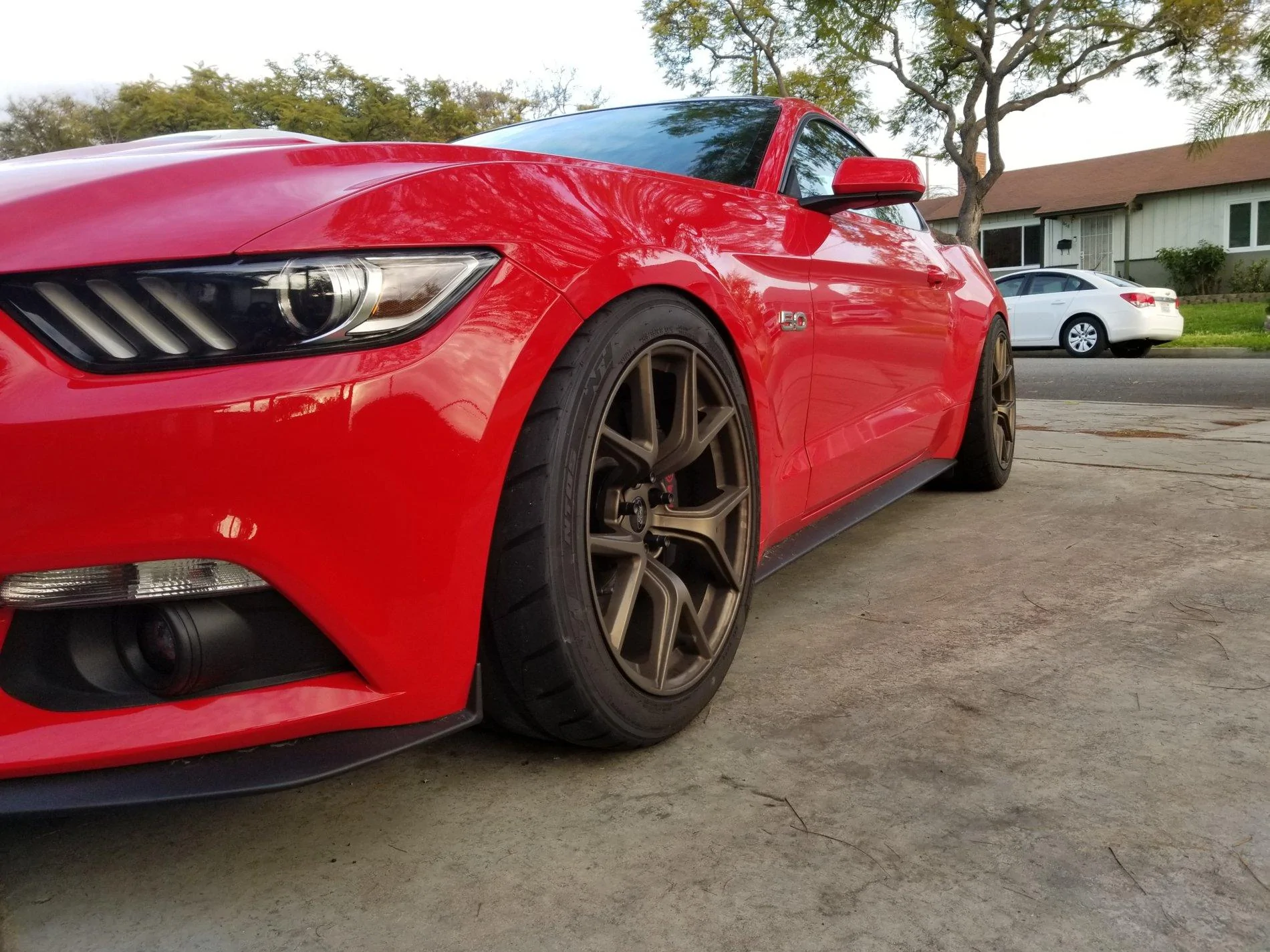

The wheel fit just fine without the spacer. You're correct that 305s work as a square set up with a spacer on the front. I opted for a 12mm spacer in the rear for a more aggressive stance.

Okay thanks so much. Are you experiencing rubbing at all in the front or back? And how long have you been on the setup (wondering about wear patterns).
The fronts rub on hard turns and big dips. The rears dont rub at all. I've had the wheels since Januaryz but I cant really tell you much about wear thus far.

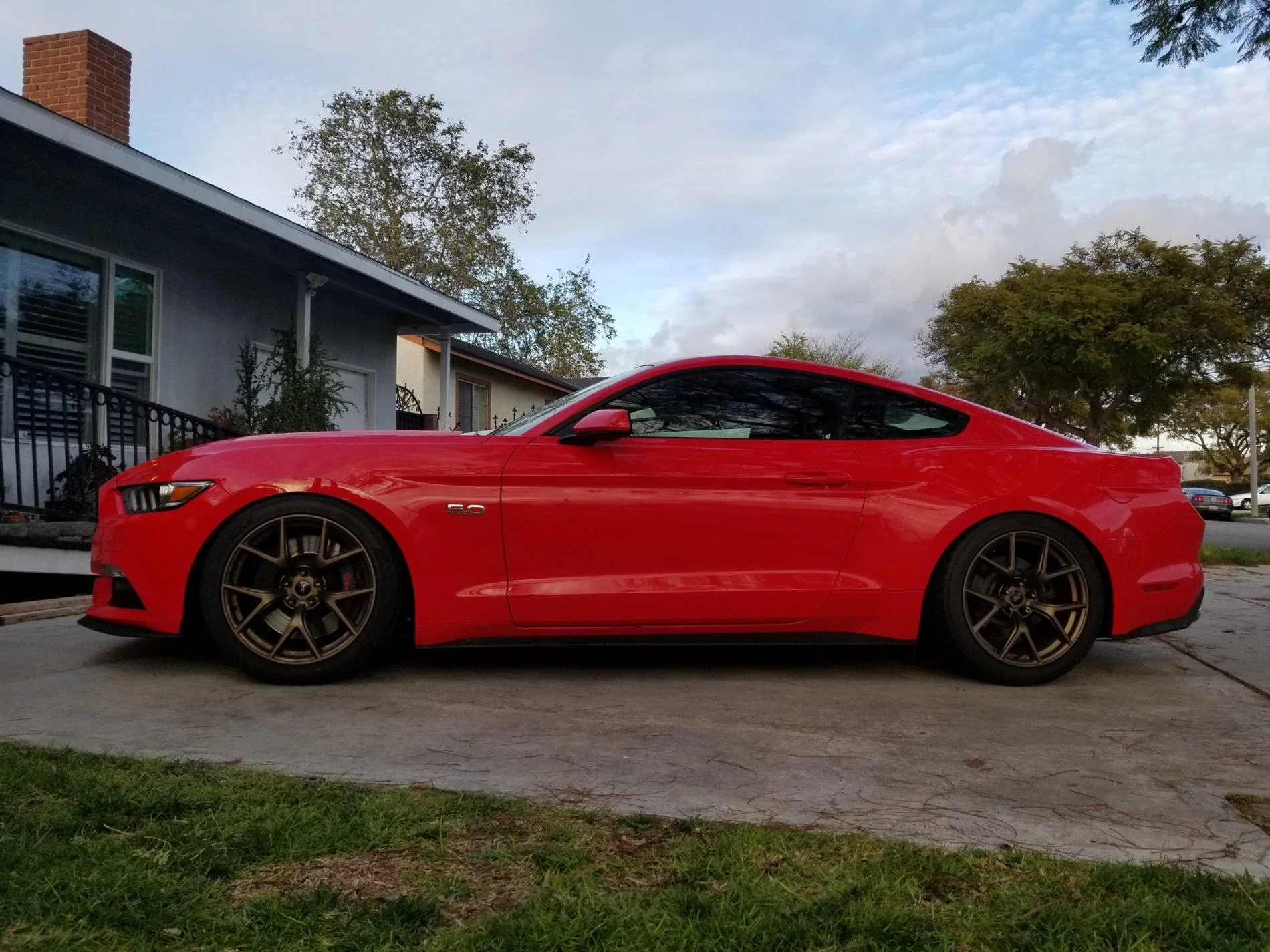

19x11 +50 w/ a 12mm spacer on 305/35 Nitto NT05
Eibach Pro Springs on full compression
No rubbing

I posted the fronts earlier in this thread. Check maybe page 5 or 6.
I'm running negative 2 degrees of camber front and back.

Work Emotion D9R in 19x10.5 +30. 285/35 Firehawk Indy 500. H&R Super Sport springs (Similar to Sportlines).
Will not fit without modification on GTPP car (grind down tops of calipers). Will get the other tires mounted and on the car once I ceramic coat the wheels.
I was ready to buy these wheels, but was worried about the poke on the rear. I wish they had like a +32/35 offset option. I guess I'll just get the T7R instead.
