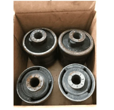

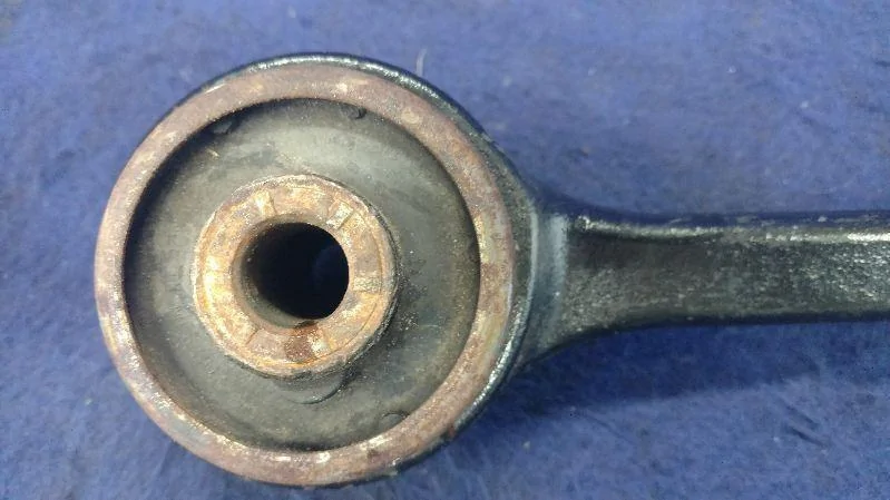

Not all manufacturers use indexing teeth on their suspension bushings which necessitate the reclock. When the bolt going through here is torqued, the teeth bite in and lock a static position. It also forces the bushing to twist during suspension movement (which is a reason why people replace them with bearings). Definitely do it when lowering the car.
Interesting. I never thought about that being one of the reasons why people replace them with bearings. Aside from the obvious (premature failure) what issues would someone encounter if they didn’t reclock the bushings?
The ride generally is noticeably worse as well.
