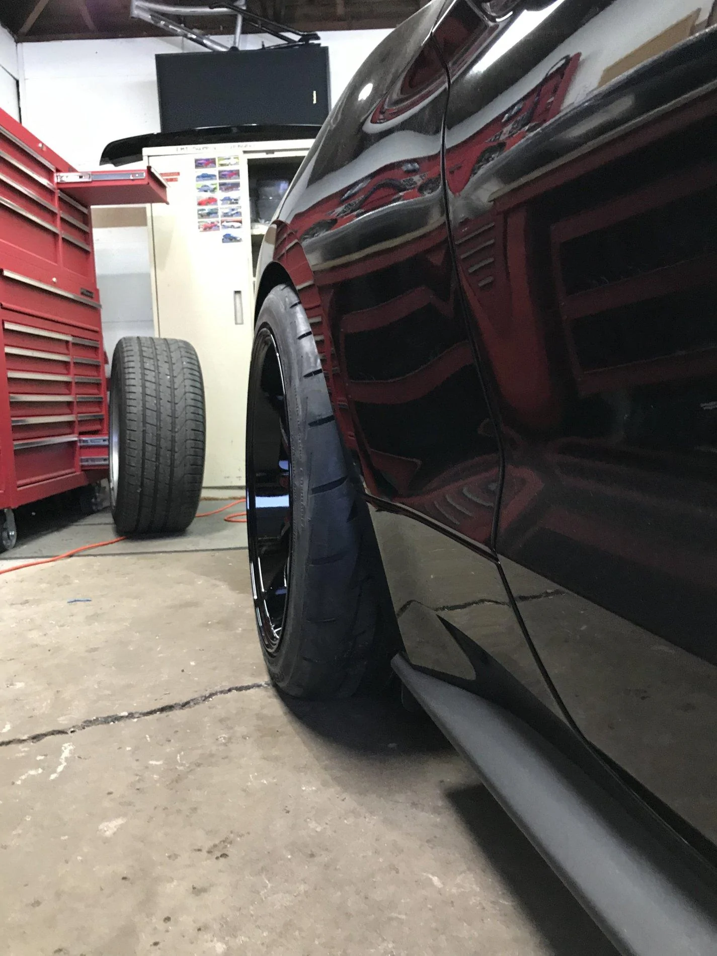

Confirm my thoughts? 285/35 square?
19x10.5 +30 square lowered on H&R Super Sport Springs (about .25" lower than Sportlines).

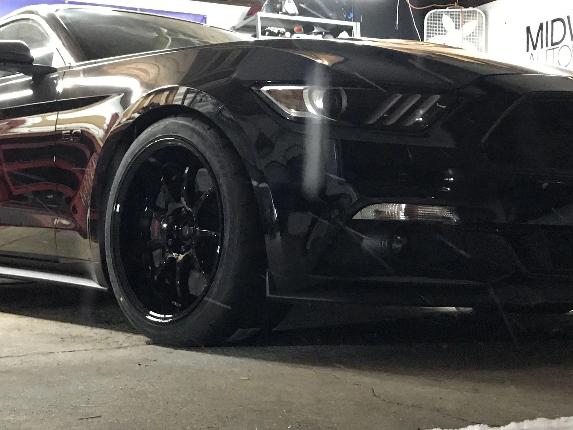

Dont know if its aggressive enough.
Weds sa15r r19:
9.5 +25 with 255/40 tires front
10.5 +45 with 275/35 rear
Lowered 1.4 front and 1.3 rear
That will work. You'll need some camber in the rear. IIRC mine are 19x10.5+32 and require about 2.2 degrees to fit without rubbing in the rear.

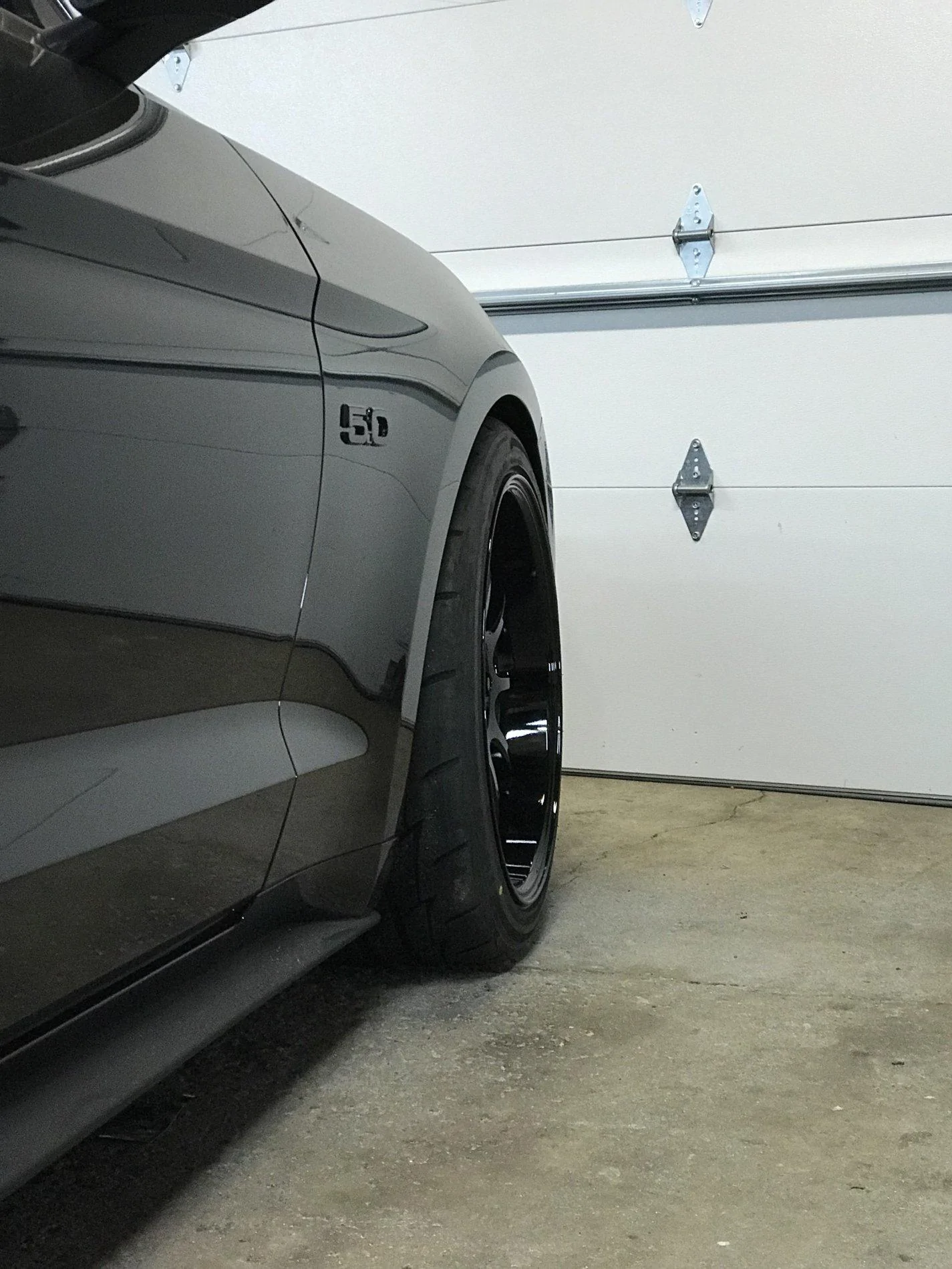

19x11+50 with 305/35 Nittos NT05 all around.
25mm spacer up front.
12mm spacer in the back.
How did that rear wheel fit in the rear without the spacer? Or did it not at all. I'm asking because I've seen reports that 305/30/19 fits square with extended lugs and spacers in the front, but never anything about the rear.
The wheel fit just fine without the spacer. You're correct that 305s work as a square set up with a spacer on the front. I opted for a 12mm spacer in the rear for a more aggressive stance.

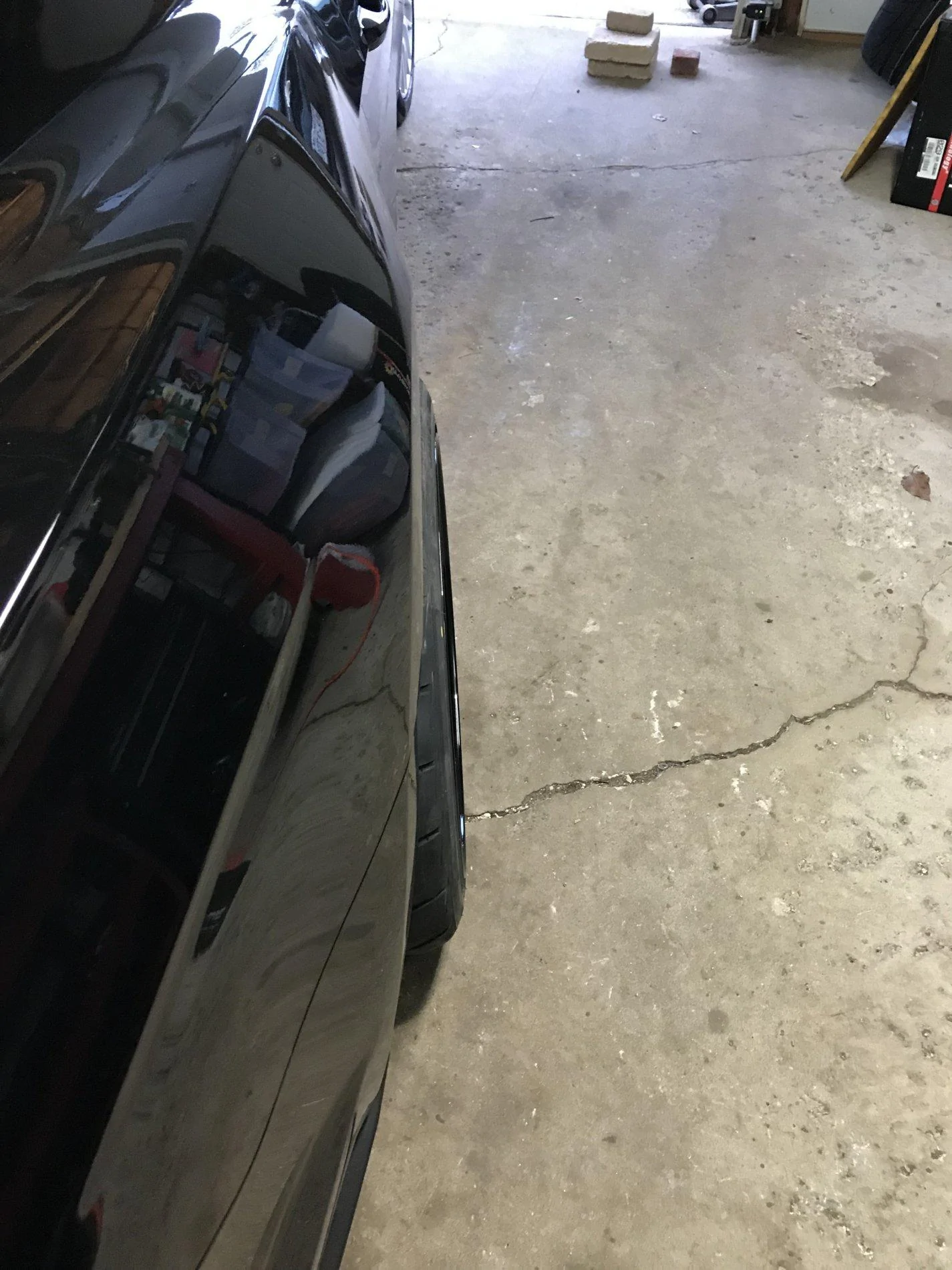

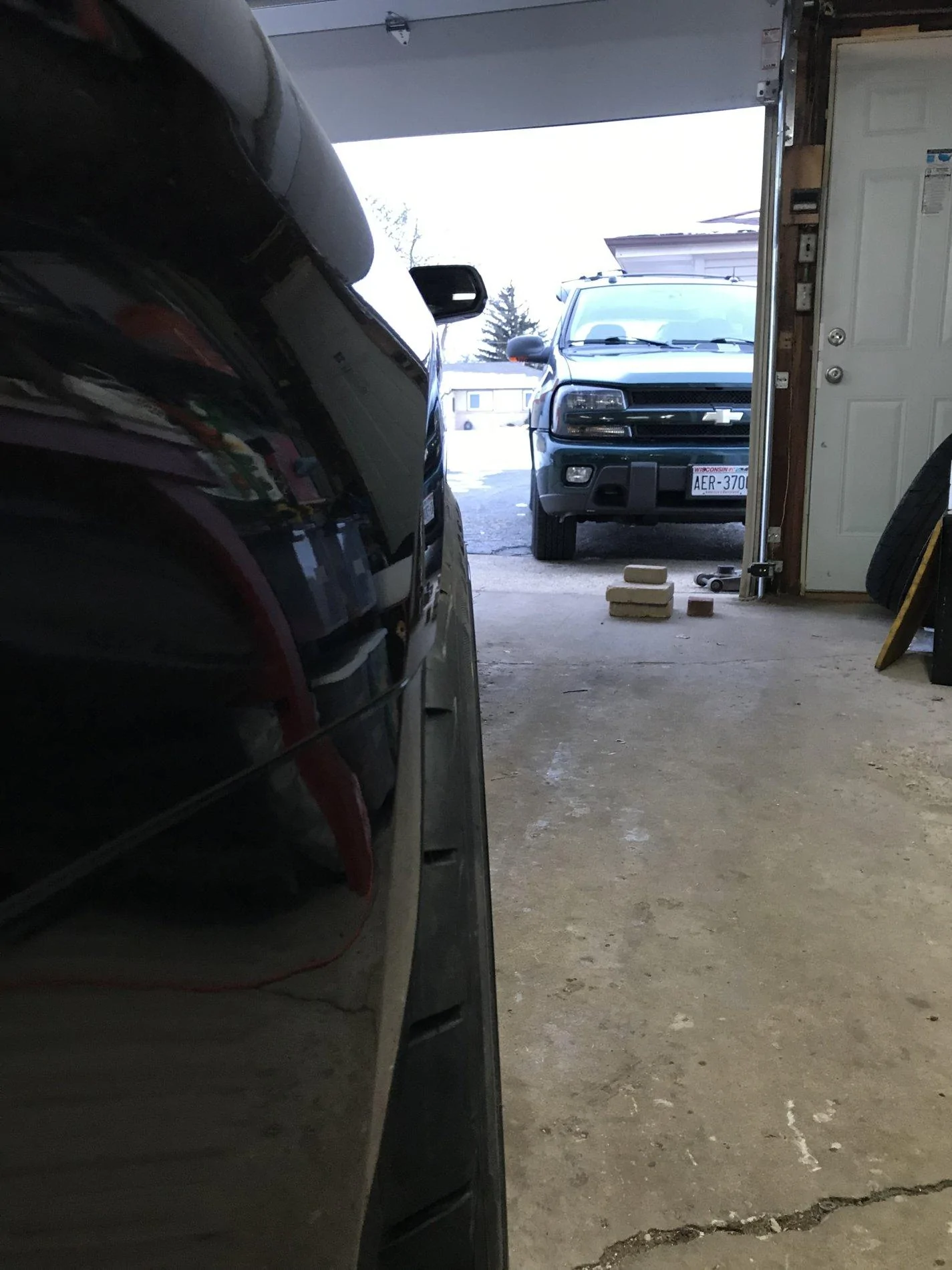

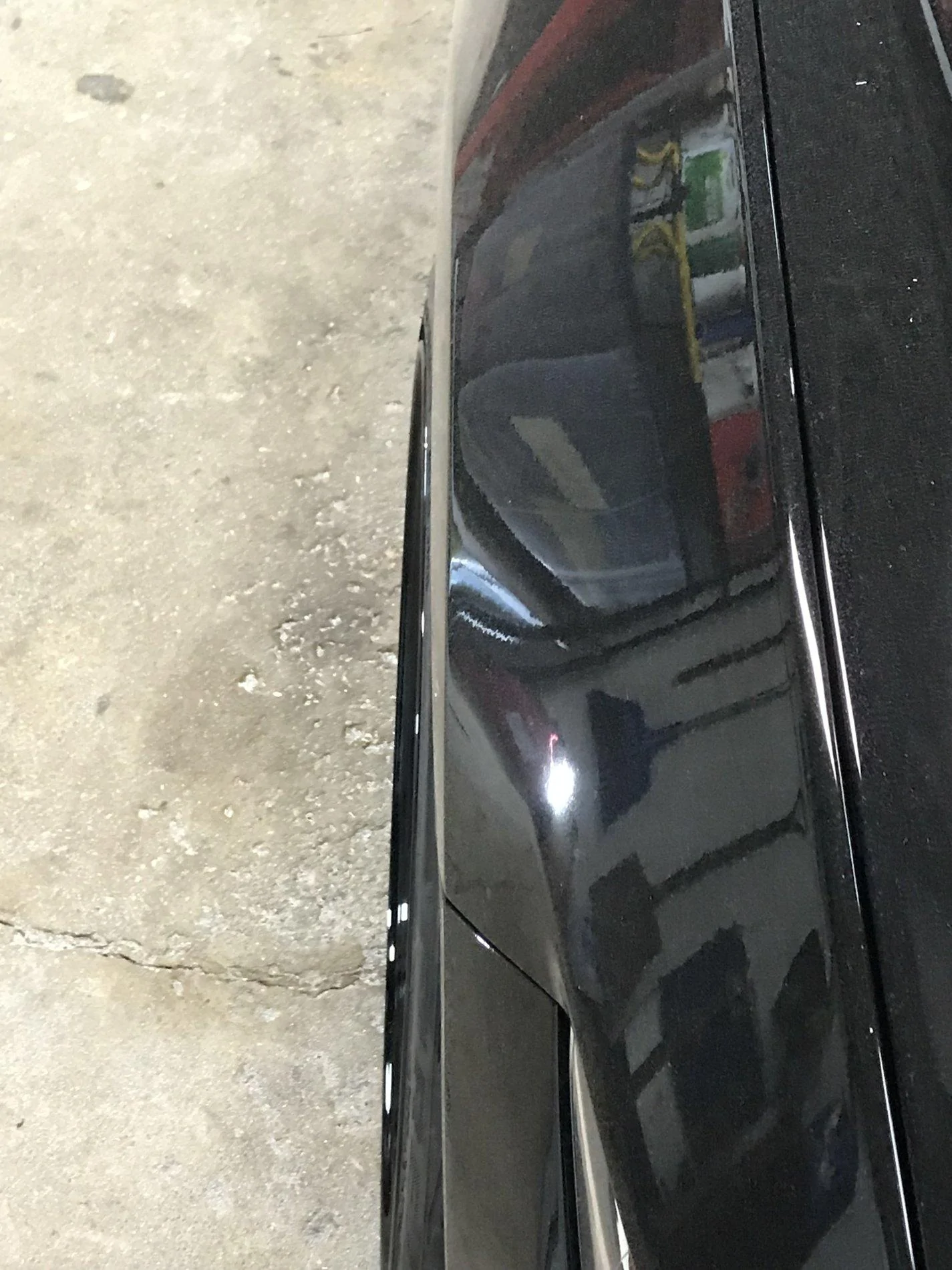

Work Emotion D9R in 19x10.5 +30. 285/35 Firehawk Indy 500. H&R Super Sport springs (Similar to Sportlines).
Will not fit without modification on GTPP car (grind down tops of calipers). Will get the other tires mounted and on the car once I ceramic coat the wheels.
I was looking at this same wheel to the point of hitting the checkout button. When I saw your other fitment posts I figured it was this. Why didn’t you just a spacer? And you got a whole side shot?
