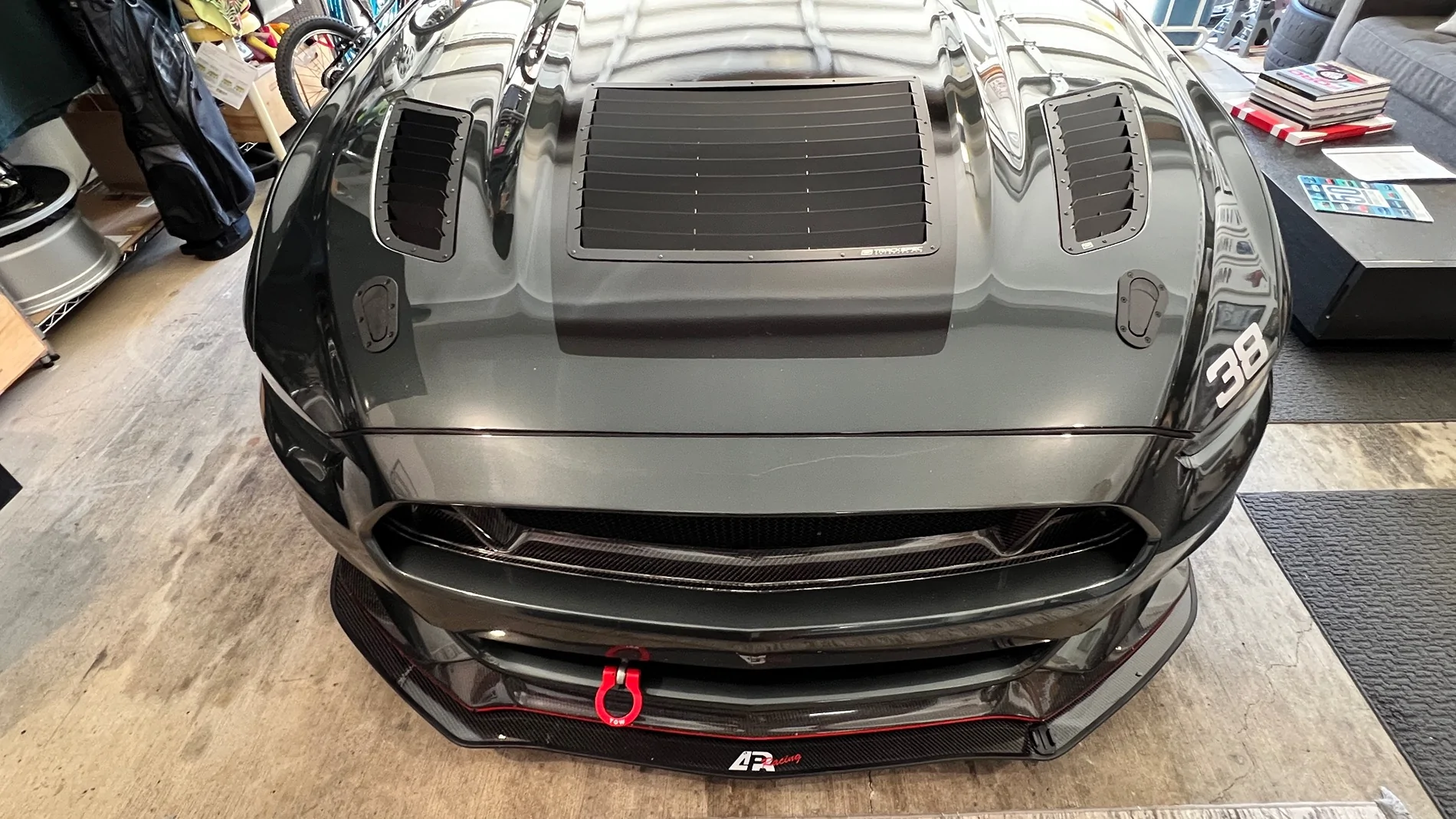

Hey man, sorry for the late reply. Family, work, etc gets in the way of car fun.
Here is a video of the splitter. It’s an old on a kinda long.
I also went with the TrackSpec louvers and Aerocatch hood latches. With all that being said I’ll easily enter turn 10 at Sonoma at 100 mph (which is fun and exhilarating)
Hope that helps

I also got another APR splitter in case that one gets destroyed
Nice work on the clean install. Setting the angle intentionally, keeping the stock brake ‘ducts’, reusing the radiator support mounting locations, and the rear peice were all smart. I just wish it was bigger and lower :)
Thank you and Meeee tooooo!
