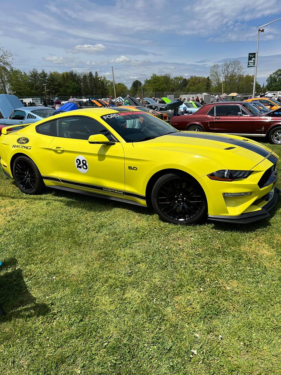

I choose the ford performance because I liked the double splitter
I installed the ford performance track package and it is very low in front have to be careful with curbs and dips in roads

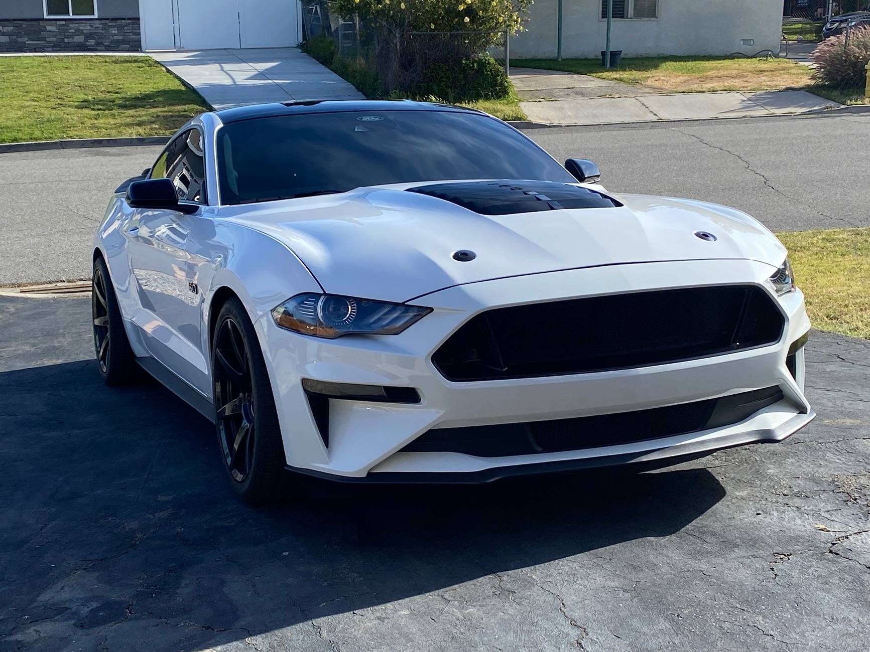

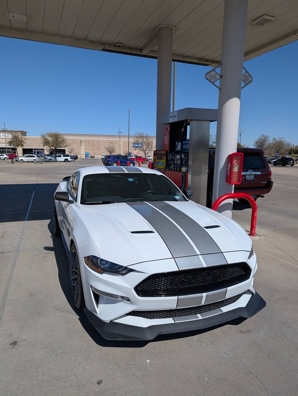

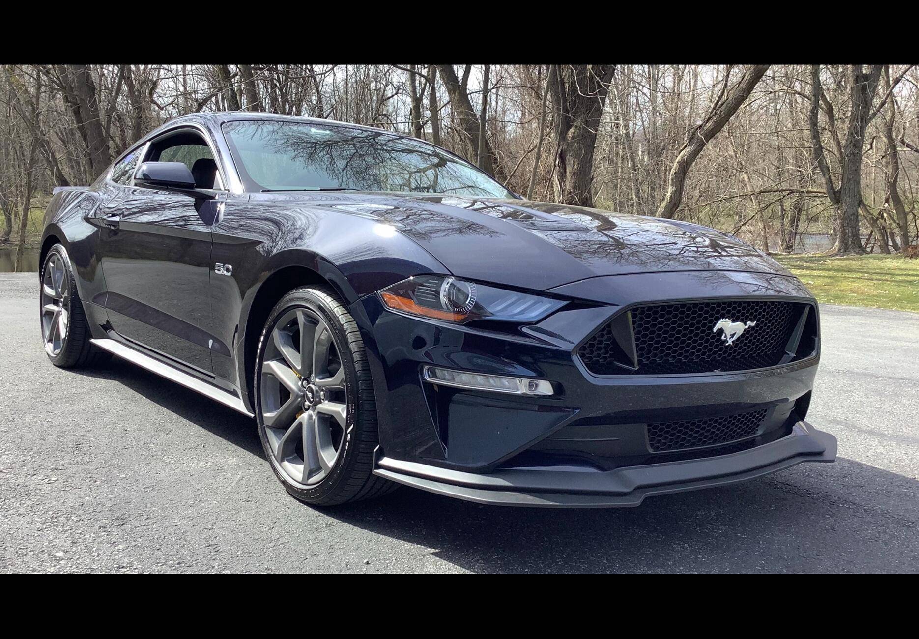

I have the MMD but it's purely for cosmetics. Cell phone camera makes it look bigger than it is because it's the closest part of the car to the camera.

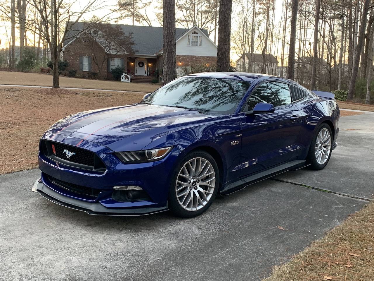

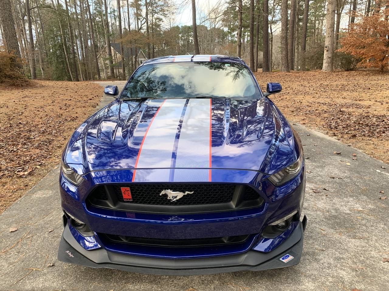

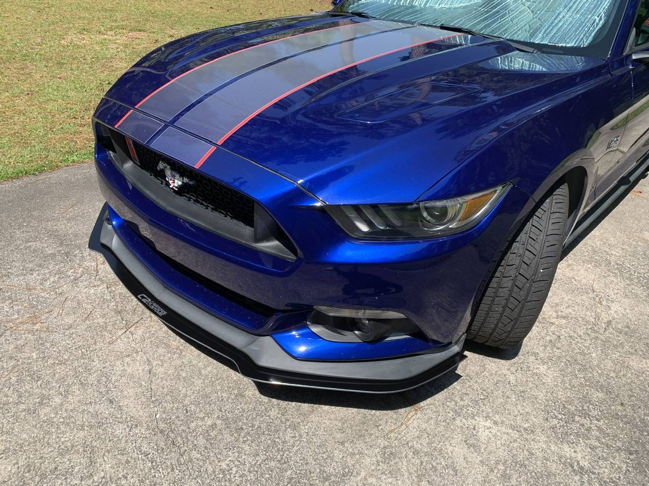

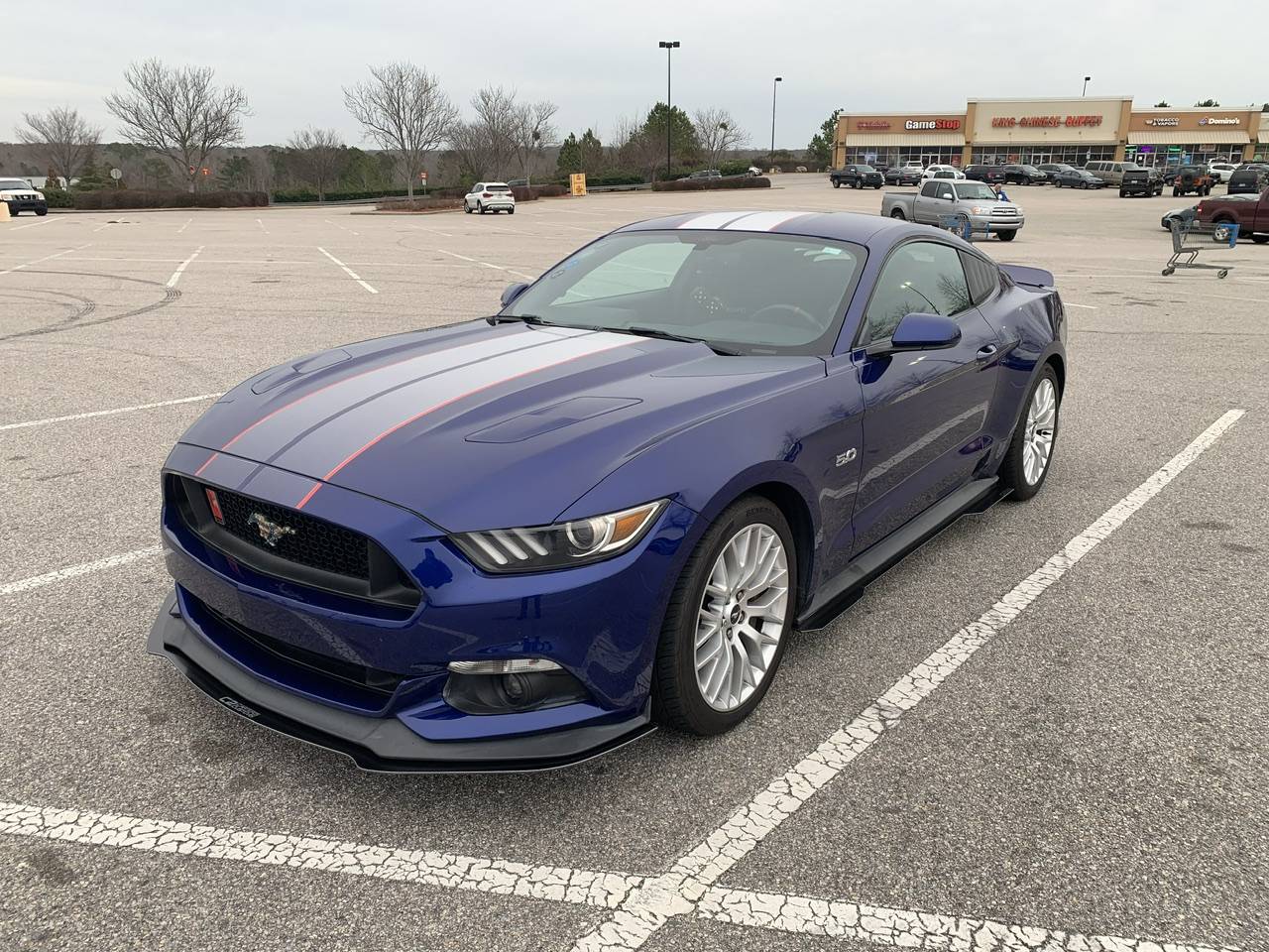

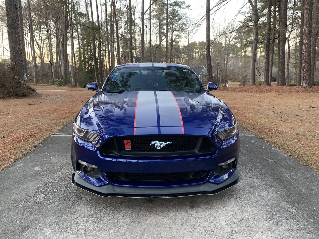

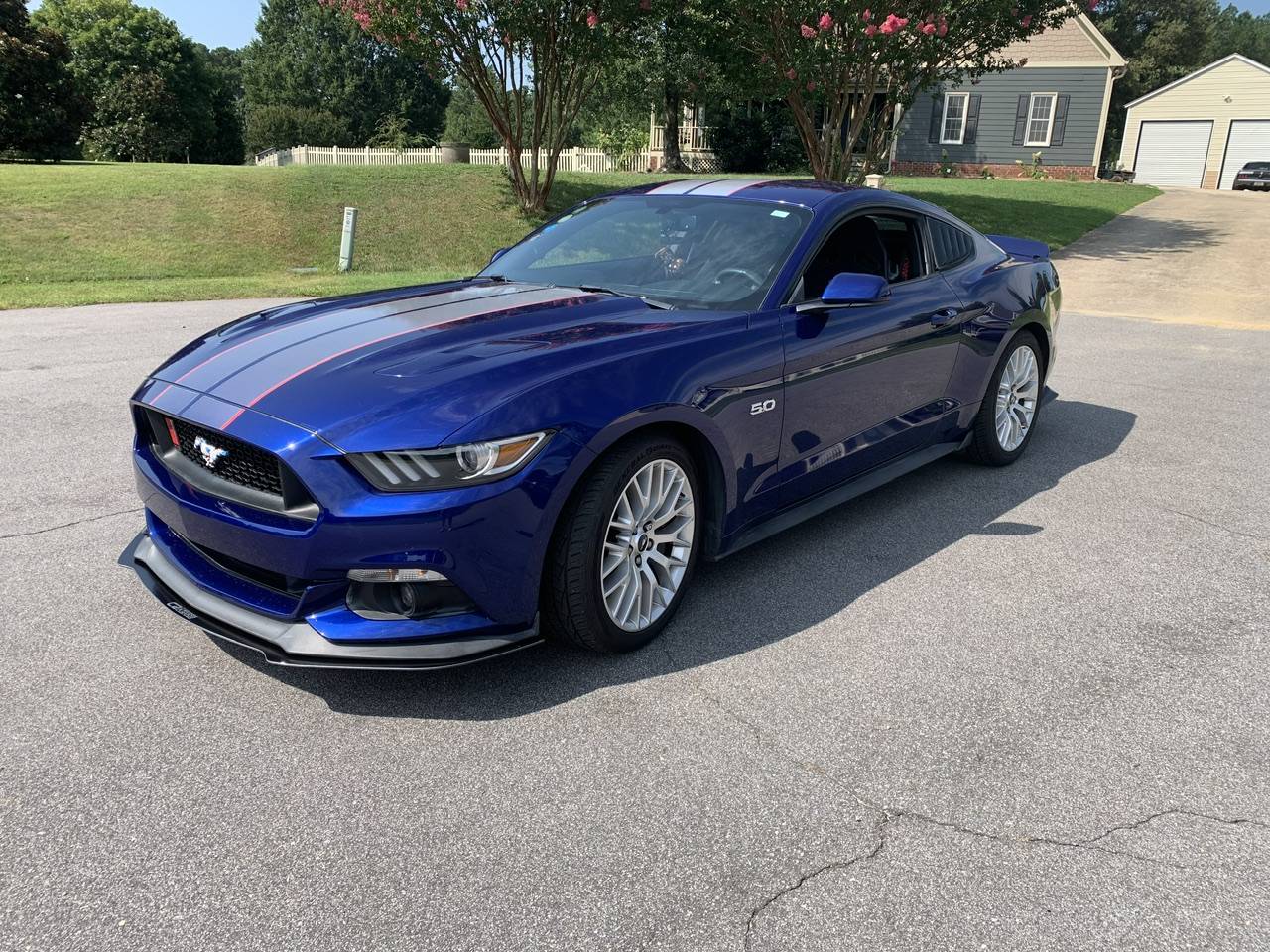

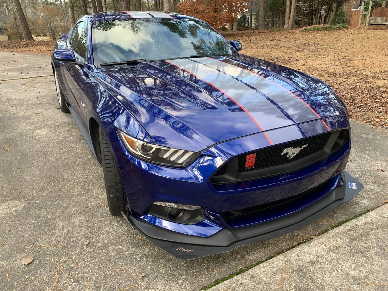

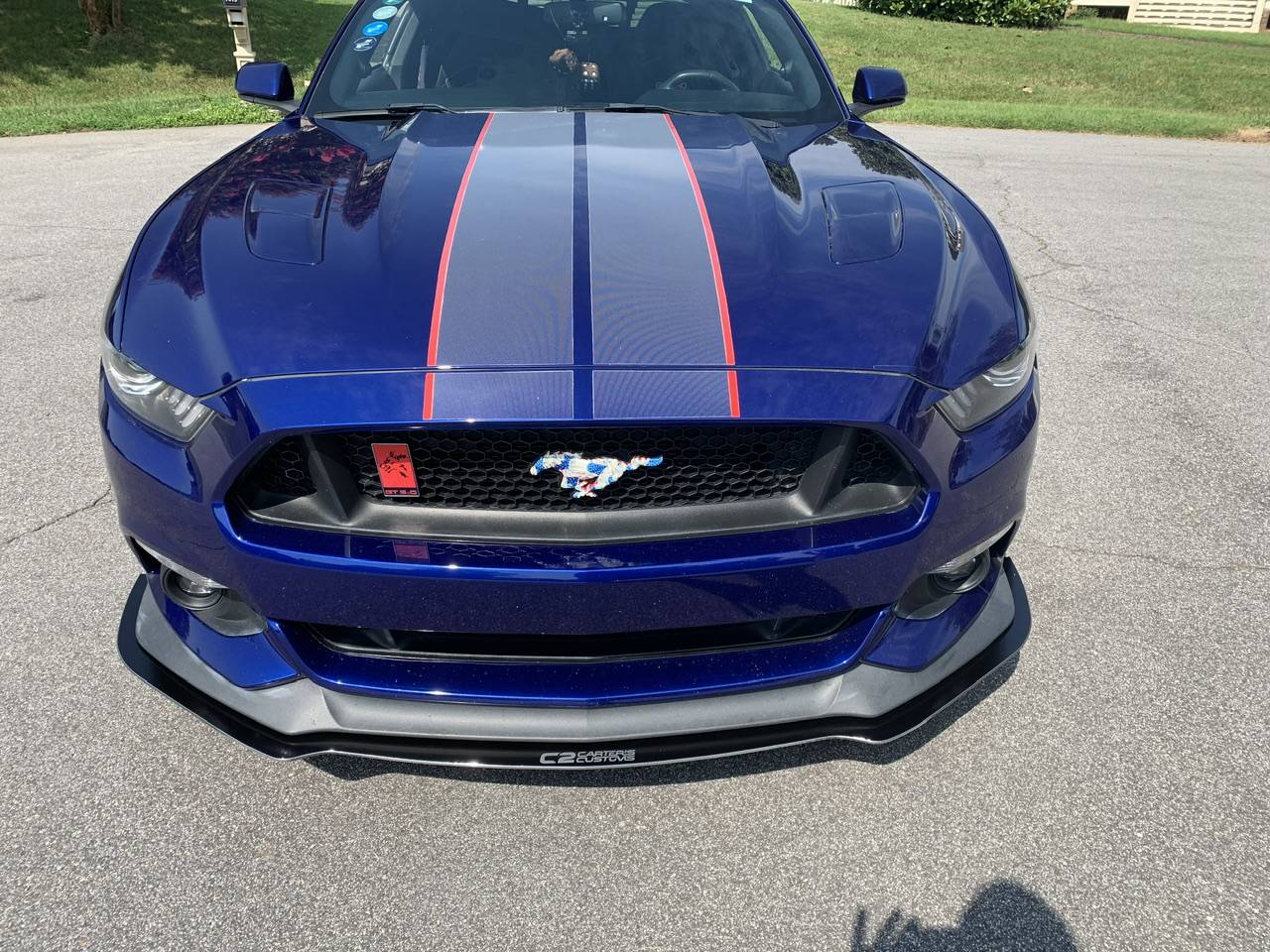

I was using an SBS splitter when I first bought my car. It’s roughly in the shape of the GT-350 splitter. I now have a Carter’s Custom splitter similar to the performance pack 2. Along with the side splitters he makes. It really makes the car stand out and Carter’s Customs is a great company to work with. I still have the SBS, it fits a Performance Pack 15-17 with the cutouts for the brake cooling ducts.

As requested. My current setup has the Carter’s Custom front and side splitters. He sells a diffuser for the back but I already have one that I like. The SBS is hanging in my garage.

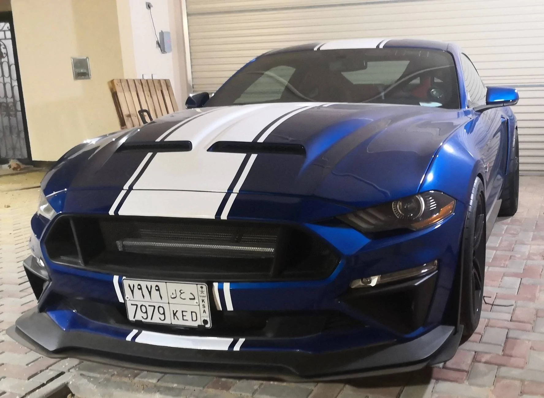

I did my own version add on's ! Basically added Ikon FS with the GT500 winglets on the sides with the factory ( Roush ) full lip.
