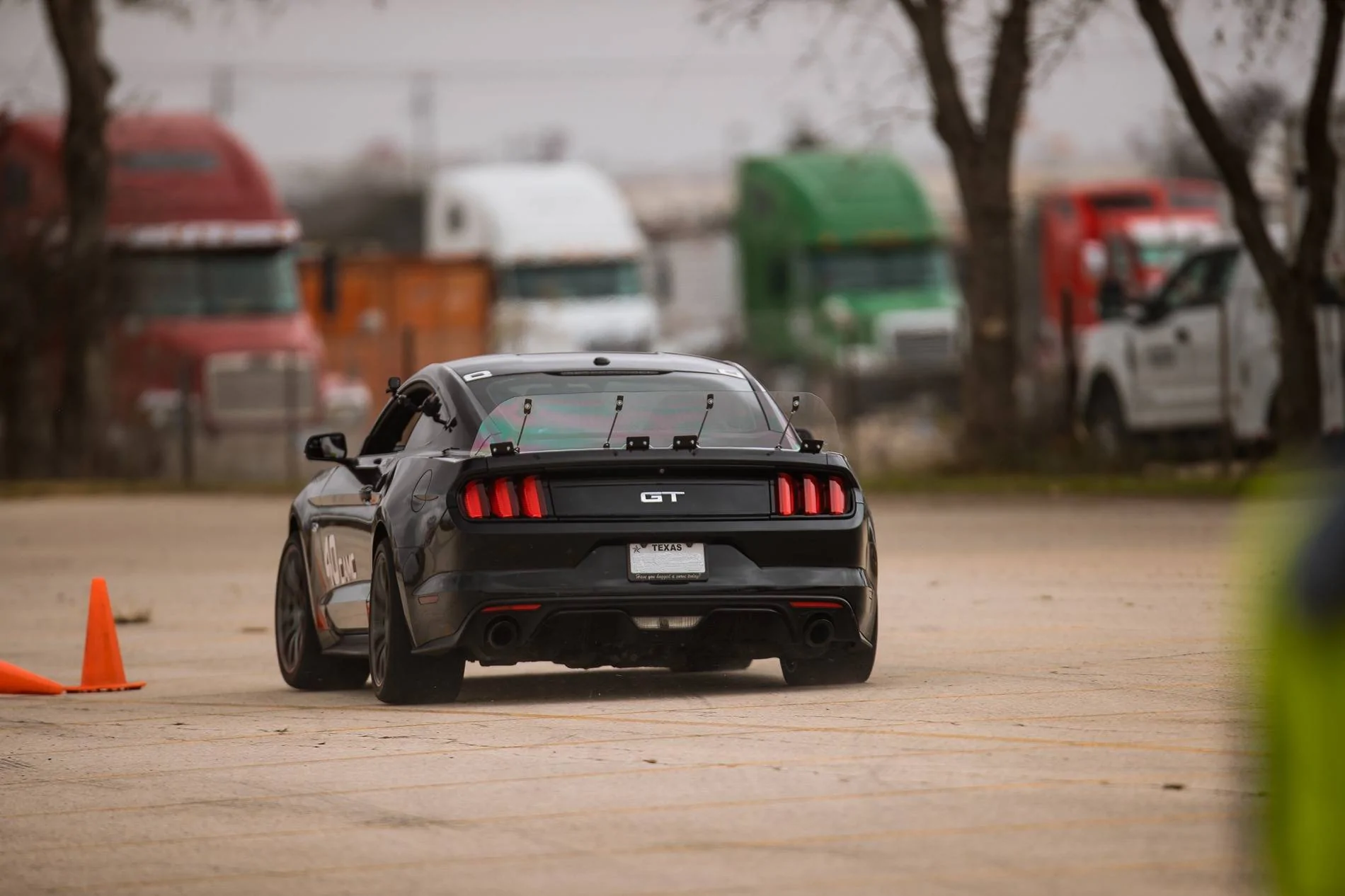

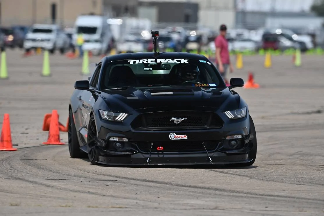

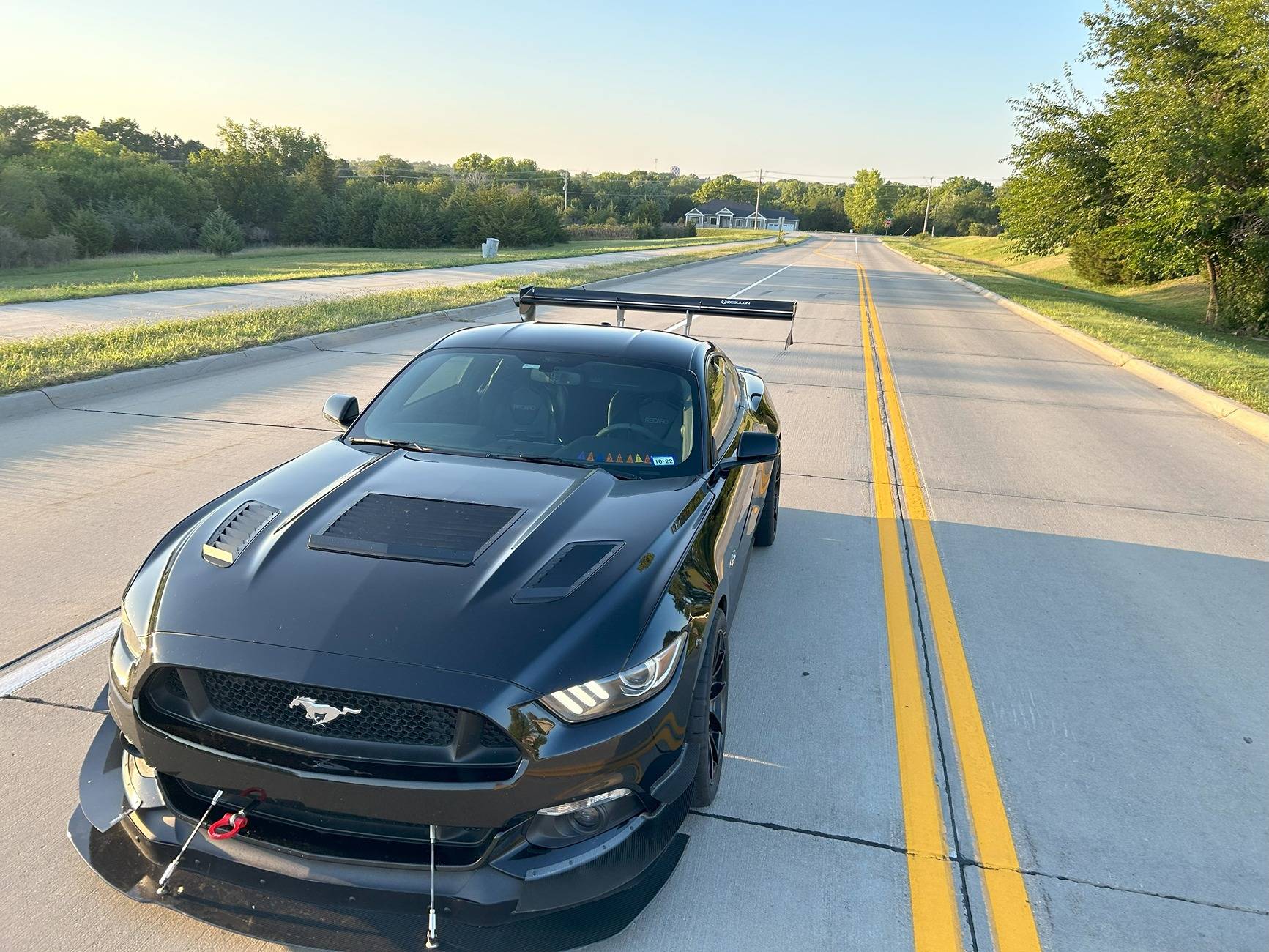

I've actually built and tested a number of aero setups. I've done three different front splitter/aero setups and three different rear aero setups. I currently run a big wing and a big splitter. I test those setups on tracks and at autocrosses. So I have opinions based on how those different setups actually drive.
The reason I'm going against the common-sense grain here, is because 1) a mild rear-biased setup (like the FP spoiler w/ gurney flat) tends to feel pretty great at speed all by itself, and 2) the amount of aero downforce you get from a splitter is marginal compared to what you can get from the rear spoiler or wing anyway. They're far from equal, and they don't ever really balance out as the speeds go up, nor do you need them to.
First, you need to be going pretty fast to feel any aero changes. Below 60 you need a monster wing, spoiler or splitter to feel anything at all.
Up above 80 or 100 mph your Ford spoiler is probably doing enough to feel, but at those speeds on a track or on the street, you generally want the car to be biased to understeer for stability anyway.
The best advice is your own experience and what your car is telling you. Try it with just the spoiler+gurney flap and see if you can tell if the handling needs adjusting. It may be fine.
