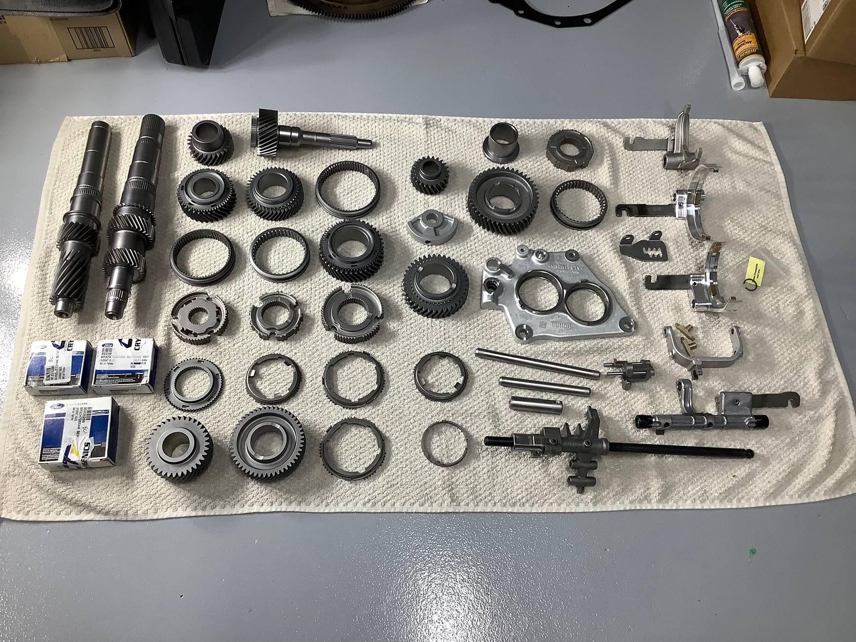

I've searched quite a bit. I can only find a company called AMP and another called Allstate Gears. AMP seems to be the only one that shows an upgrade on their parts being stronger than stock. A couple other places sell gears, but they appear to be a reseller for AMP.
Does anyone know of other options? I'm starting a rebuild on a broken 2016 MT82 I picked up. Going with Synchrotech for the synchronizers and shift pads. Figured since I'm in there I might as well upgrade the gears. Considering having them REM polished as well.
Thanks in advance!

The only thing I know of for Gen. 1/2 is, you can buy a 26 spline input shaft. In addition, you can weld the shift forks for durability. Once you’ve welded the forks, you can send all of your hard parts (including bearings) in to get cryogenically treated and WPC treated (blasted with a proprietary powder believed to be ceramic powder at a very high velocity to make them as strong as possible). I tried asking Calimer to buy one of his billet gear sets when I built my MT82-D4, but he wouldn’t sell them unless he does the build.
You’re also on the right track for synchros and adding bronze shift forks pads.

When I sent all of my hard parts in to get treated by CTP, I remember Ben telling me it was the same cost for everything. My build thread has the pricing listed for the Cryo and WPC processes. Here’s a pic of all the parts I sent in.
Thanks for this info. I have already read your build thread and took notes! :) With this build, I'm mainly looking for smoother shifts. I'm not planning to boost the car. For me, 400HP is plenty.
You should be just fine with a synchro upgrade, welded forks, bronze shift fork pads and new bearings to strengthen things up just a bit.
