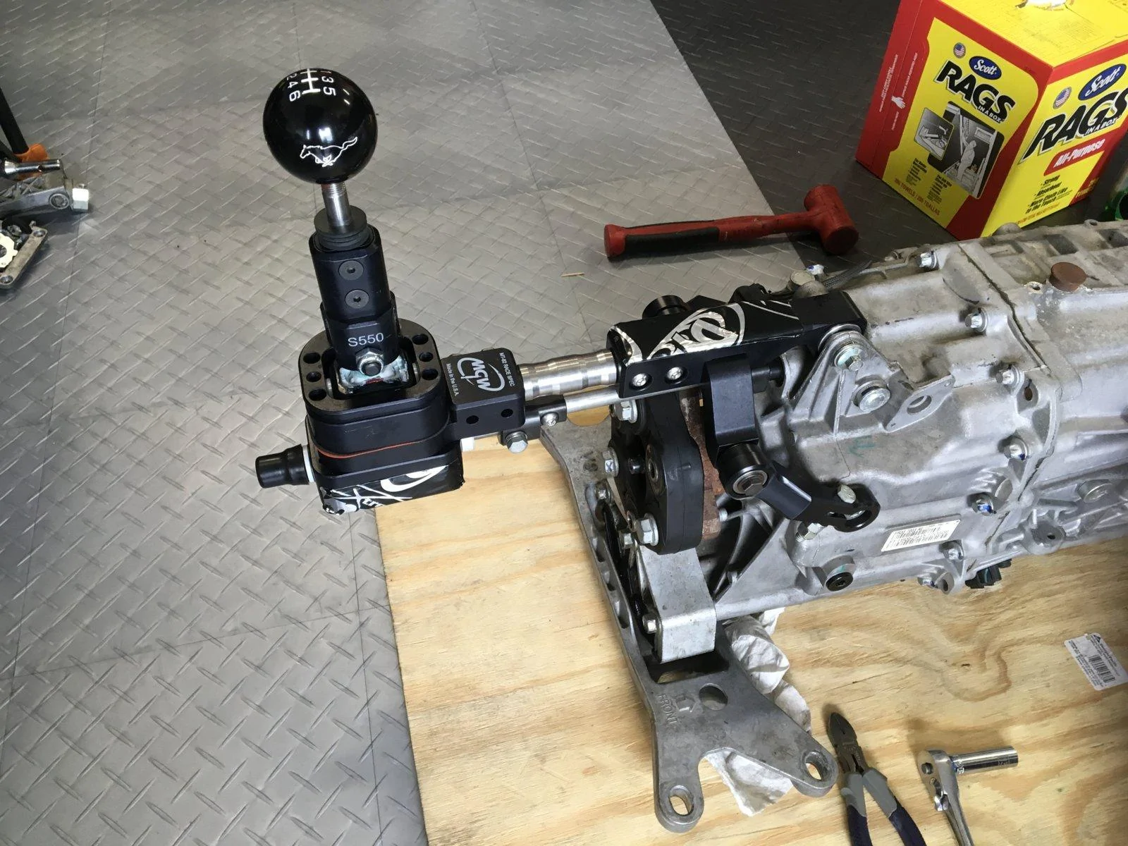

UPDATE: new throwout bearing solved the squeaking issue, also installed the MGW while it was easy to get to. Not sure if the throwout bearing or the shifter solved my 1st gear issue or combo of both but I’m satisfied. Also glad I replaced the clutch and flywheel
