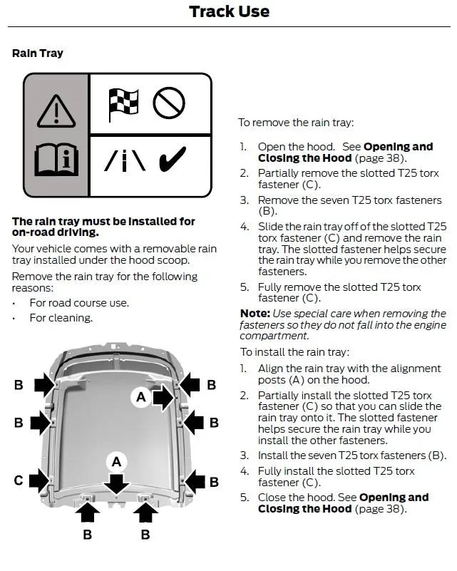

Can someone explain why'd you want to remove the rain tray? Does it look better? Improve performance?

Would removing it reduce under hood temps?
