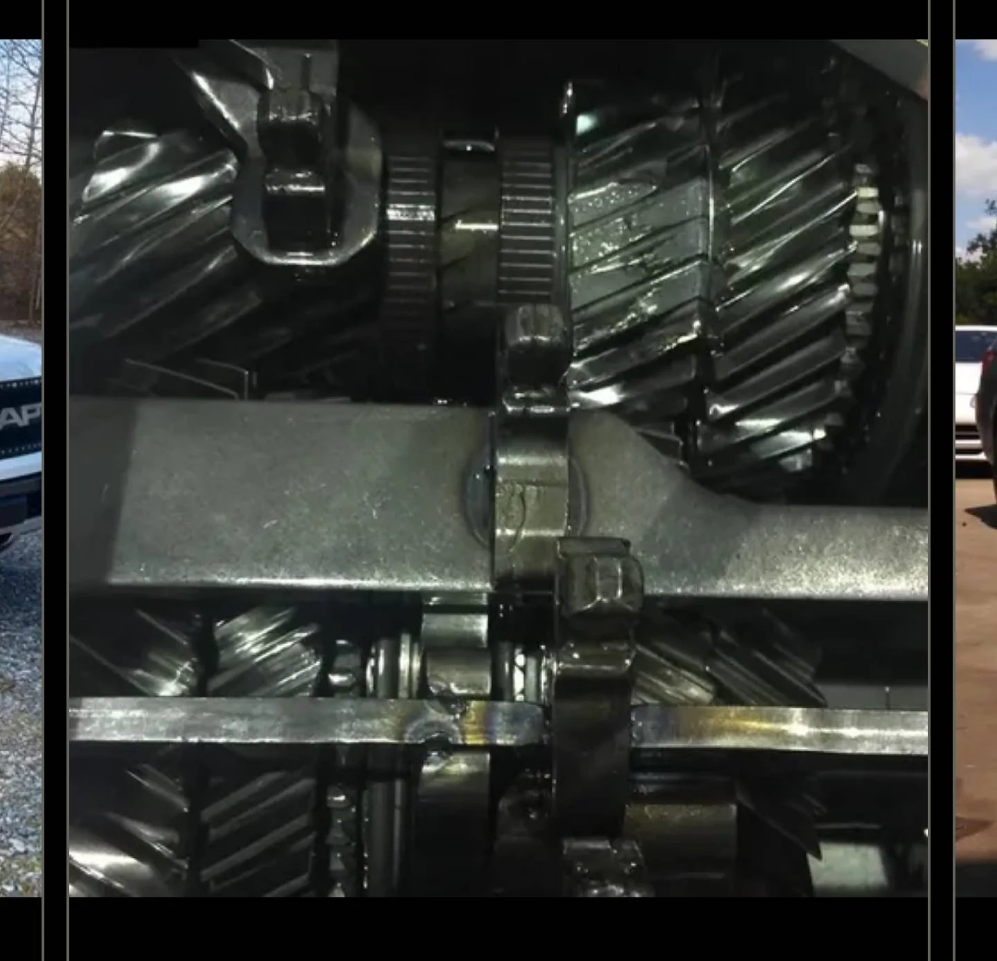

Ill post pics if i can find them, when it shifts 1st to 2nd, it will shear the teeth on both gear sets, and then the teeth could affect other parts as well

Torque truncation in the lower gears, yes, I heard that. Regardless, 1st gear isnt typically the one to be concerned about.
Regarding teeth shearing....why am I sensing that any photos you have are not of the DCT in the GT500?

Obviously not going to be from the tremec , yet lol. But every dcts 1st failure point from more power, is the clutches, once clutches are put in that can take more power and clamping force, the next failure point is always 1 and 2 gear. Bmw, Porsche, gtr, always
