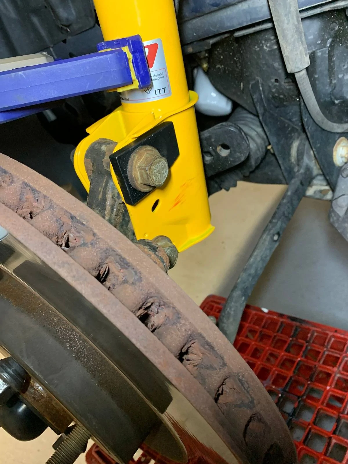

Call Steeda and confirm the warranty on their adjustable shocks. I have personally tore mounting tabs off the Konis causing degas/oil leak and warranty was fast and painless. I have since reenforced the replacements with a thick piece of steel:
Footnote: Bilesteins are considered the bomb-proof alternative. Knowing everything I know now, I would go with that. Swaybars, tire pressure, and alignment are a much better tuning tools than Koni knobs.
