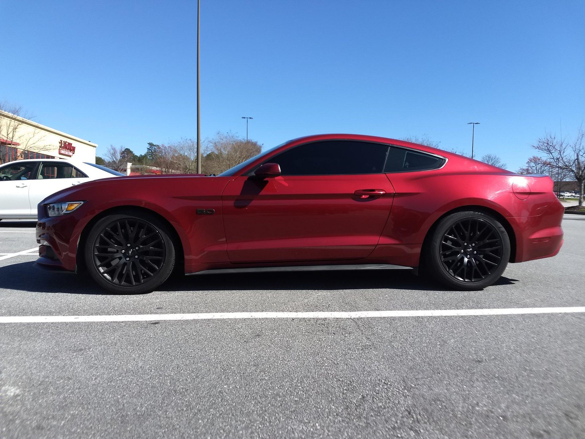

Update for those who might be interested, I purchased the vogtland sport lowering springs and koni adjustables. Only been on for a couple days, but my initial impression is that the car is less bouncy, and stays flatter during cornering, breaking and acceleration. It is stiffer than the pp set up for sure but it isn't a harsh ride; a long drive is still very comfortable.

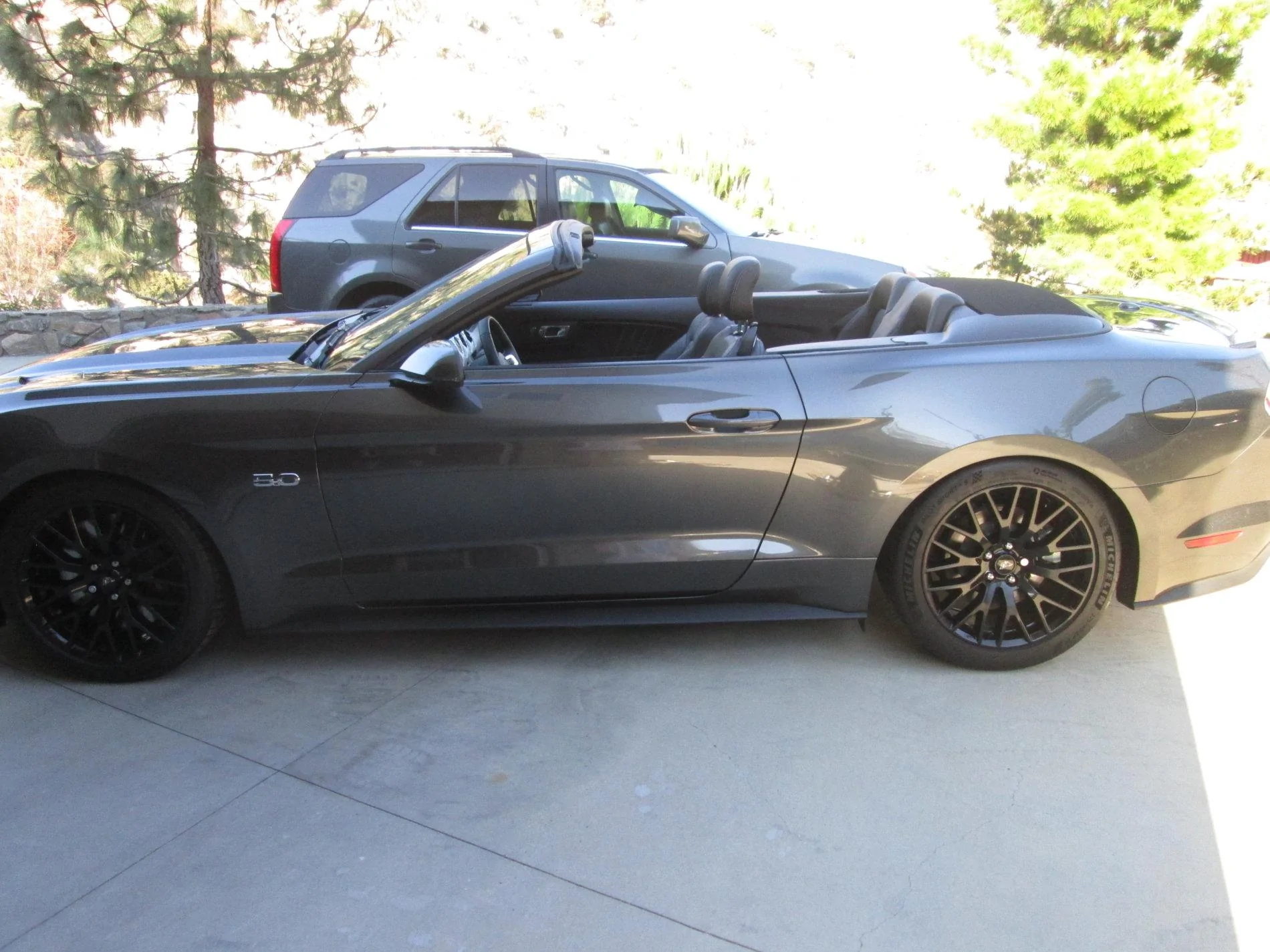

We did Yellow Koni adjustables W/ Ford Racing springs, Brembos, Eibach F and R sway bars. The perfect pkg.
