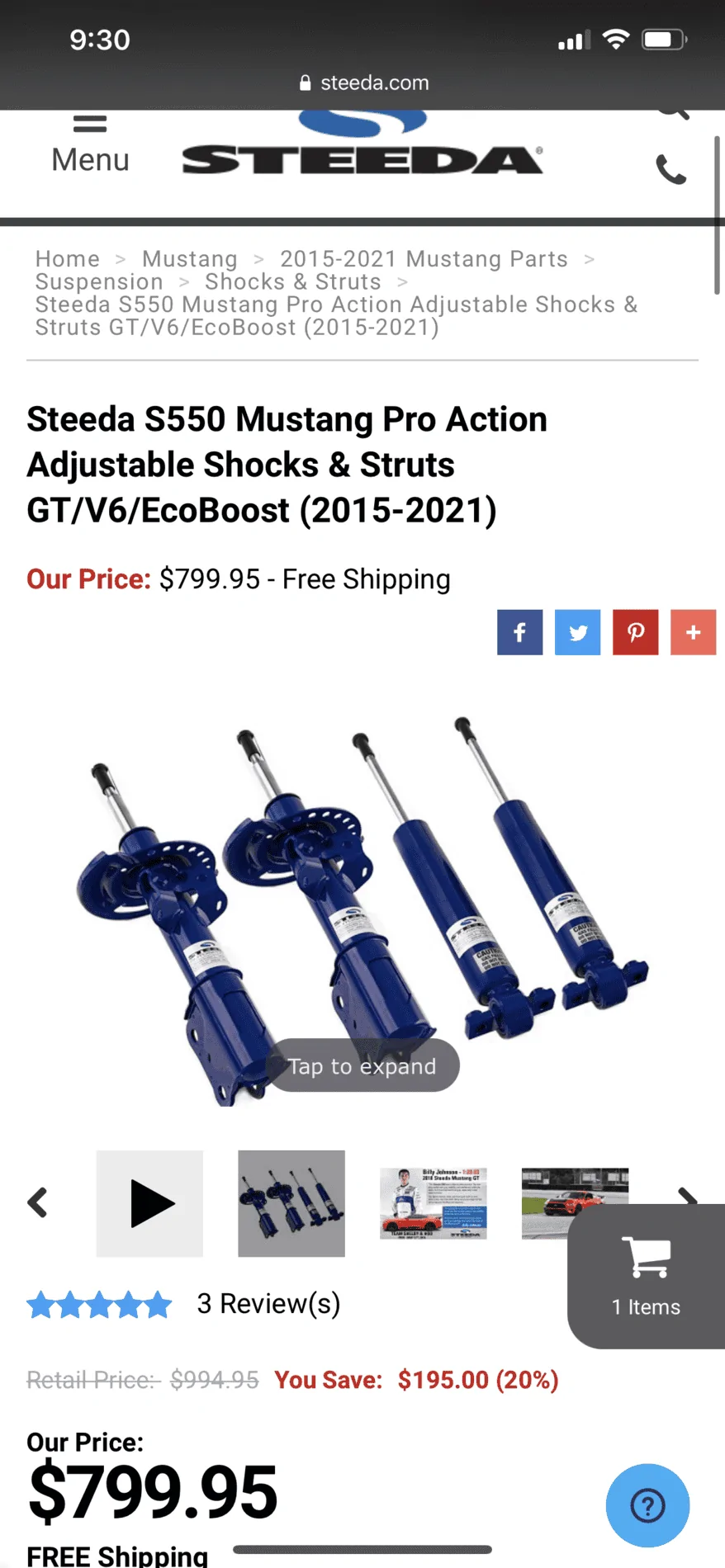

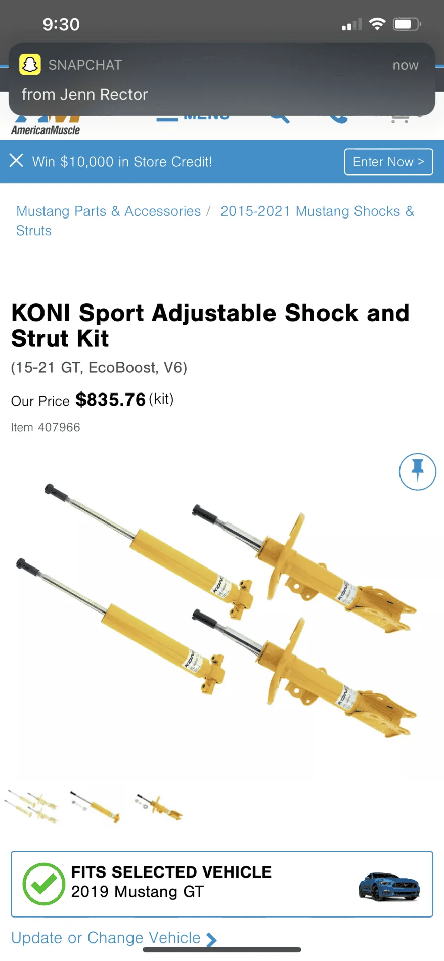

Anyone ever had both? I’m guessing the kinks are really great? Yet I’m still considering the steeda adjustables because of the savings in $$..?? How similar are they? Or are koni yellows just the best you can get? From the looks of reviews everyone that bought the koni couldn’t say anything bad about them??

You do know the Steeda's are made by Koni?

well they are made by the same contract manufacturer that makes Koni's. The Steeda valving is different from Koni's. The Koni's are universally panned as poor/bad.

not universally, no. They ride better than the factory PP shocks, and the adjustability is useful if you actually use it.

I think Steeda does some in house. Call them ask for Mike, tell him your springs and mods. Tell him what you want out of the car.
Or PM @SteedaTech here

I have always run the koni shocks. I tried bilsteins in the past to stiff. I have never had any problems with the koni shocks. I was going to put the steeda shocks in but they had told me that only there springs would work. Back to the konis. The adjustment was put on the konis to adjust for wear so as the shock wears you can adjust it for the like new feel again. Its the track people that crank them down. I think both the konis and steeda shocks are a great choice its a personal thing on which one to go with

Steeda ones every single time! They are made specifically for our car, and Steeda focuses on Ford. Konis are made for a variety of different brands.
Use Moniker10 if you want for them to get 10%
