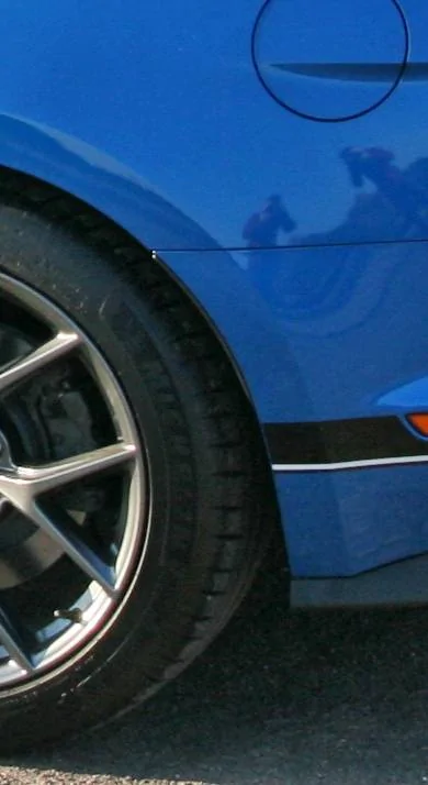

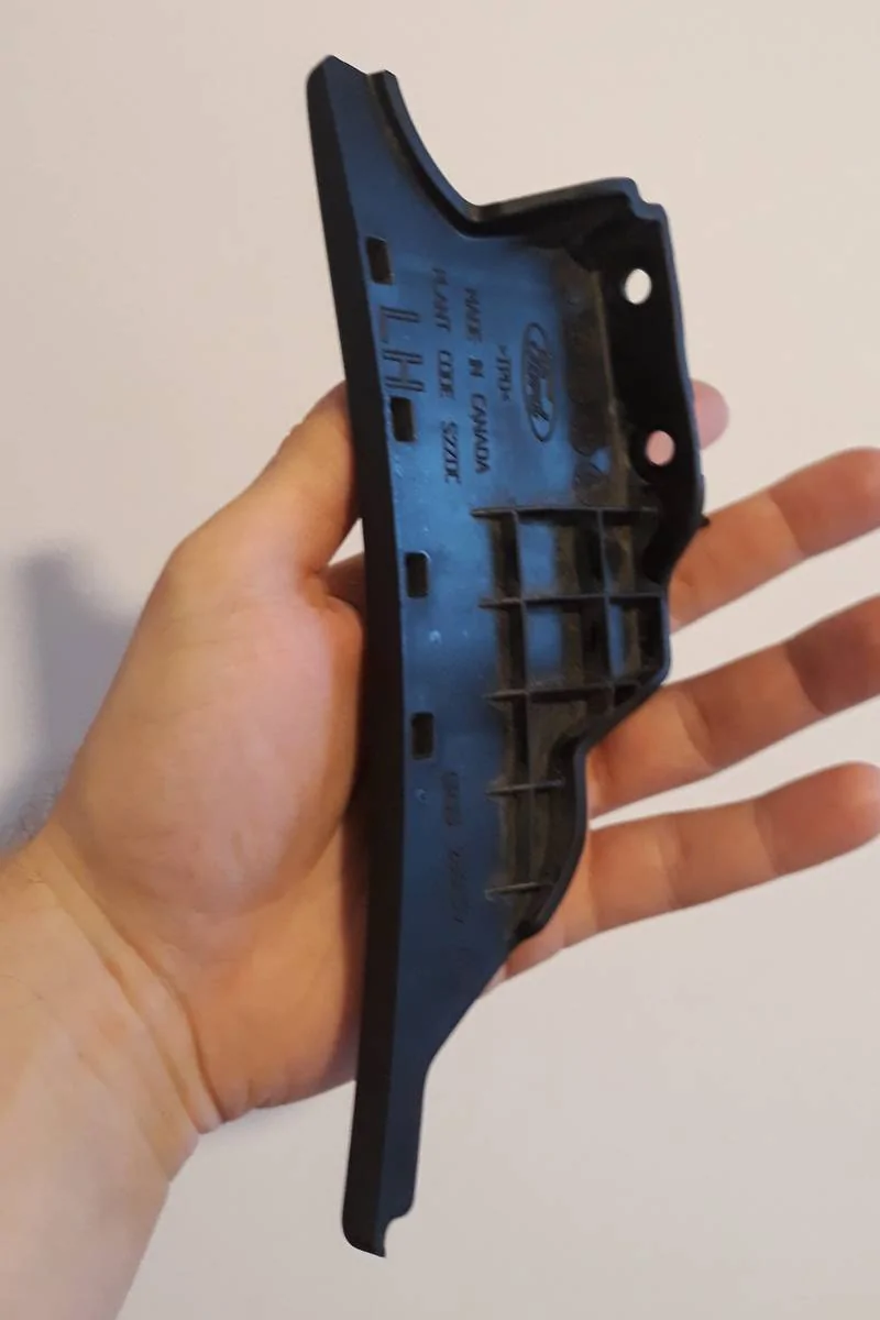

Looks like you guys don't get the small edge protector on the fender behind rear wheels, must be only for export cars. It's held with 2 screws, so with the lower screws I already had 4 screws on the car and didn't need any extra. And only 1 pushpin for the bottom.
This small shield covers the upper half of the edge of the fender on my car. Had to remove it as the new shield replaces it (except for the uppermost 2 cm).
It was a nice day, I cleaned properly all wheel wells, brakes, underchassis, engine and hood from the few rainy days I had in the winter 😁 Now onto applying ceramic on the wheels and calipers and front lip moldings.
huh looks like a tiny version of what goes on the handling package. I wonder what European law requires that.

I doubt it's the law, it's too cosmetic. Looks like edge protector against rocks but only goes half way, weird, I was actually wondering why nobody of you mentioned it 😁 Looking on the promo pics, US cars don't have it, EU cars have it. Btw, this thing was glued in between the two screws and took some force and wiggling to get it off, in case anyone gets stuck with it.
Anyhow, this was a really easy job, most of the time was cleaning everything while I had the wheel down 😁

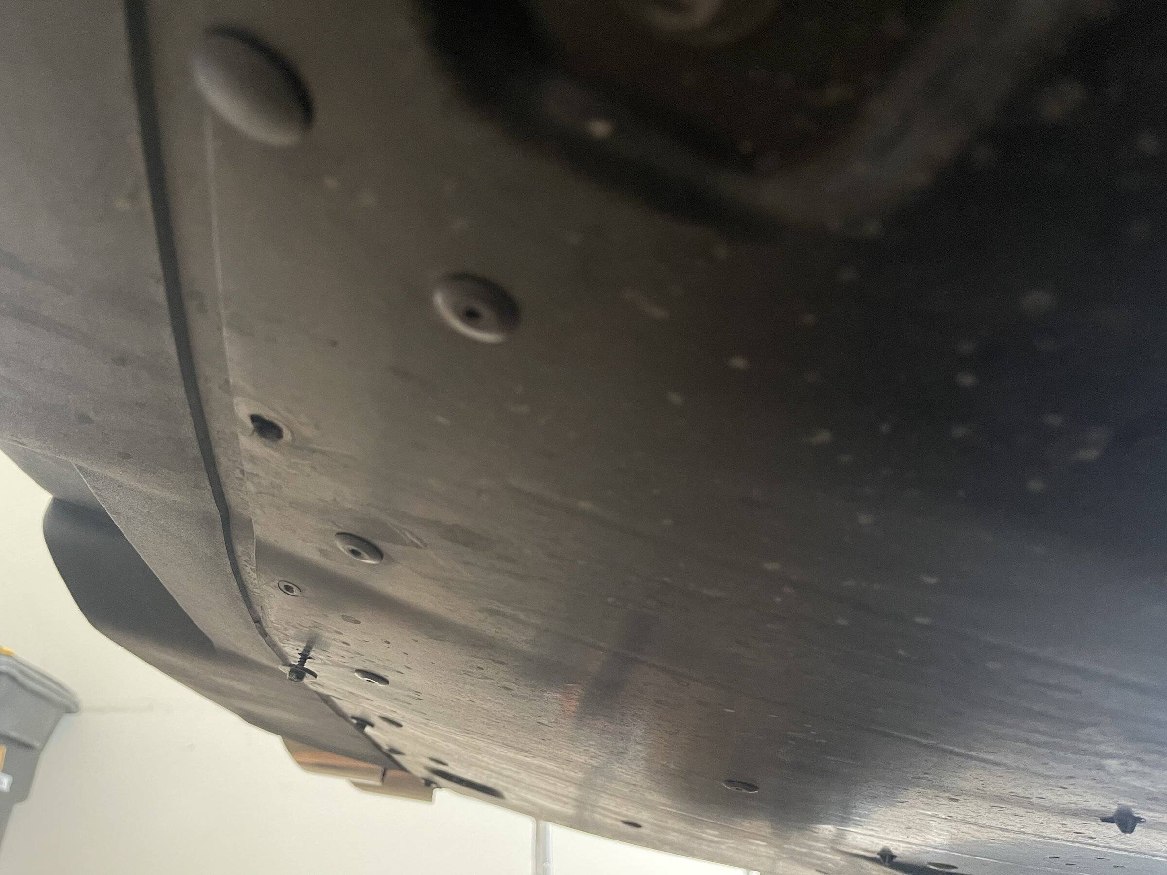

Nice work! Just an "important safety tip" concerning the front splitter: the splitter is not installed at the factory. It's installed at the dealer when the car is prepped. My dealer left it off of my car because they said the life expectancy of the splitter on Connecticut roads is about one day!
I still have it in the original packing material and I've driven the car over 100 miles an hour and it holds the road pretty well.
I haven't taken it on the track yet and when I do, depending on the track, I may or may not put the splitter on. It's not cheap. The last thing you want to do is scrape it up on some stupid road hazard.

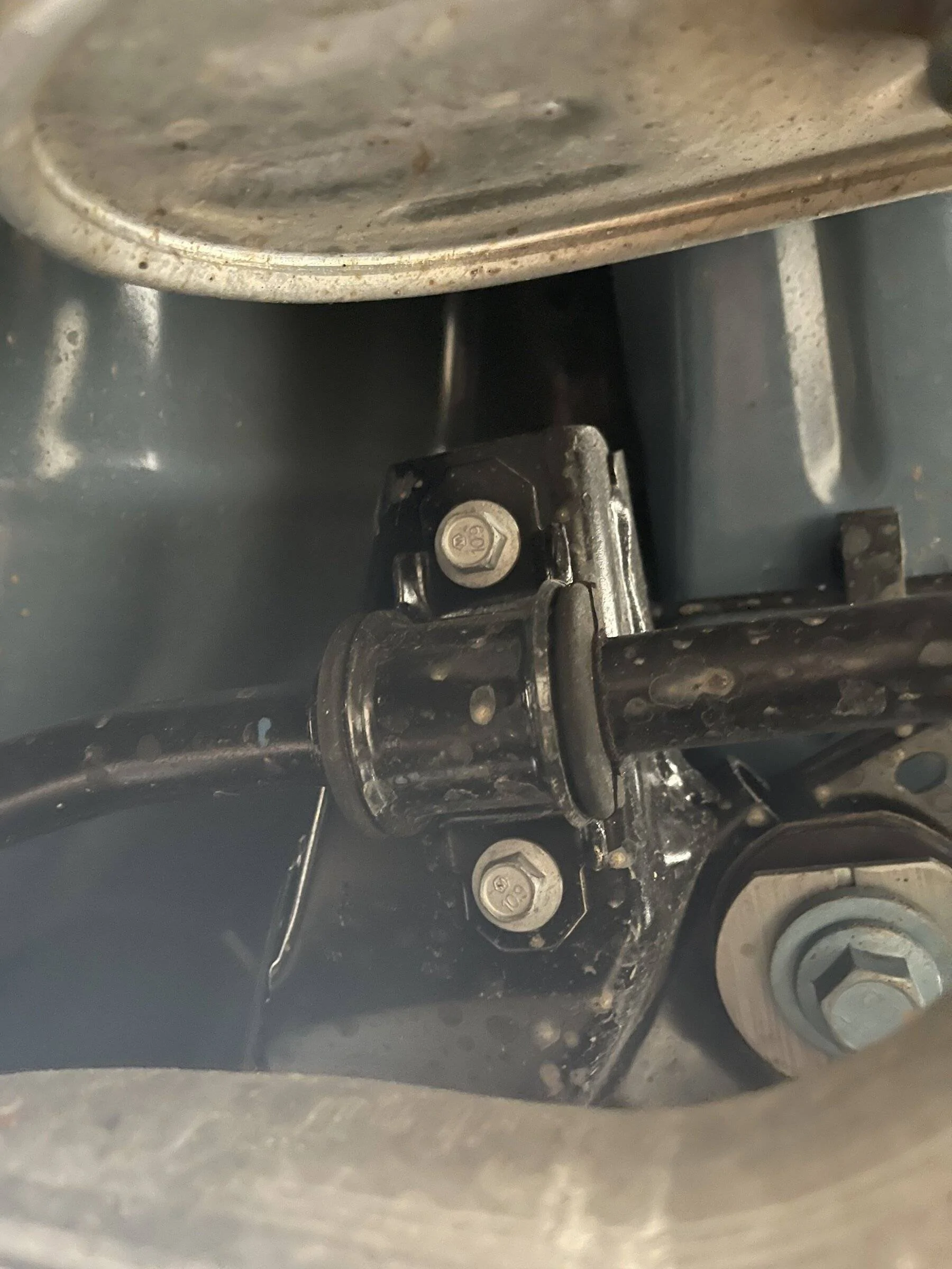

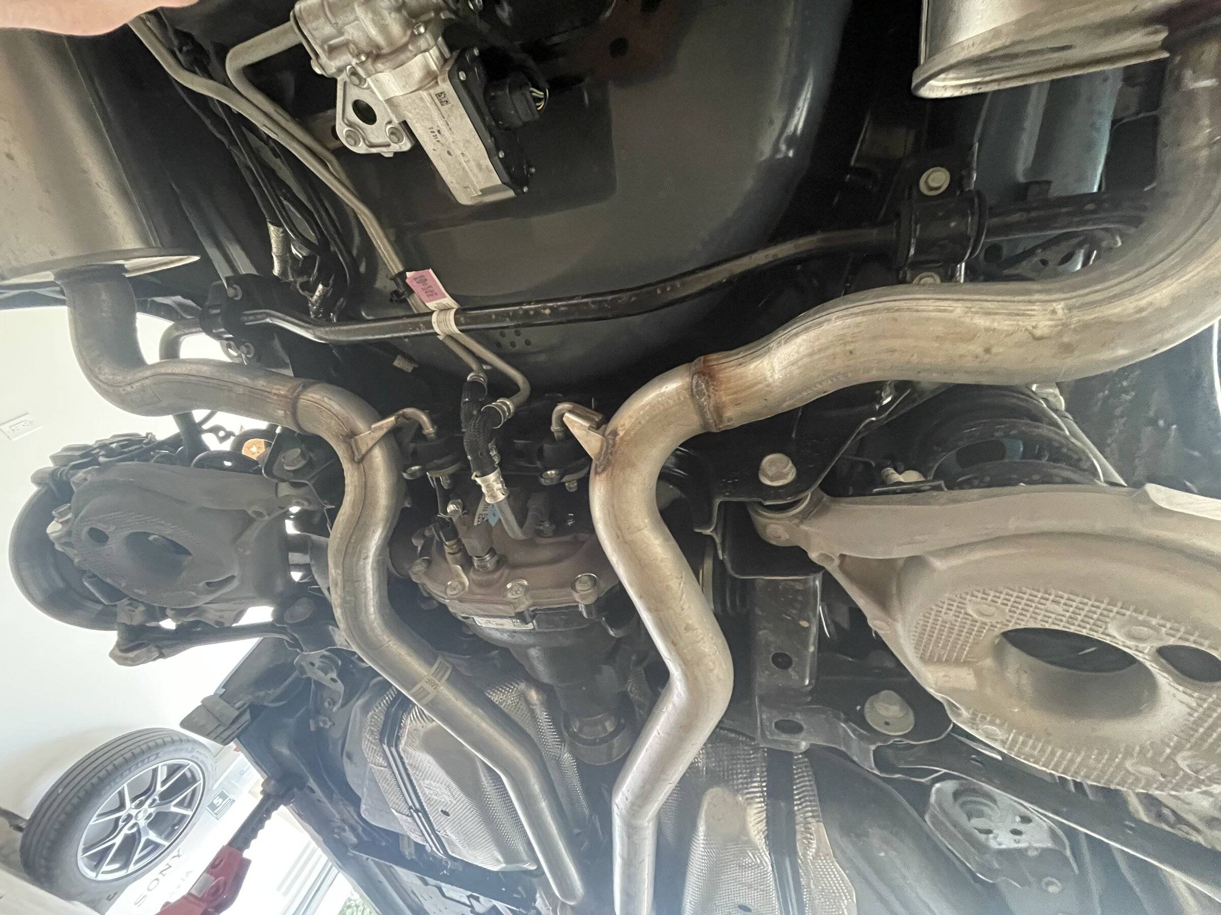

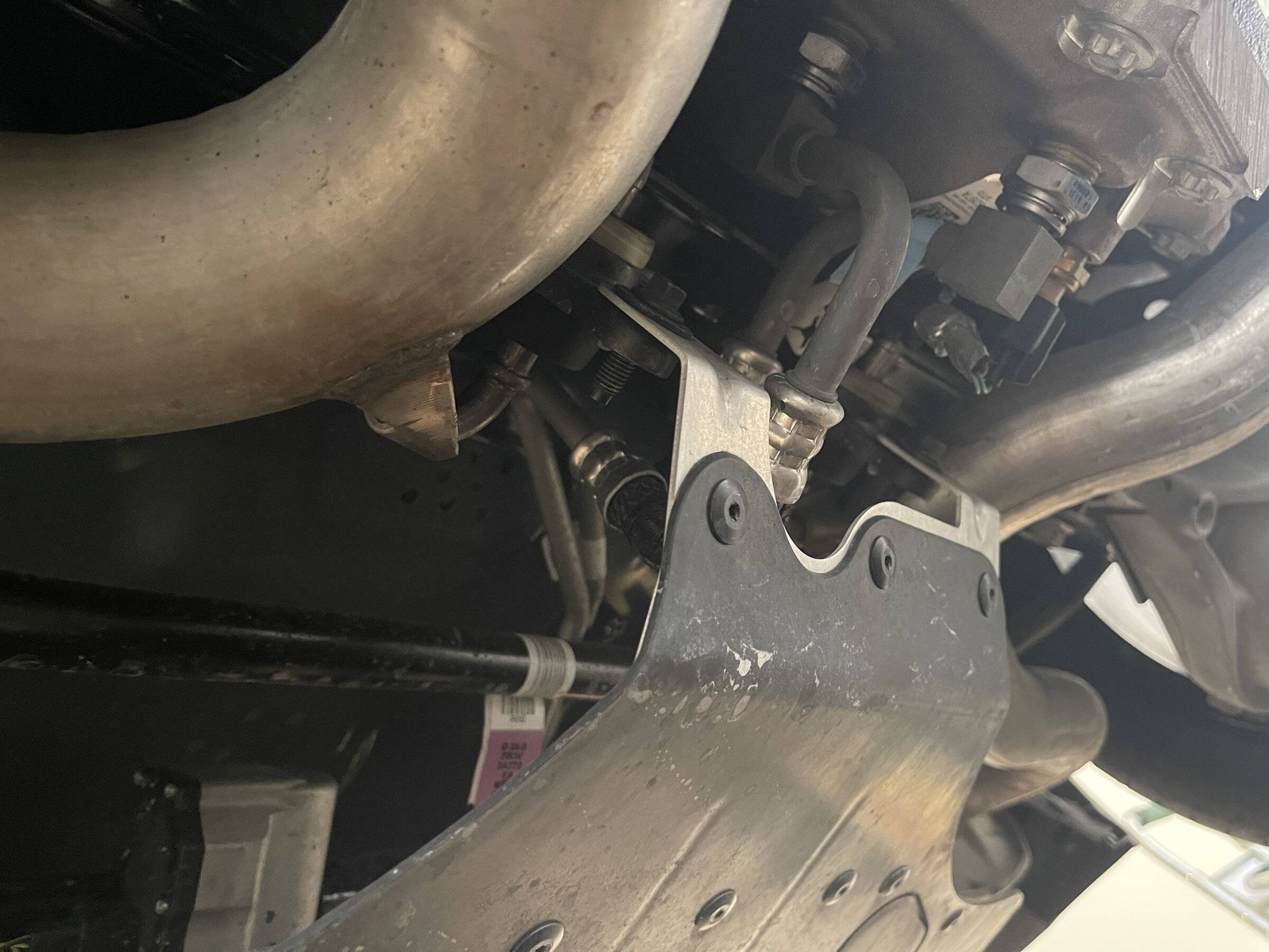

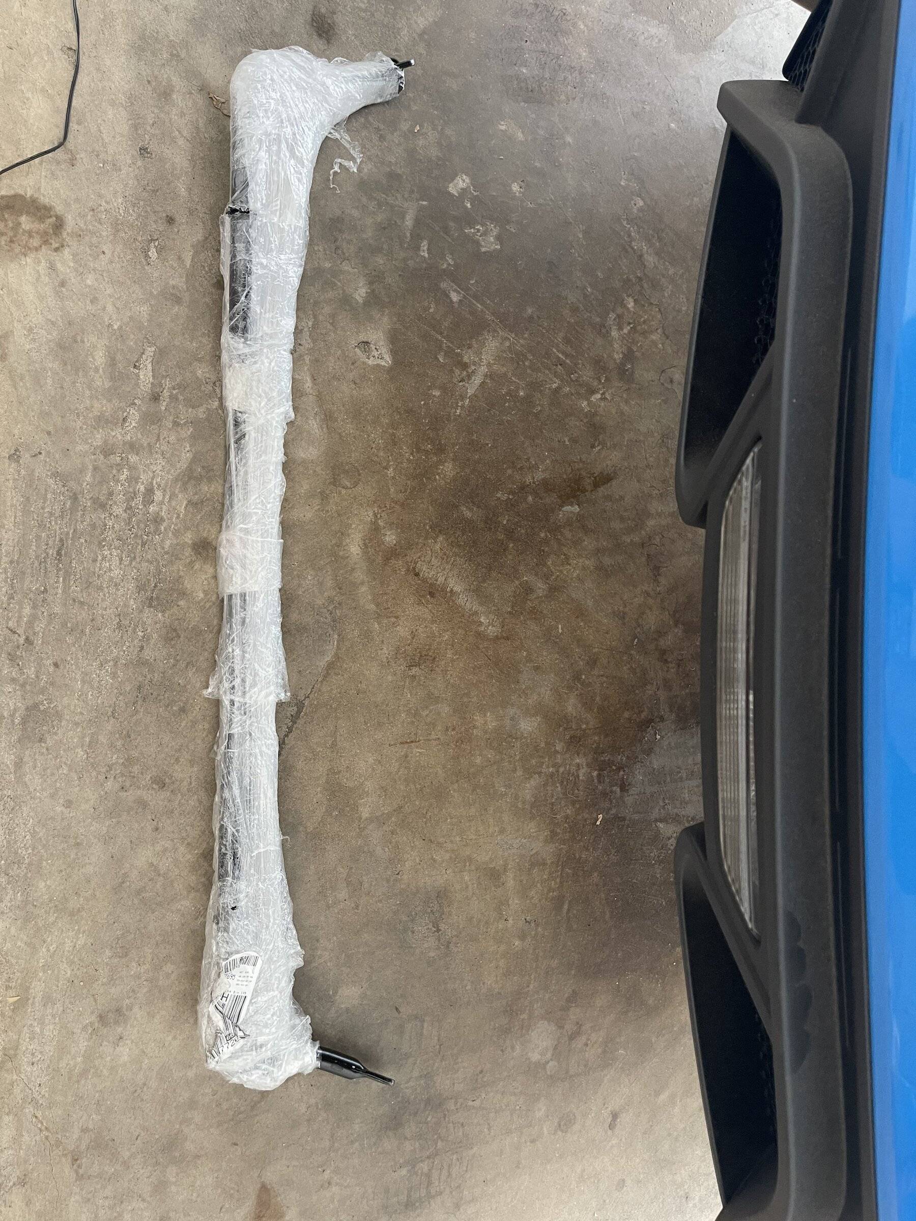

Adding the solid rear sway bar: Mach 1s without the handling package have a hollow sway bar. This is guide to a very easy swap to the solid HP sway bar. This is Ford PN: JR3Z-5A772-A and looks nearly identical besides being much heavier.
Yes it shipped like that loose in saran Wrap but hey, $70 was a deal I couldn’t pass up.

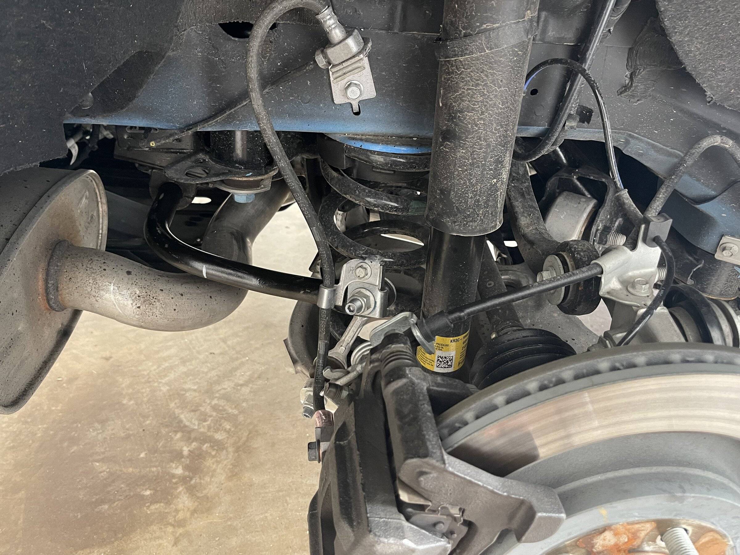

First you need to jack up the rear end, take the rear wheels off, and break out your full metric socket set. Sadly I didn't take notes of which ones to use but just assume 6mm - 18mm going forward. I started by removing the differential cooler air duct which, as others have noted, collects a lot of rocks. this is held on by 5 screws and 2 bolts between the exhaust tips and two bolts near the differential.
I recommend dropping this once a year or two if this is your daily and cleaning it out.
Next I removed the bushing brackets and carefully noted their side and orientation.
This is very important as the bolts didn’t seem to fit right if the bracket was backwards. Its hard to tell but the front and rear tabs are different thicknesses and It feels like these bolts are tapered. If done wrong, you may have a gap where your bushing bracket will be loose.

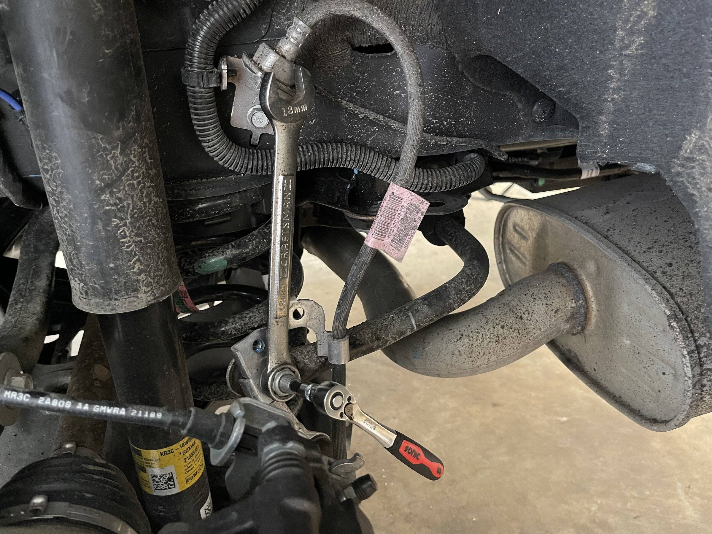

Letting this rest free on the exhaust I focused on removing the sway bar from their end links. First remove the bolt holding the brake line to the bracket allowing easier access to the end link bolt. An Allen key socket and wrench will be handy in getting the bolt loose As shown.
Once it breaks loose its still a little bit of a pain to work the nylon lock off. Once the nut is off, I'd note the brake line bracket orientation as well which is loose from the sway bar. It wont fit another way nor on the other side but this note is just to save the time of trial and error.
installing the new sway bar I did the above instructions backwards: I greased the sway bar bushings (brake grease), installed them on the new sway bar, and after maneuvering it into place, I bolted them to the underside of the frame. Again, note the bracket orientation is very important.

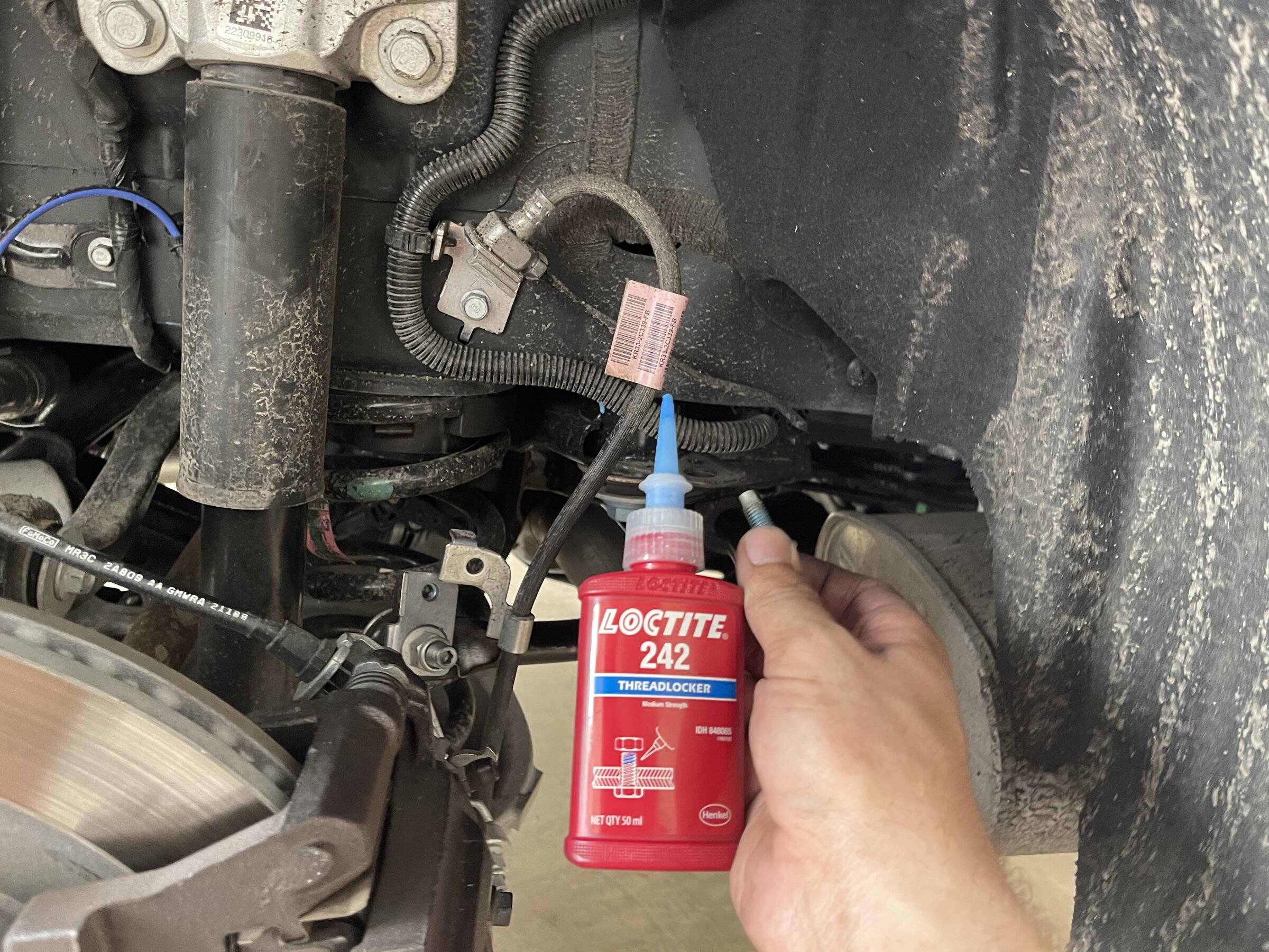

I also used loctite EVERYWHERE but I recommend at least reapplying it wherever Ford had it from the factory. I'd recommend the industrial size container from amazon if you want to follow my route:
Overall this an easy swap that can be done separate from the springs and camber plates. Total time should be a little over an hour and a half but took me 3 hours just making sure everything was done right and everything was cleaned (photos taken before I did this last part).
Out driving, the rear end feels a little stiffer but its really not that big of a drop in ride quality. Over bumps the rear end definitely moves a little more than before. What I did notice is taking off in a turn feels a LOT more controlled and stable than the hollow bar and noticeably less wheel hop. Even if your not adding the handling package, I'd recommend swapping this out just to add a litter more traction at the cost of ride quality (lets all be honest, you didn't buy a Mach 1 to feel the ride quality 😂 )
