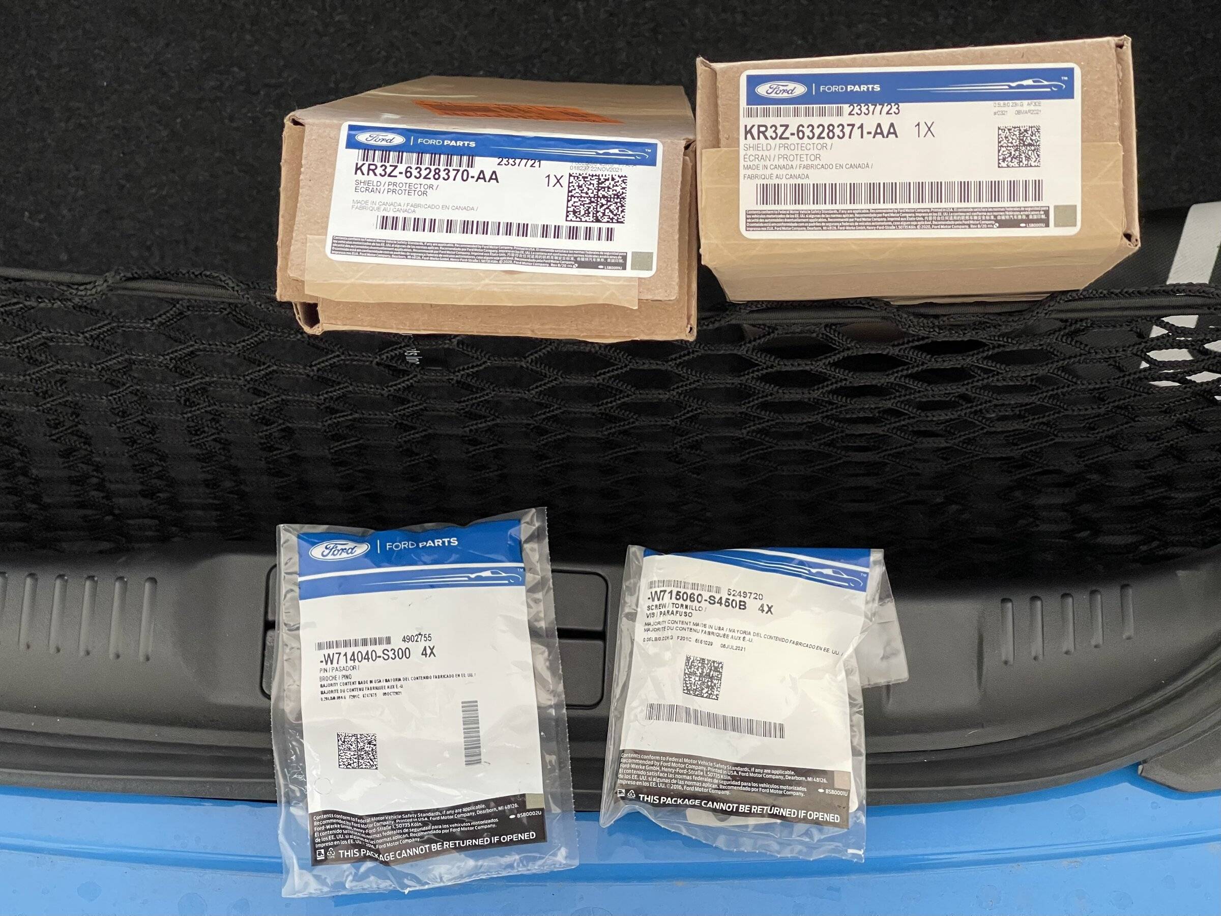

rear tire spats/rock guards/fender deflectors:
  • Rock guard right
    • KR3Z-6328370-AA
    • $52.97
  • Rock guard left
    • KR3Z-6328371-AA
    • $52.97

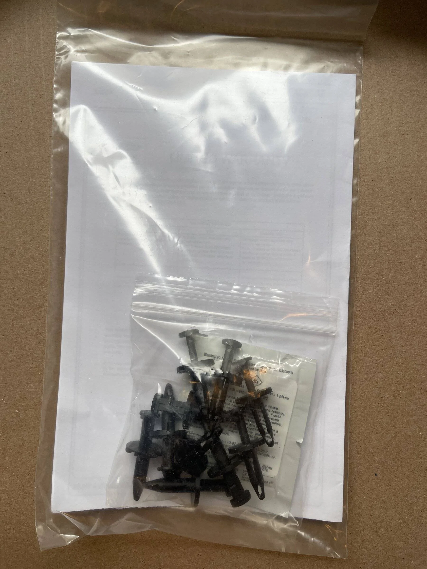

  • Plastic rivets
    • Told to order 4 (used 6)
    • W714040-S300
    • $3.48
  • screws with washer
    • Told to order 4 (used 0)
    • W715060-S450B
    • $6.95

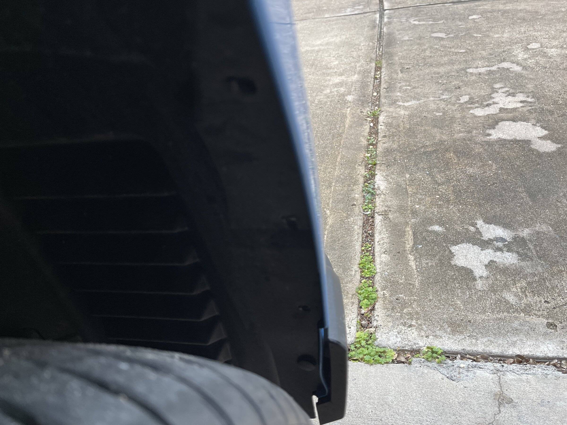

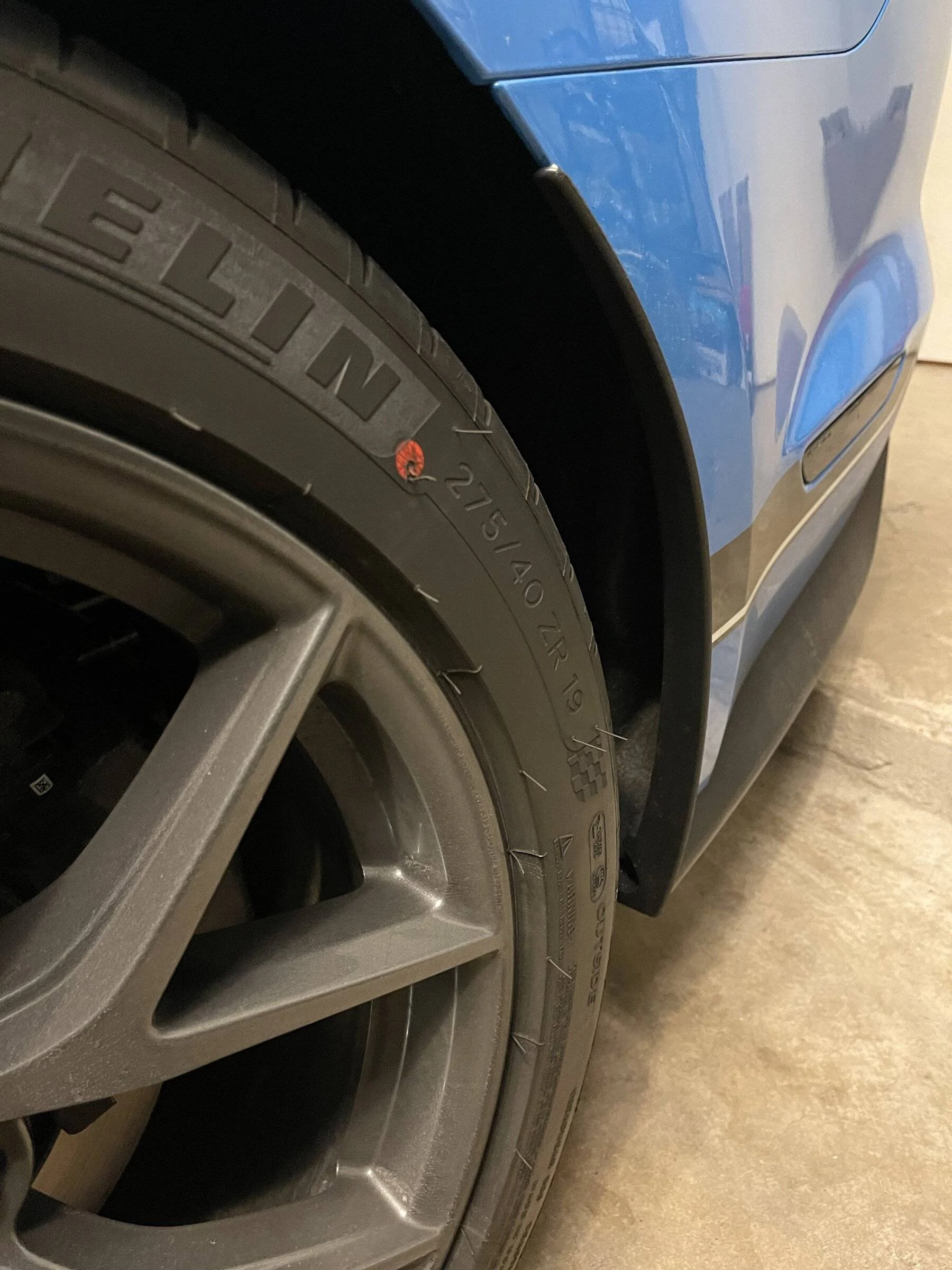

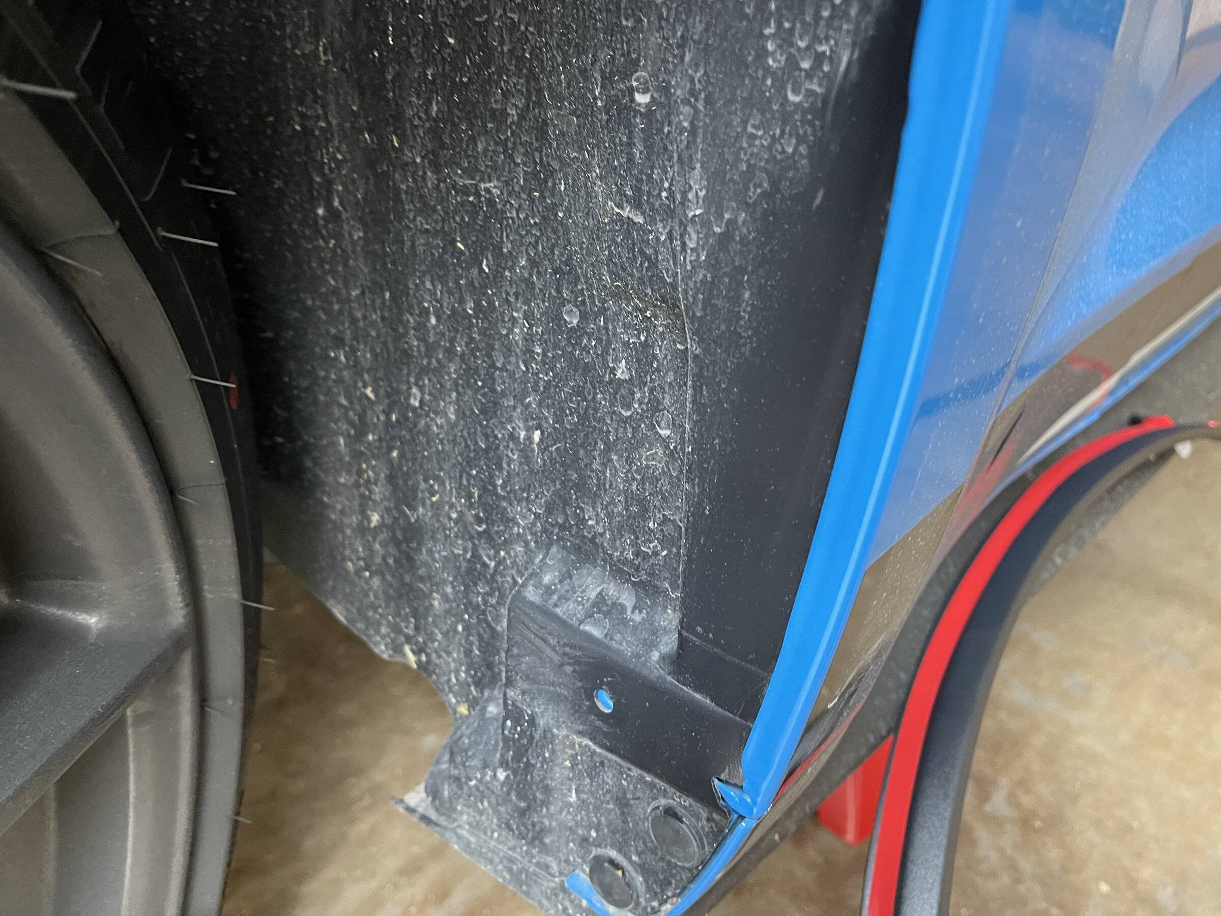

So there are two approaches to this:
  1. Jack up the rear of the car to create a large enough gap
  2. Jack up and remove the rear tires to access the rear wheel well area

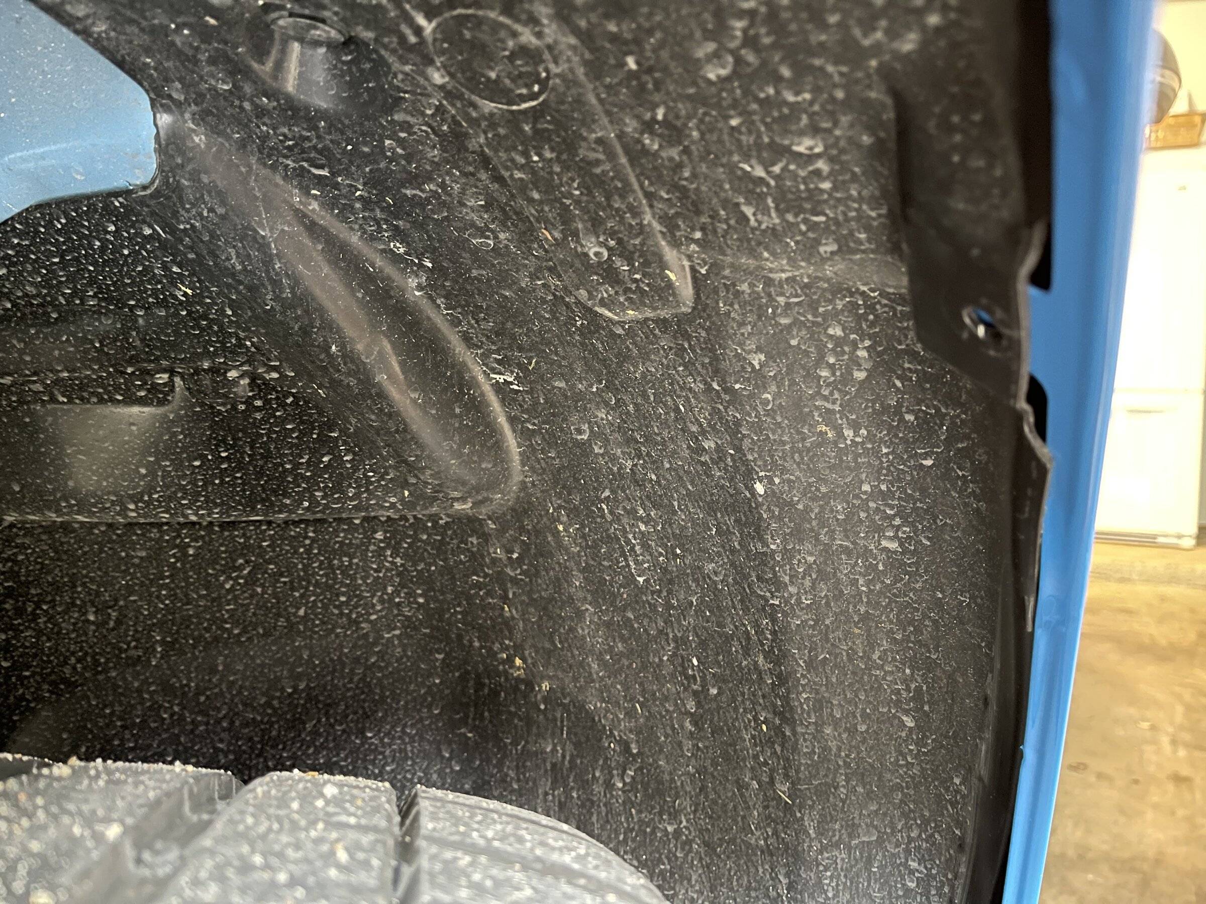

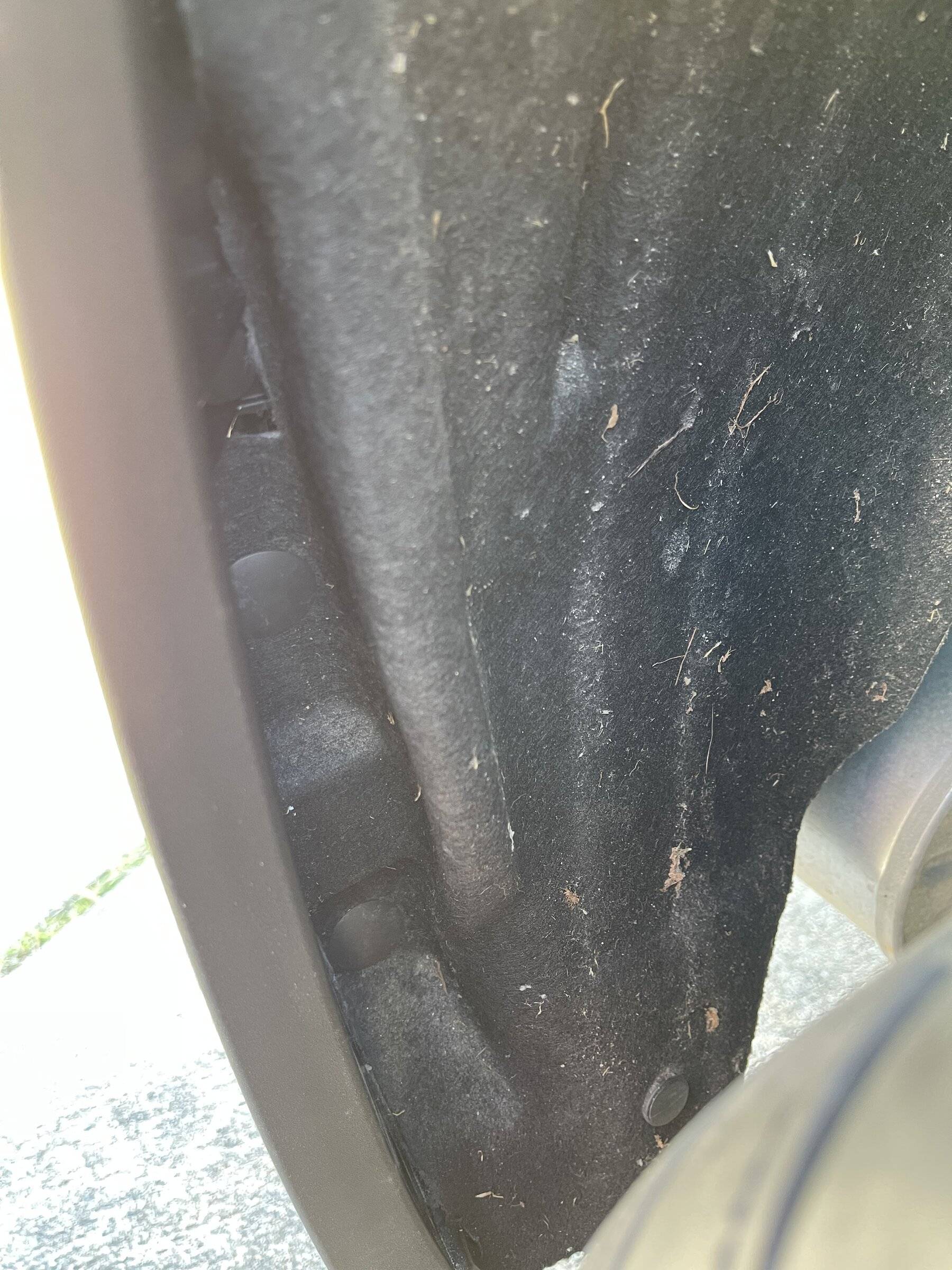

you may be able to not do either if you have tiny hands. Once this is done you’ll see this:

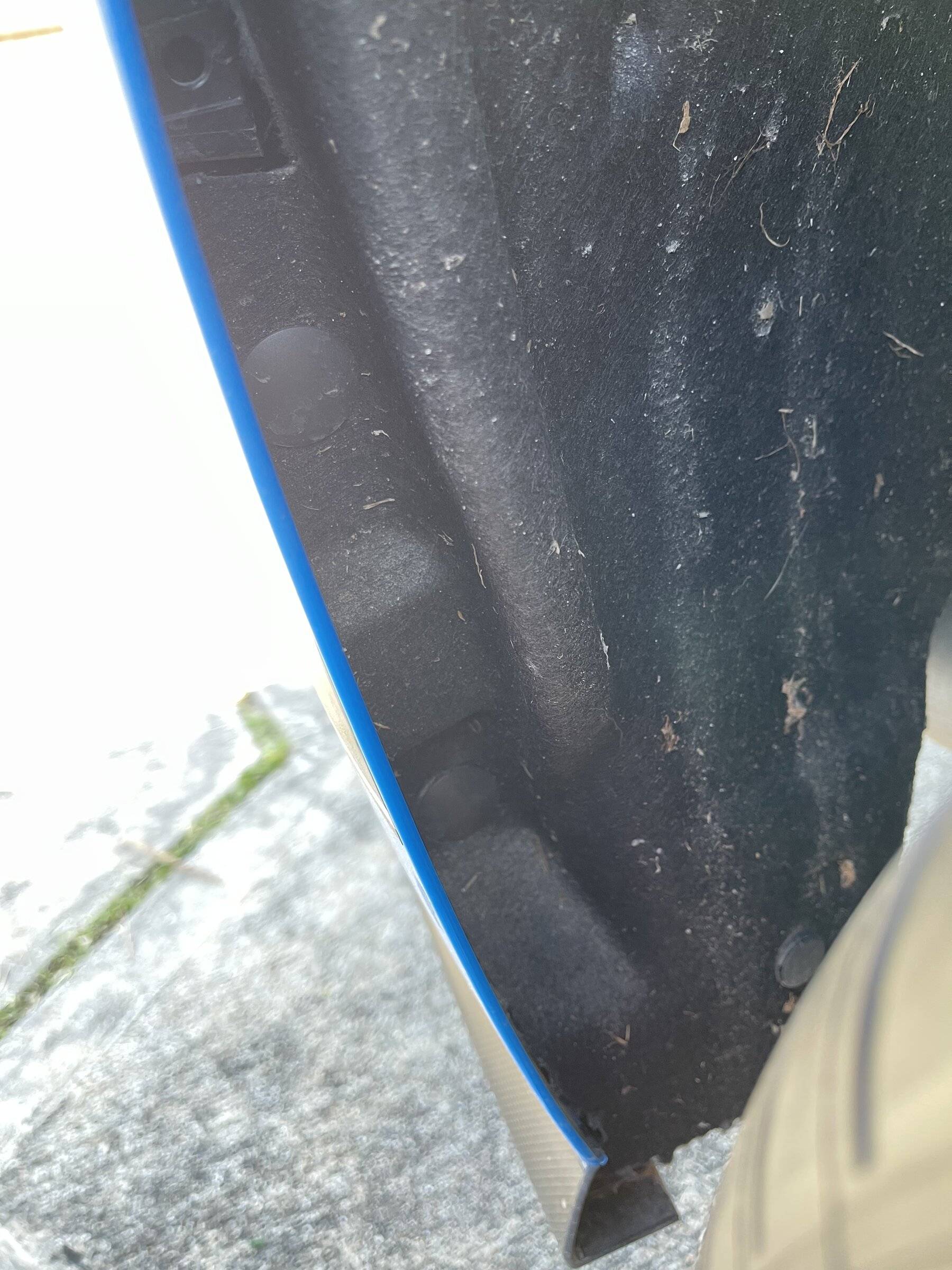

Two plastic rivets hold the well liner down (a third to the right if you need more working room). If you have an upholstery tool these are easy and if not I’d recommend the largest flathead you have. They are big ones:

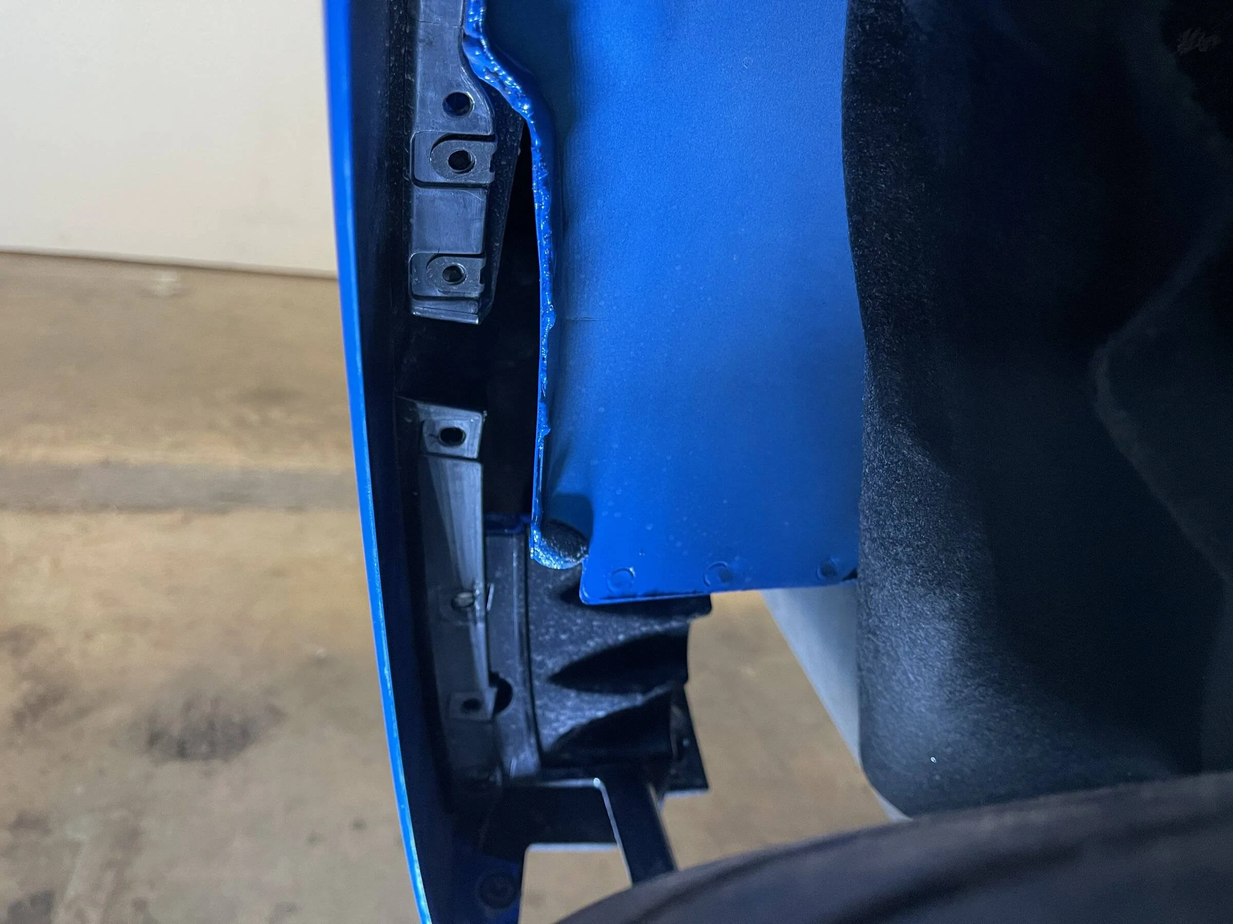

after this pull the well liner back and you’ll see the two screws you need to remove. I was told to order 4 of these but were never needed.
After removing these Screws, fit The rock guard into position and make sure the upper plastic pin doesn't miss the top mounting hole. you can hand turn the screws in and I added two plastic rivets to the two holes below the mounting pin. These fit a 7mm metric socket. There is a third mounting hole at the very bottom I used a third plastic rivet for as well.
The top two holes look like they could have screw clips but since the well liner didn’t cover them, I felt a plastic rivet would handle the dirt and debris better. I added the original two plastic rivets back in securing the well liner.

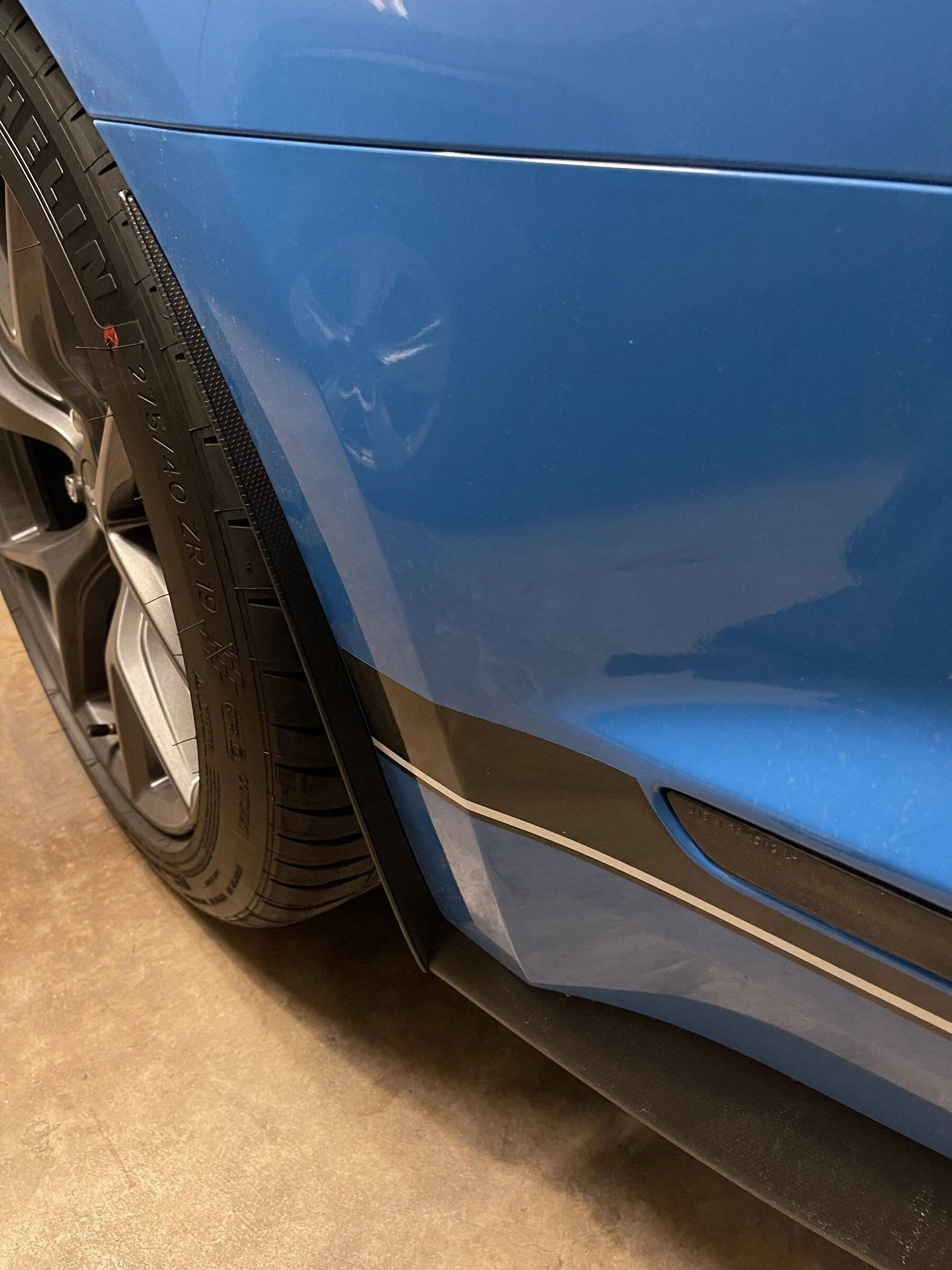

Overall it took under an hour and looks great! The plastic pins hold it better than I thought and the guard material matches the rear diffuser.
Update: I ended up adding the two screws at the top of the guard. This was just to exactly match the handling package.
honestly I think the plastic clips would have held just as tightly. These clips are a pain to add for someone with big fingers and requires patience.

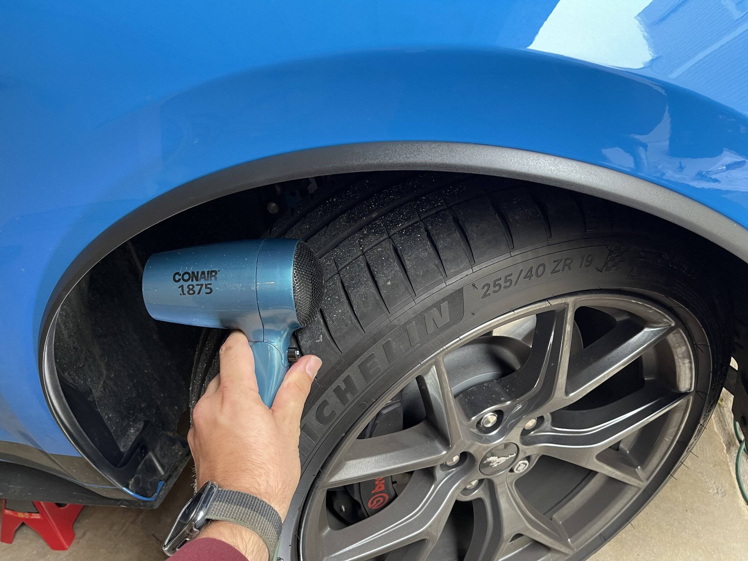

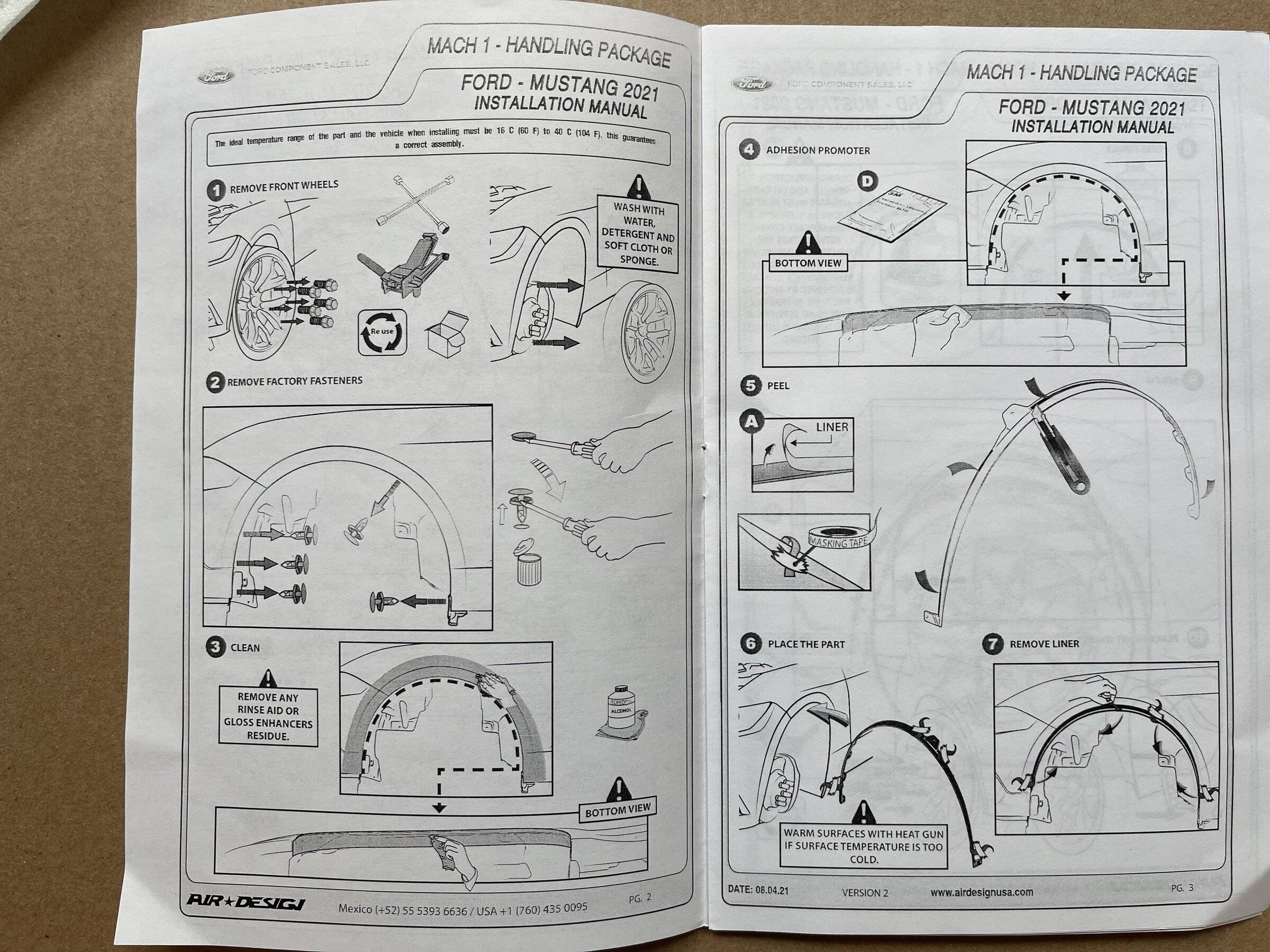

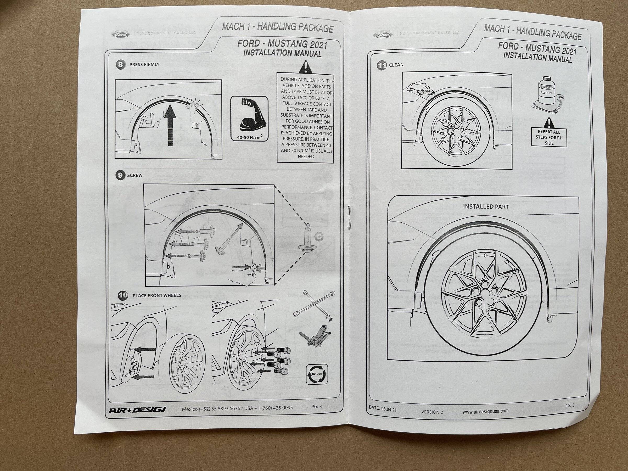

Alrighty, busy Saturday adding the clips to the rear guards but I was able to add the front wheel lip moldings as well. overall it was an easy process. First I wanted to post the full instructions because they don’t seem to be readily available:
A couple things I did differently than the instructions:

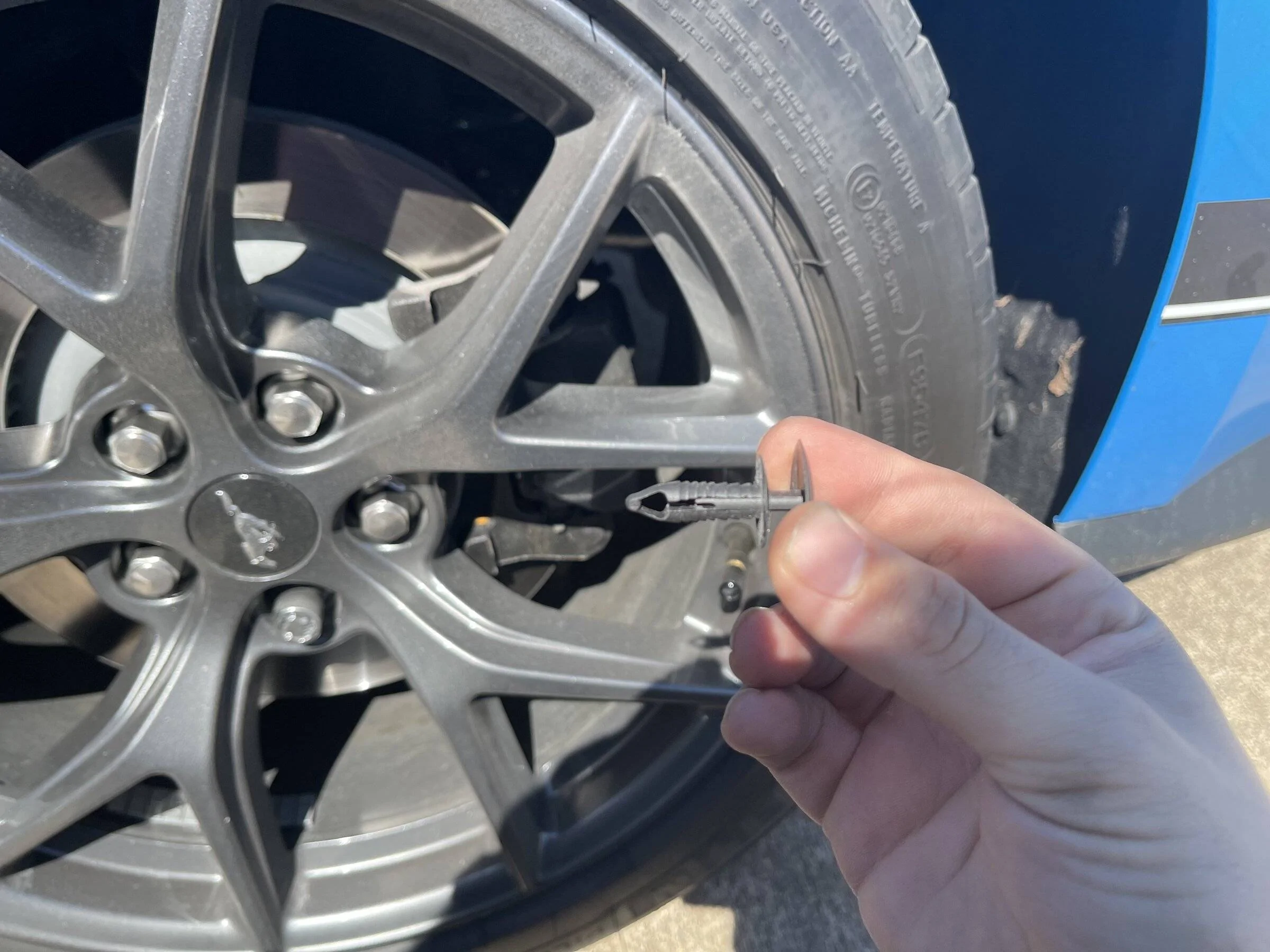

  • Didn’t remove the wheels: if you just jack up the car and turn the wheels, you'll have more than enough room.
  • Use all of the provided clips: I have the Novistretch mesh cover that uses clips and screws for 2 of the 3 front end pins.
The instructions also don’t specify which pins to remove:

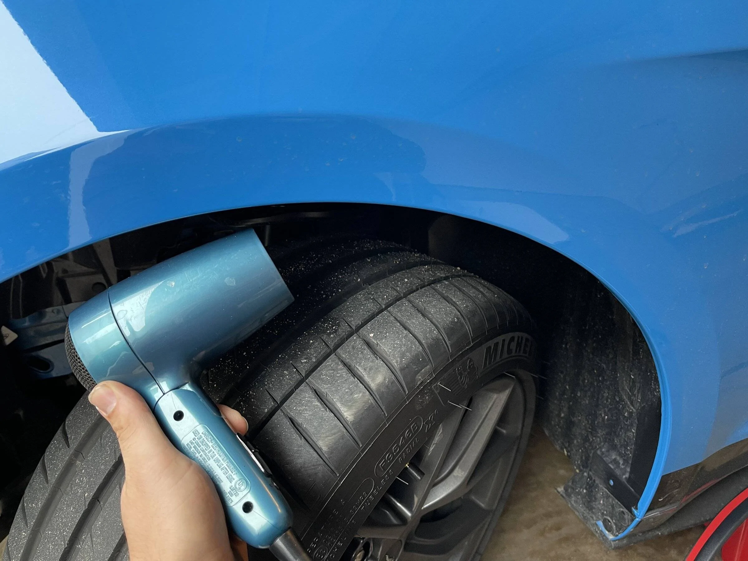

It was cold here in Houston so I used my wife’s professional heat gun:
Fitting the molds was easy following the instructions but I just wanted to warn the adhesion activator smells god awful. Highly recommend a shop fan rather than just a box fan.

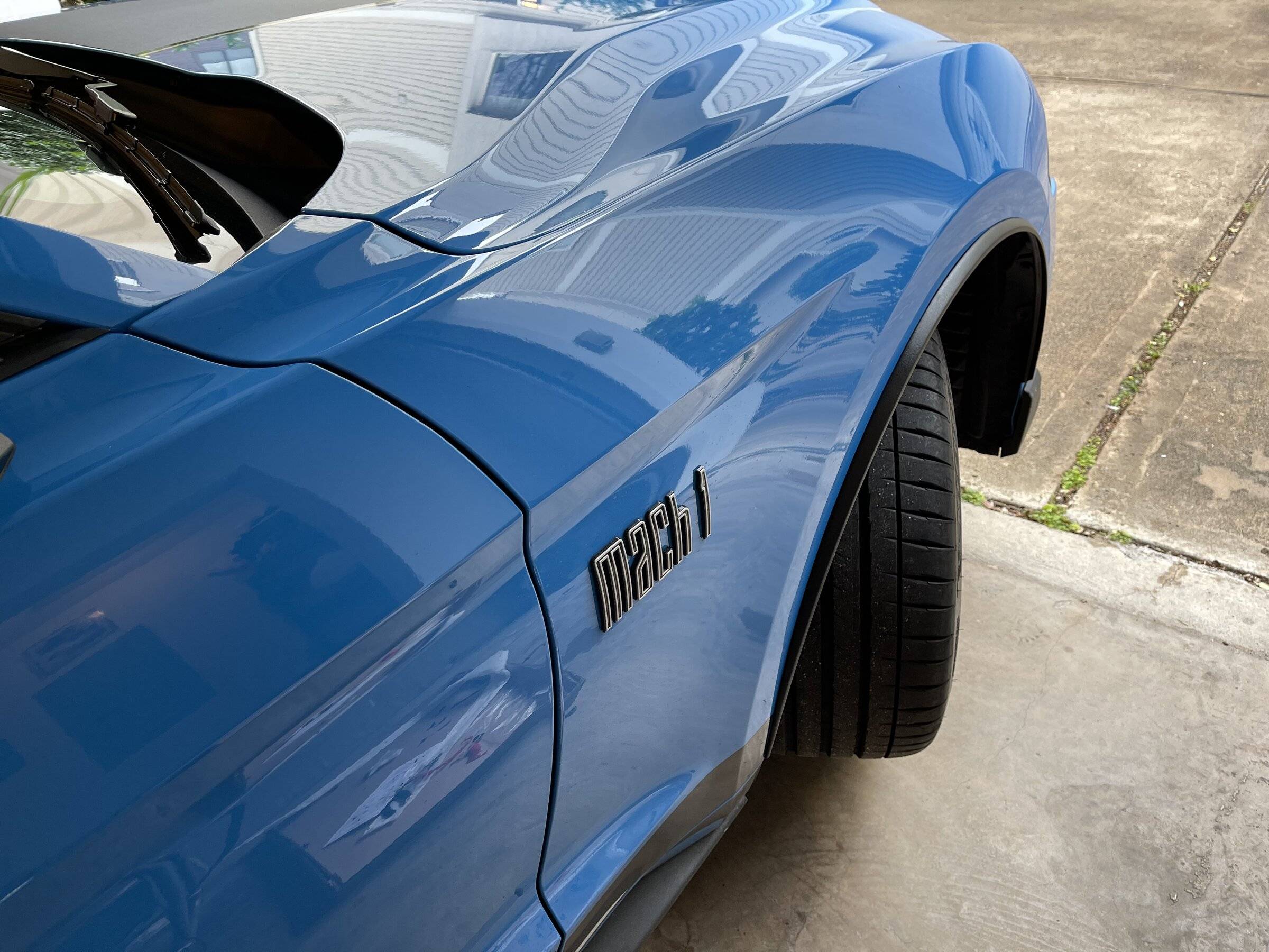

I heated the adhesive after applying pressure to allow it to release stress and then applied pressure again (Old trick I learned in a shipyard).
Without HP wheels on, these do not look bad at all and was another part I wondered why ford left off all Mach 1s.

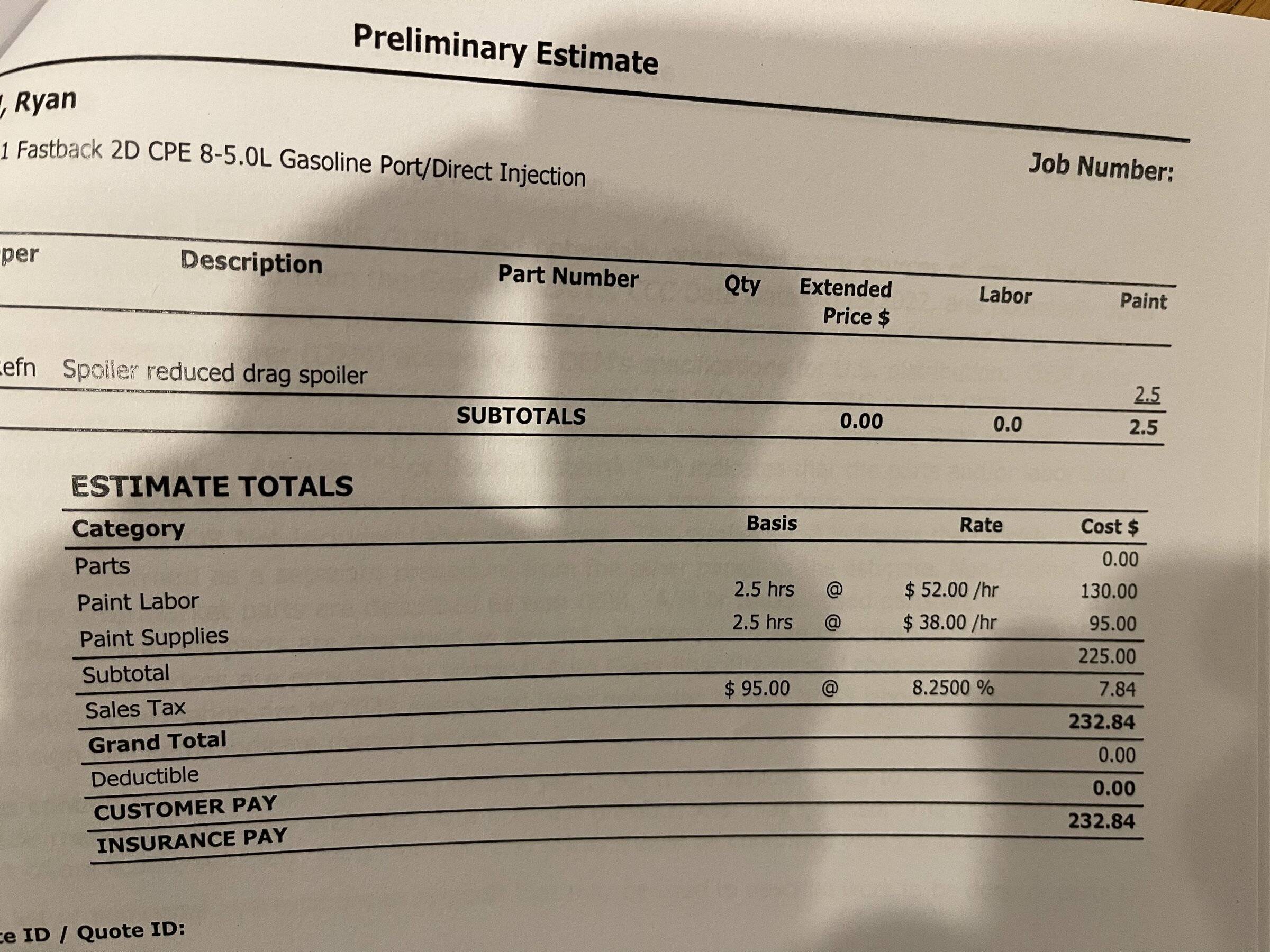

First couple quotes for painting the spoiler and gurney flap have come in at $200-$250 from good reputable shops. This is high, but I feel like in this scenario you are paying for quality so I don’t have a problem with it.
Paint code was determined to be J7 Magnetic Metallic with a 4 stage satin clear coat. Total shop time is 1.5 - 2 days. Still more quotes coming in so ranges here may change.
Update 3/1/22:
The best shops want to match this perfectly with my existing spoiler for around $460 but I don't think its needed. Fun fact: the shade of magnetic metallic on your mirrors, bumper, and spoiler are all a little different shade! Thanks Ford quality! A Ford body shop in the area told me its typical where even on the F150 Raptors the fenders are all different shades 😂
Price range is from $200 - $478 at high rated high volume paint shops. Most are at the $200-$350 range. A lot are excited to do this and want pictures after I install it. All were very patient and listened to how I thought it was supposed to be handled where they each then went into how they would handle it.

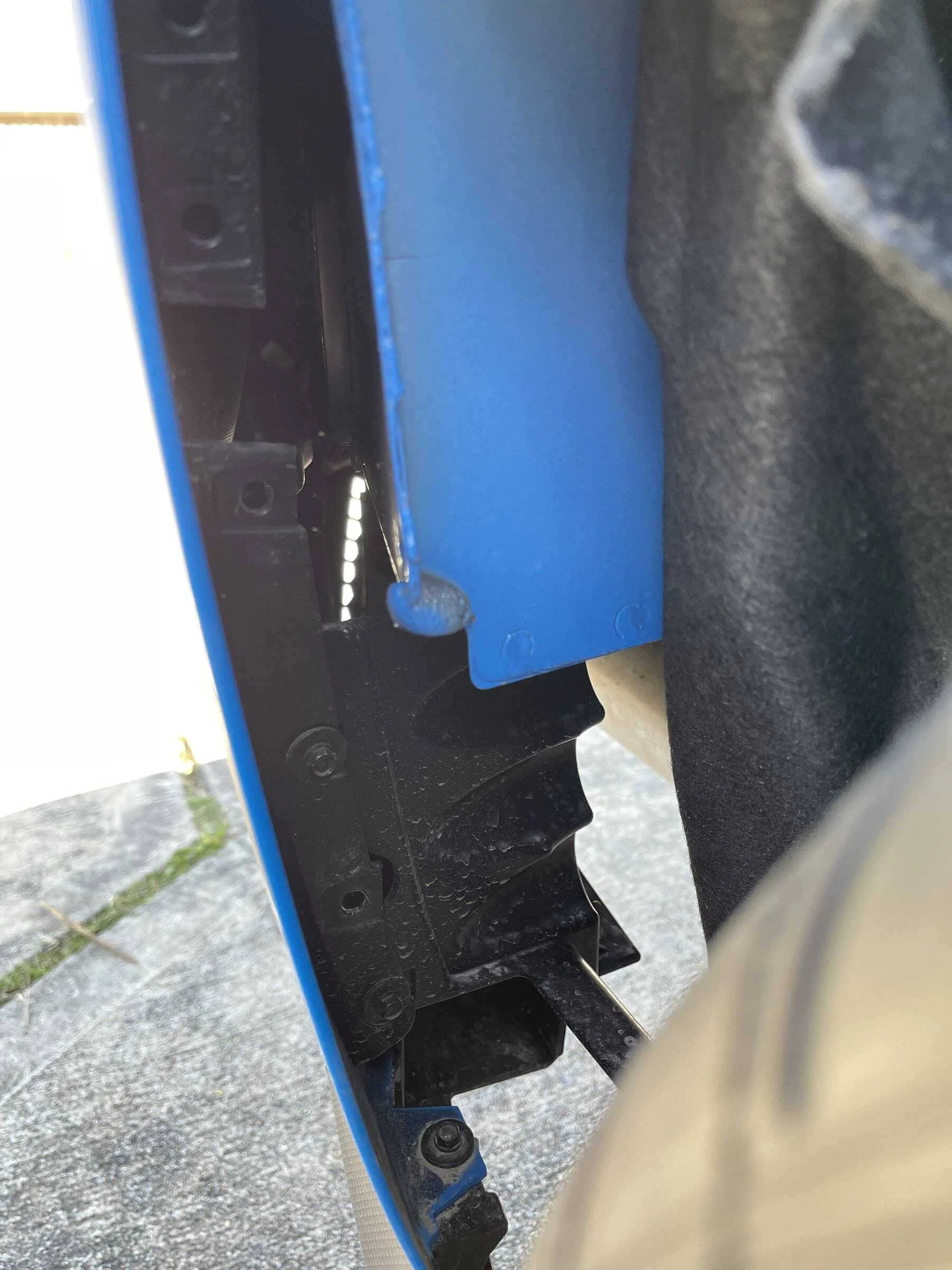

I went to fit the spoiler and everything appeared to line up correctly. Removed the blade (that’ll be a separate post) and Followed the instructions to the “t”. I cut the tape shields and added tabs to the bottom of the shields in order to pull them off as I was lowering it once positioned correctly. Center portion is absolutely perfect without issues:
passenger and drivers side portions are lifted and won’t go down no matter how much force I push down.
Update 3/16/22: Deleted past updates and my various false assumptions 😅 Found the issue! To paint the spoiler, the paint shop hand tightened bolts on to the outer two threaded studs and then covered them with painters tape. They uncovered the threaded stud but not the bolt beneath it. I don't have a picture but they made it look like a neoprene washer and I missed it. I was able to unbolt the outer wings and gently warp the spoiler away from the trunk to take the bolts off. Since these bolts created a gap, I could still use most of the tape. Where I couldn't I used 3M automotive tape to fill the gaps. I bought new nylon nuts and washers to use as well (size M6-1.0 for reference). Install was a breeze after that and as described.
