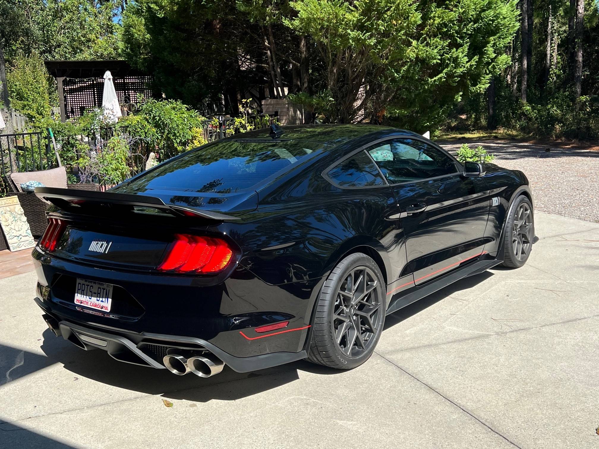

Yes, they fit perfect. Picture for reference
Looks Great. Is that the OEM size up front 305/30/19? it is hard to tell from the profile of this picture but it looks like yours fills the fender gap more than my stock cup 2's. I was considering putting a 275/35/19 on to fill the gap but those 305's really handle well.
Yes, 305/30 up front and 325/30 in the rear.
