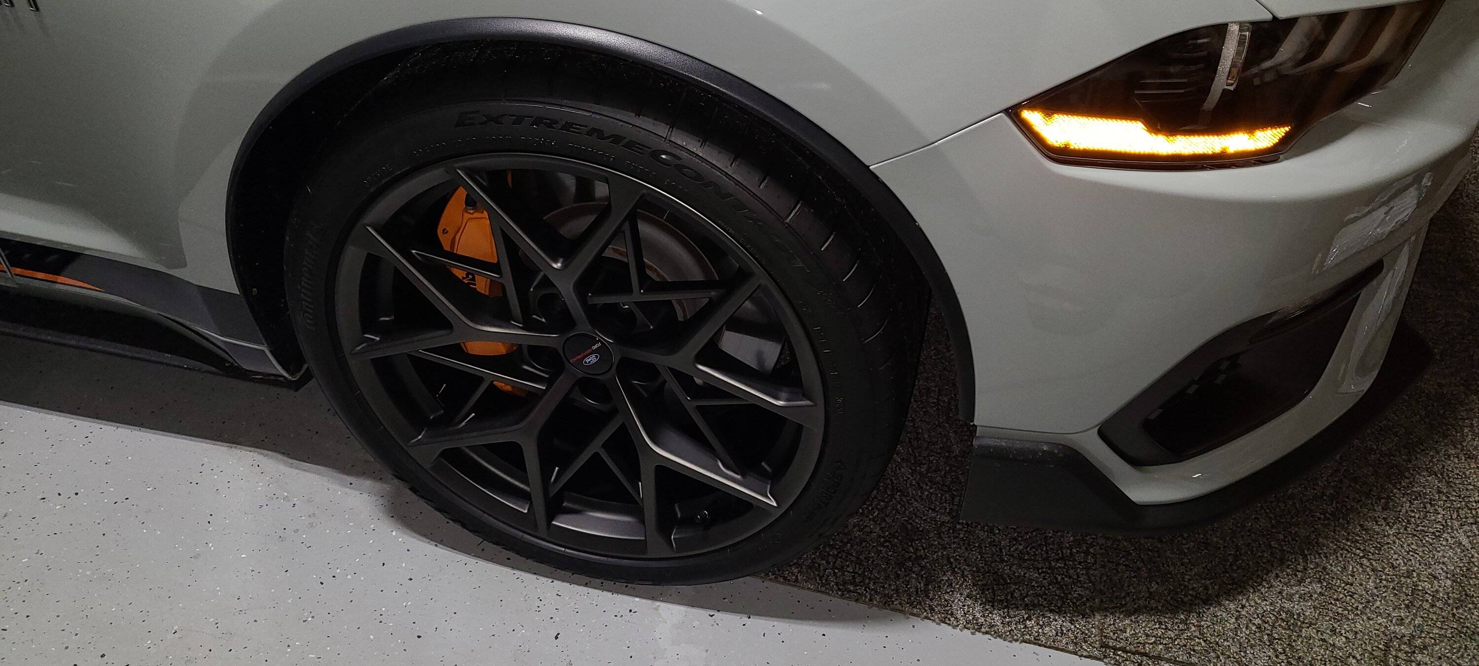

So, I went with the Continental Extreme Contact Sport and they are a HUGE improvement regarding daily driving. The tramlining cleared up completely.

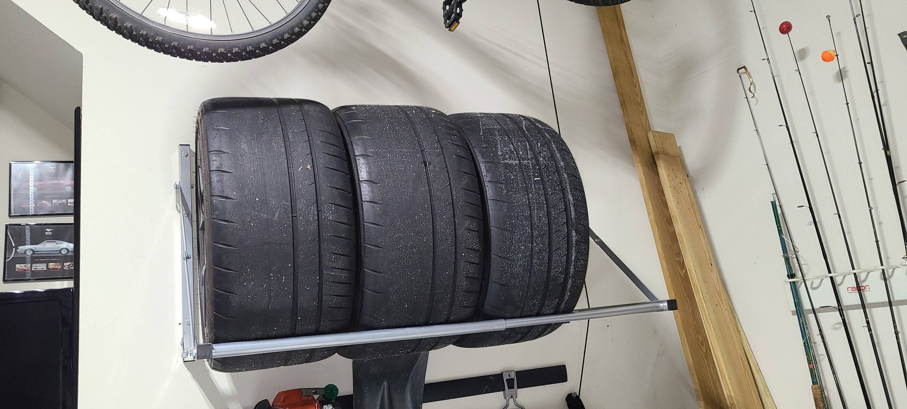

On another note, Discount Tire was supposed to hold my cup2’s for me to come get the next day, but they forgot and they were taken for disposal. They only has about 1600 miles on them. So, to make it right Discount ordered my a brand new set of cup2’s. I’ll either put them on another set of wheels in case I do a track day or I’ll sell them? Anyone looking for a new set of cup2’s at a good price?

Well they run $500 each here, so I’d let them for for $425 each.

I went with the Continental Extreme Contact Sport too but have not had chance to drive it yet since I installed them late yesterday and out of town for the weekend. Did any one experience any issues with the tpms sensors? Received a relearn tool from FP if needed. I am scheduled for an alignment if needed. There seems to be good even wear and slightly more positive camber. I will probably go with something that's more Street drivable than track obviously with these tires.
After 1k miles on the Extreme Contacts, I have nothing but great things to say about the tire. Even tread wear with the factory alignment. The only time the car has tram-lined was driving on multi surface interstate where they were re-paving.
