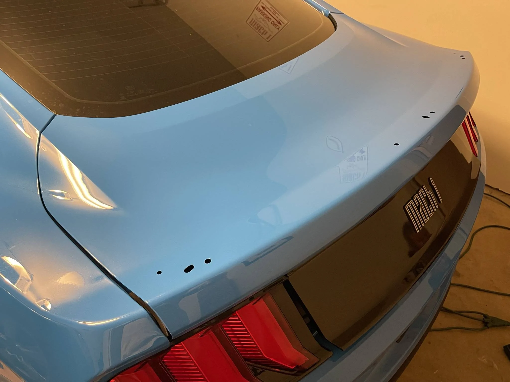

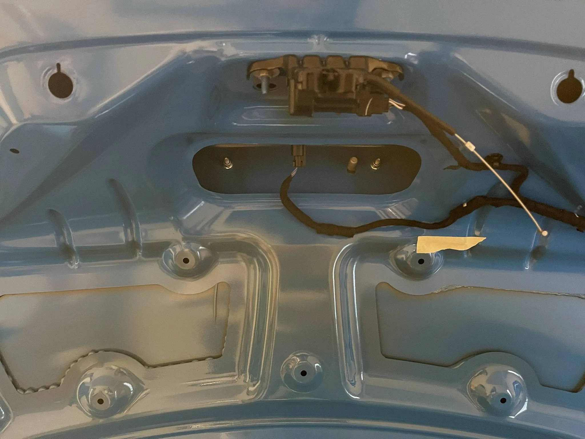

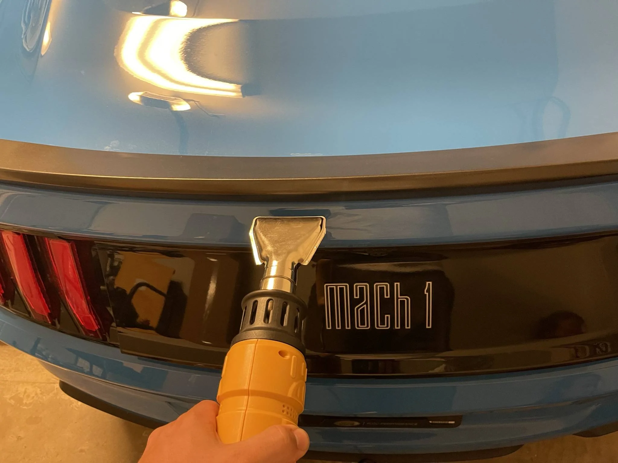

Back to some Spoiler talk. Alright after that little hiccup (go see the end of post #7 on here) I can go into how I removed the blade spoiler without hurting the car at all:

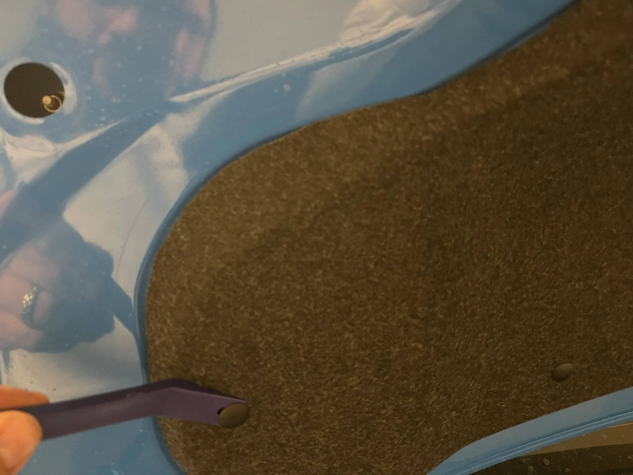

First I had to remove all of the trunk lid insulation and covers to get to the spoiler's bolts. There are plenty of youtube videos but this guy goes into the most detail of getting at them. He does make it look easy as I'm sure for most of yall the deck lid latch cover wont just "pop" off like his. Mine has plastic stress marks from this process. The trunk lid bumpers were also a pain as the factory cross threaded one of mine.

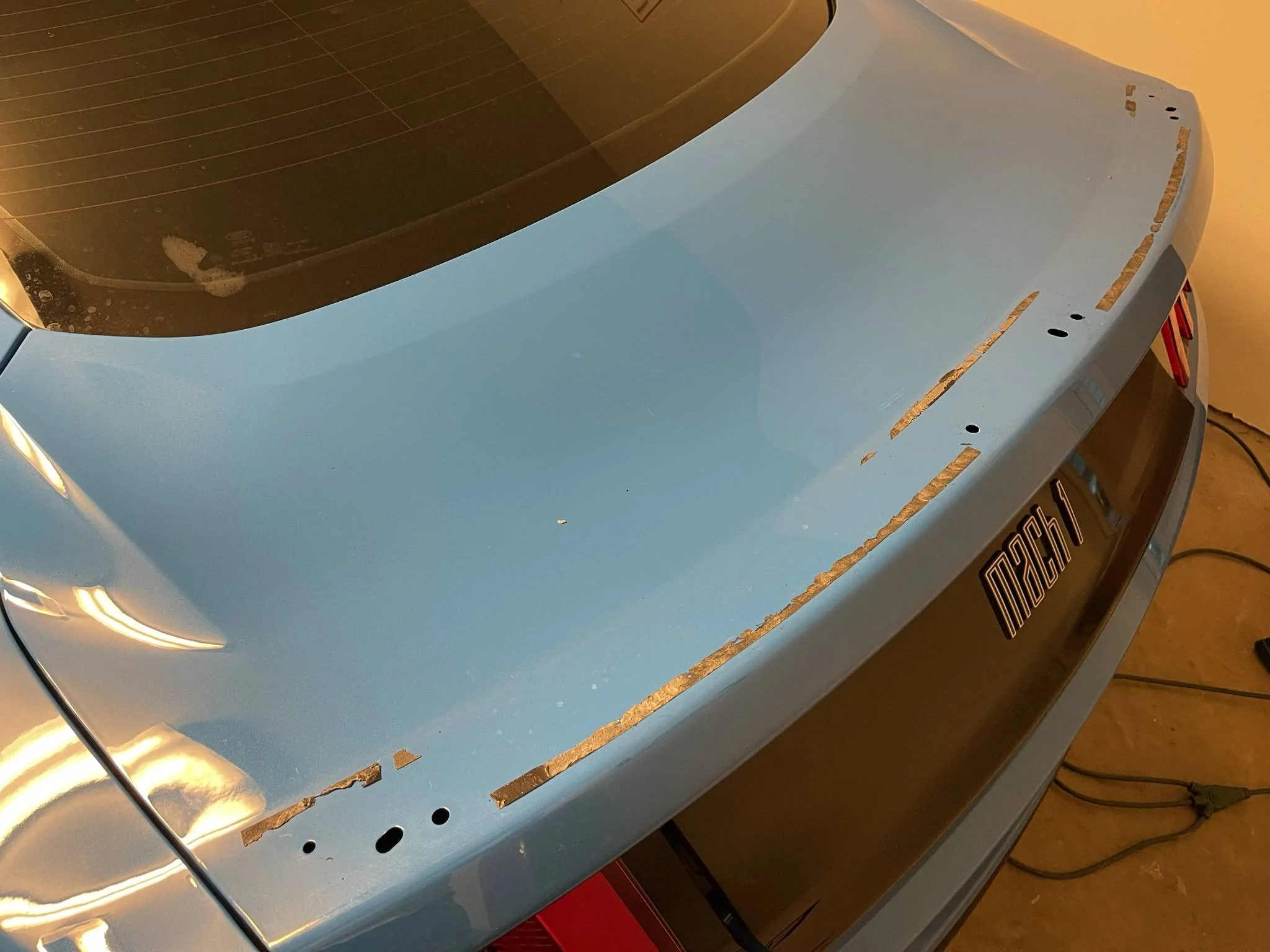

After taking off the bolts (follow the previous video or this one to do this) I pre heated the blade's adhesive with a $30 heat gun from amazon.
Instead of using plastic pry tools that could damage the paint, I used 50lb fishing line and fish filet gloves (~$10) and began gently sawing through the double sided tape at either end. Be sure to saw upward at an angle (not directly across the bumper) so it does not hurt the paint. Once I hit the threaded stud, I gently pulled up on the end until I created a big enough gap to thread the fishing line through to the other side of it. Once I made it to the center of the spoiler, I slowly lifted it off and away leaving a mess of residual double sided tape for me to clean.
There are easier ways to do this (eraser wheel or goo-off) but I did not want to chance hurting the paint. With one hand holding the heat gun and the other rubbing the adhesive I developed the worst blister I've ever had in my life cleaning the trunk lid. I then used alcohol to clean the area in preparation for the spoiler.

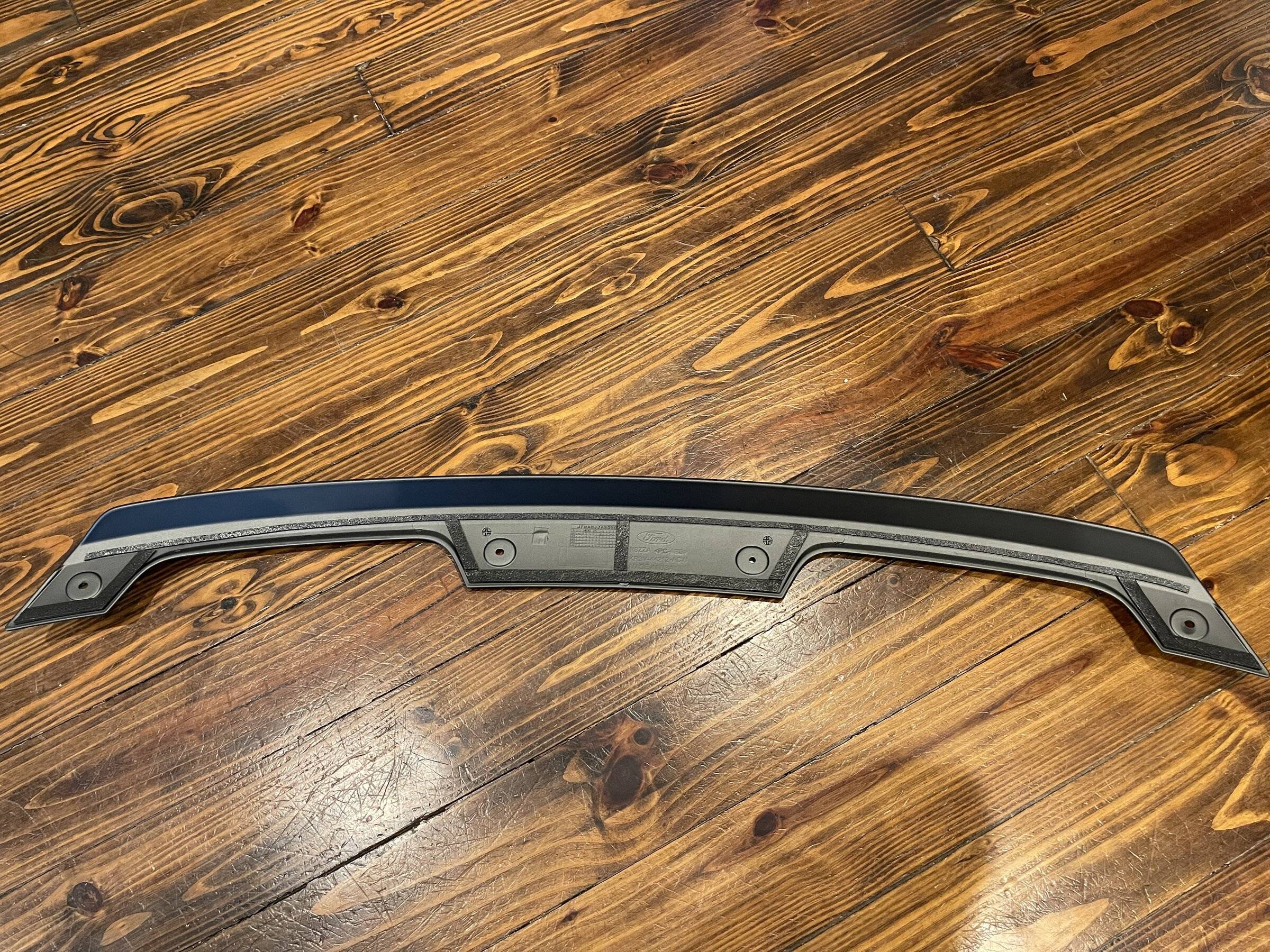

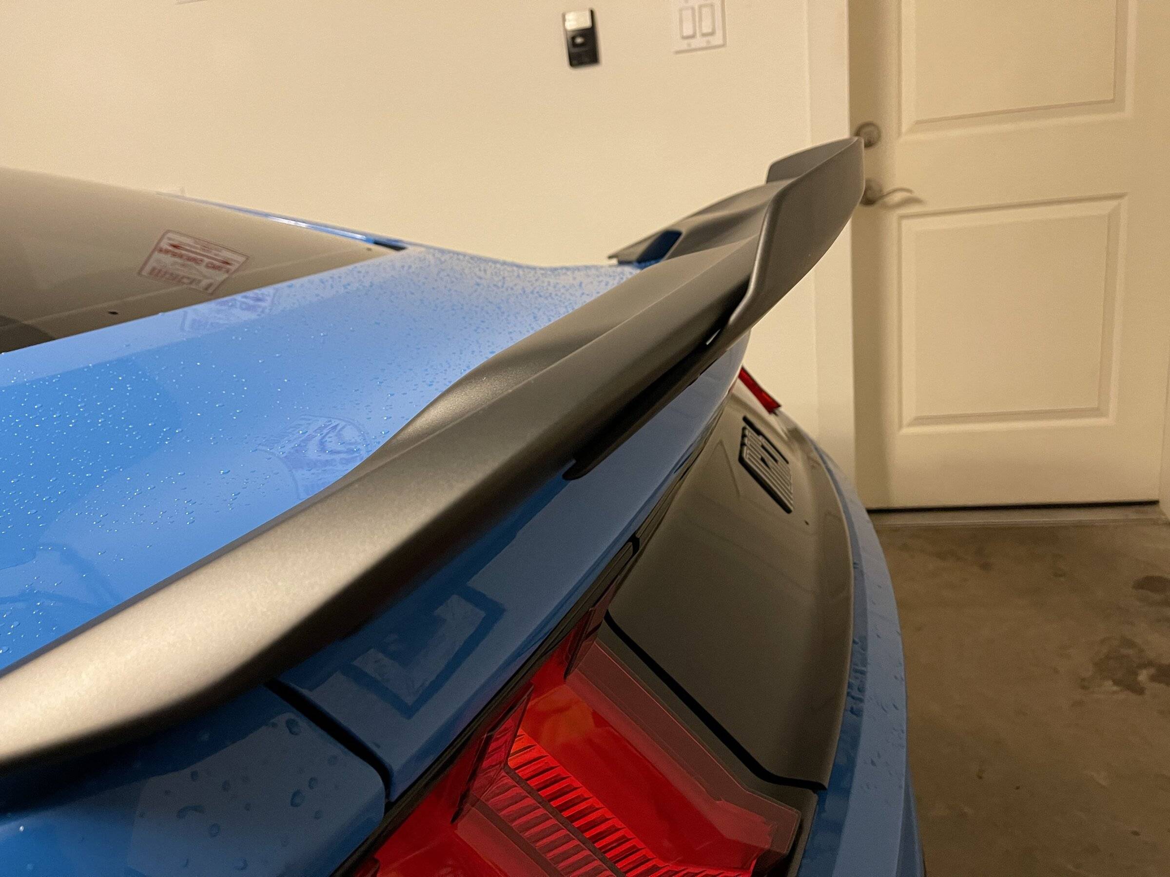

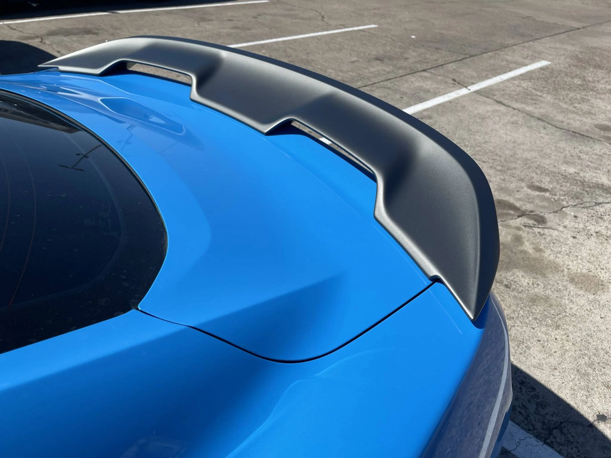

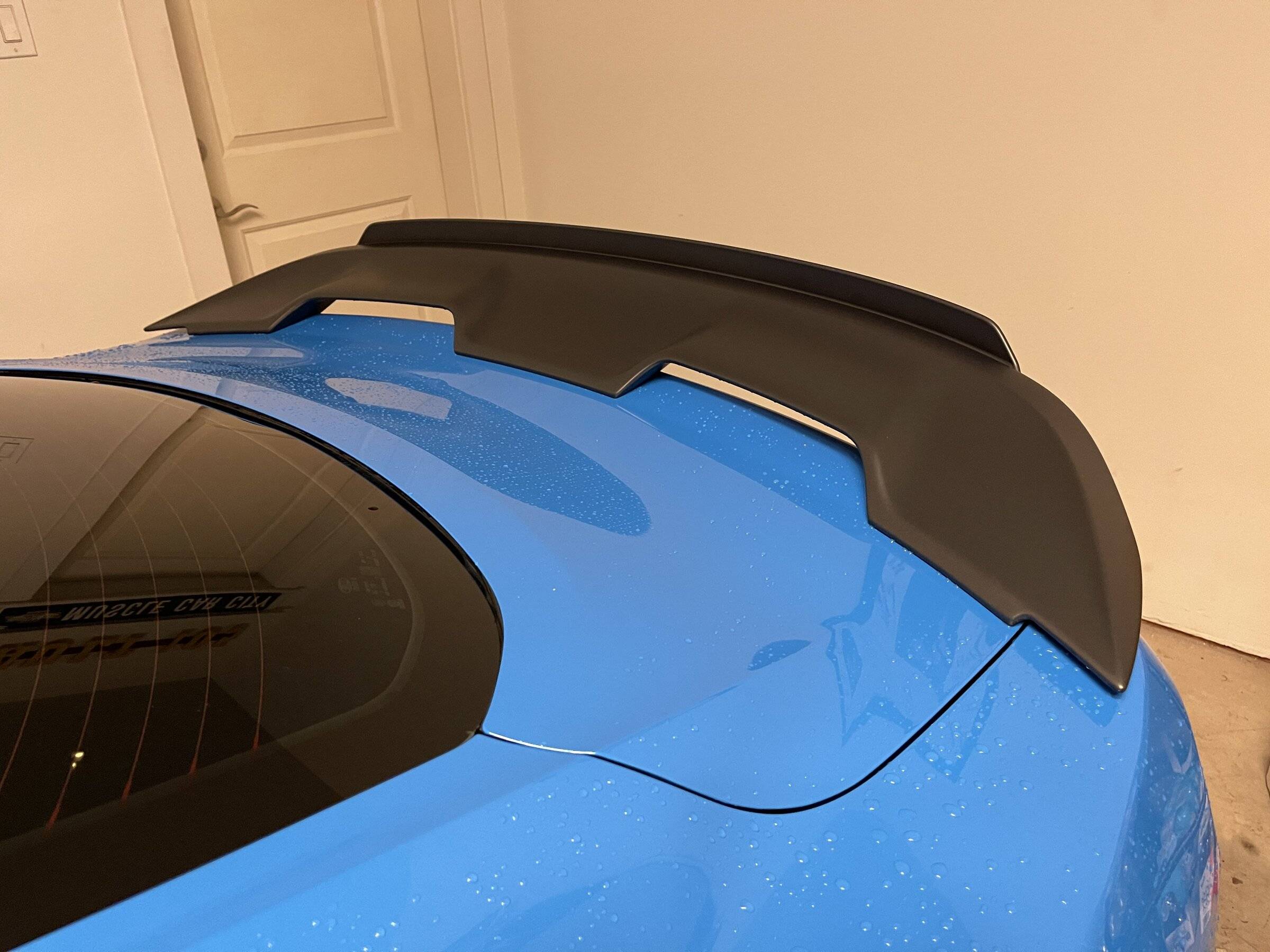

Next I will kind of explain how it should go and not how it went for me 😬 again. First begin by laying the template over your bolt holes to make sure all are centered. Then prep the new spoiler by cutting the tape film and adding tabs so you can pull the film off after lowering the spoiler on the car. I used an exacto knife but a box cutter will work just as well.
Lower the spoiler carefully and make sure all studs go easily into the trunk lid holes. If you are working alone, wrap the outside wings in towels and line up the center portion. With all studs aligned, I threaded the nuts to the nylon bite point which allowed me enough of a gap to pull the film off. First I aligned and dropped the center portion of the spoiler and then the outside wings. I applied pressure to the adhesive points working outwards and from the front to back of the spoiler. I then tightened the nuts down and repeated applying pressure to the three areas.
Though it was a hell of a headache I think it turned out great!
For those who want theirs painted as well, Tommy Vaughn Ford body shop did an excellent job and made it a point to not just match the paint of the blade spoiler but the other magnetic grey parts of the car.
Next project will be adding the foam tape back to the gurney flap (body shop removed it) and then will be done with the spoiler .... finally.

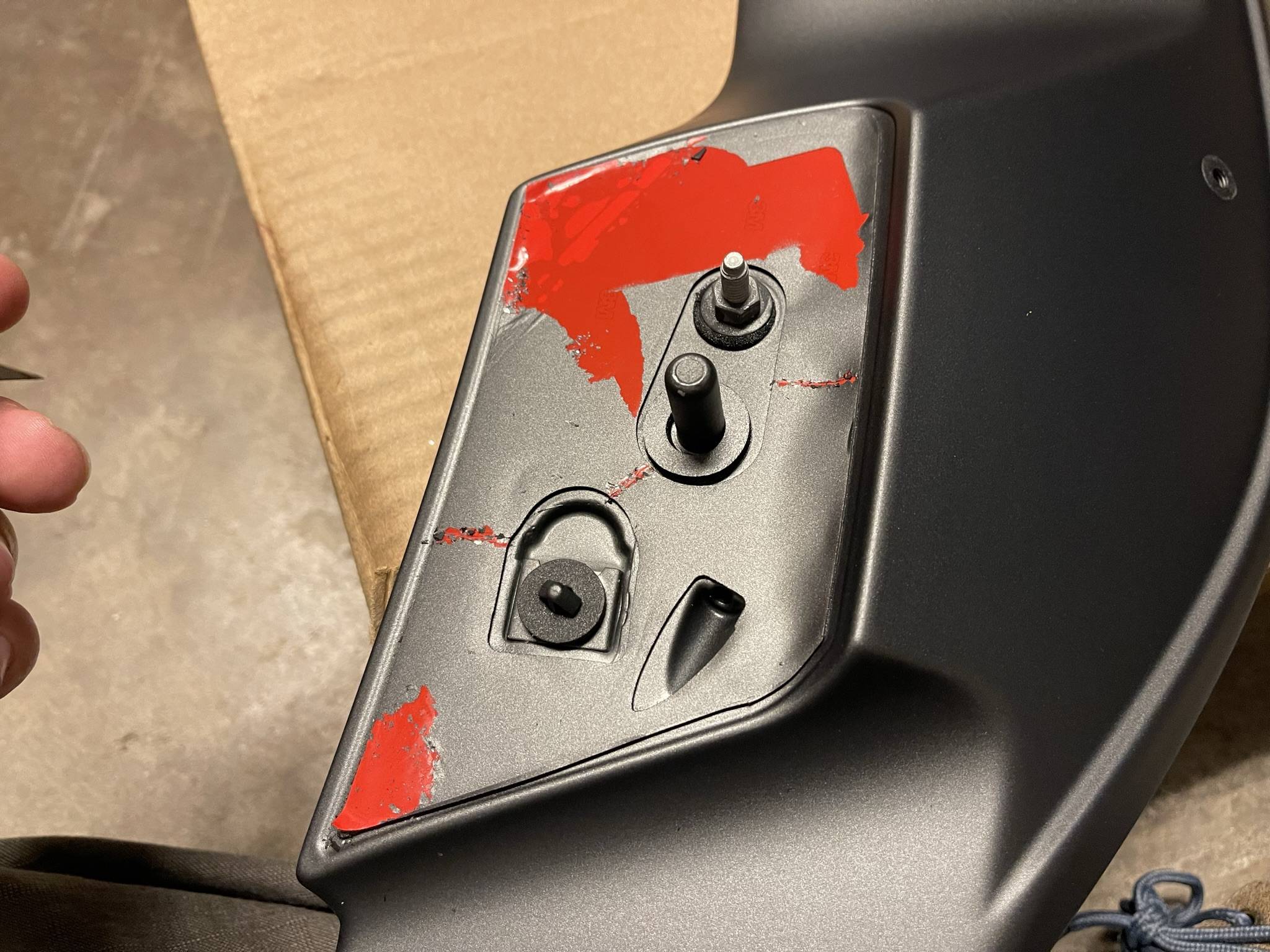

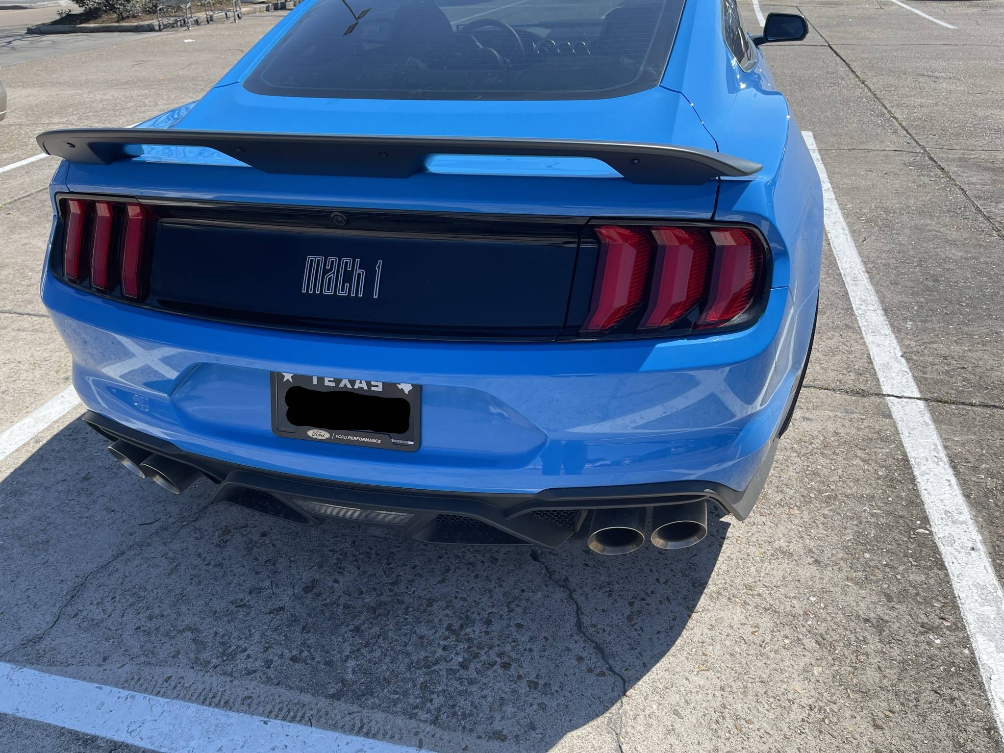

I added extra to my gurney flap since I didn’t have to worry about running out:
I bought four rubber 1/8” thick washers (~1.25” in dia) and lightly glued them to the bolt holes. Forgot to take a picture of this but you get the idea. Adding the gurney flap was easy and definitely adds a whole new look to the spoiler.
Some complain they can’t see out of this car with it on but after driving a Camaro for 6 years I felt right at home 🤣
