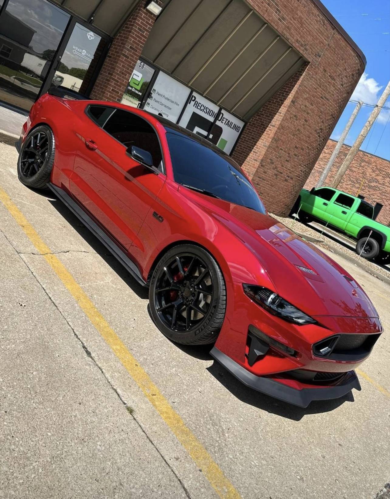

hey guys im going to add an ESS blower to my 20 gt in march. planning out the build list on what to do next. performance shop that im going to with there kit (ess g3, opg, headers, bigger fuel pump, ect.) stated it will net me around the 720whp area. this car will be the typical street car going through twisties and do roll races (40 and 60 rolls) with ocassionally going to the drag strip. i have most of the steeda parts for the twisties (ill add the list at the end) but i have no parts to help for the extra power such as half shafts or driveshaft. do i need to upgrade those? if i do then what brands are the best quality and balanced as i HATE having the howling sound of the diff lol or do i need to even get upgrades since im mostly doing roll racing anyway? all advice is appreciated. also any other parts to add to this list please let me know was think about adding a roll correction kit and end links as well
installed parts:
ford performance magneride lowering springs
ford performance front and rear sway bars
ford performance magneride tune
bmr 4 point front chassis brace
steeda sub frame connectors
steeda irs alignment kit
steeda toe links
steeda diff bushing kit
steeda vertical links
steeda irs bushing insert kit
poly lca bushings
ford performance knuckle to toe link bearing
steeda camber bolts

Now this is a car I'd like to drive. To see what difference all those suspension changes have made.
Did you do the FP Magneride handling pack?
yes i did! this car feels extremely solid in the rear end. still understeers a little bit but thats probably due to the slightly skinnier tires in front
