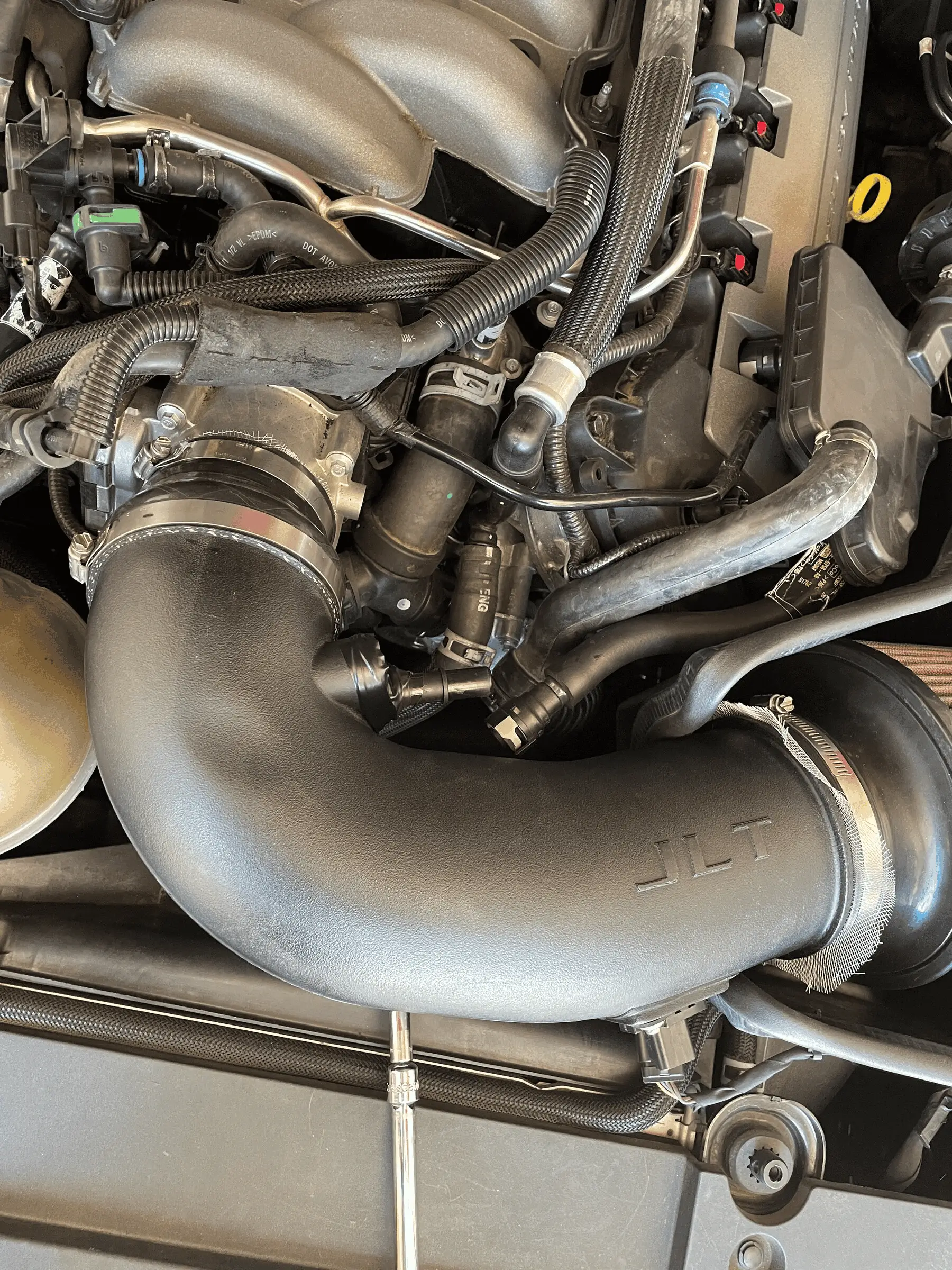

Because you ran a tune you knew was bad? No because you had a a airleak and had air that was not being metered by the maf you didn't know how to fix.
Some people simply should not be working on their own cars. Same reason your new engine runs so slow and has issues

Lmao you couldn’t even find the problem.
Your tune had shifting issues that you couldn’t fix and another tuner could. What’s to say your tune had another issue that you couldn’t identify but another tuner could?
I pressure tested the intake. The intake is fine, even if a small amount of air was leaking around the breather hose connector it wouldn’t cause the fuel trims that the car had.
I reached out to you trying to help you with your transmission tuning issue. I have been trying to be fair to you when discussing you on the forum. No reason to personally attack me.
I’ve done many things successfully on my car… The reason the car is running slow could be because of a defect in my head studs leading to low compression. I tore down my motor and found no signs of me doing anything wrong, rings were fine. I also have 3.15 gears, stock converter, and full weight.

I think you might be missing something .........you can not fix a transmission shift issue until the car is running, or tuned, right . Looking at your logs , you have posted them , you had a major vacuum leak . You where chasing pre throttle body , but I would put my money on , it was post throttle body . Next time try a smoke test vrs a pressure test . Or pull up your data log and watch short trim at idle and then again at 2500 rpm . If trim goes to normal at 2500 a vacuum leak is present . You have been focusing in your cold air kit but you should have moved further down the line to get your a/f right . Then you should have looked at your shift issue . But what do I know , mine is amanual .
