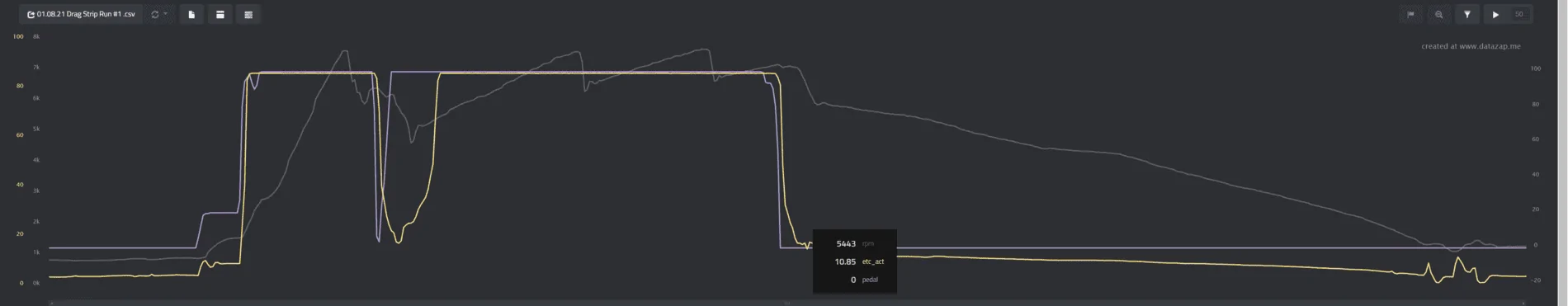

That let up on the pedal was brief to you but the throttle wasn't WOT again after it for almost two seconds. That cuts a lot of MPH from the trap.

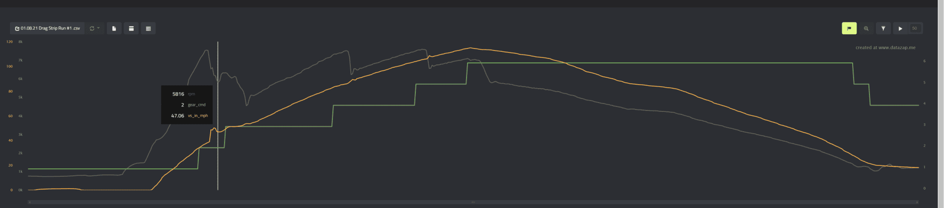

That brief let up on the throttle also cause the transmission to upshift to 3rd, skipping 2nd, probably why the throttle took so long to go back to WOT. This is a big chunk of time you can pick up.
Until you get a pass where you are WOT the entire time and use all the gears available I don't think there's anything that can be done in the tune with out making some thing else like drivability or power output worst. A 27-28 mph back half is fine for a stock weight NA car. Pick up the MPH in the front half by not spinning and staying WOT.

didn’t know how much I should’ve expected to lose by letting off the throttle, so thank you for your input. Very helpful!
will report back after I get some better runs in this weekend.
