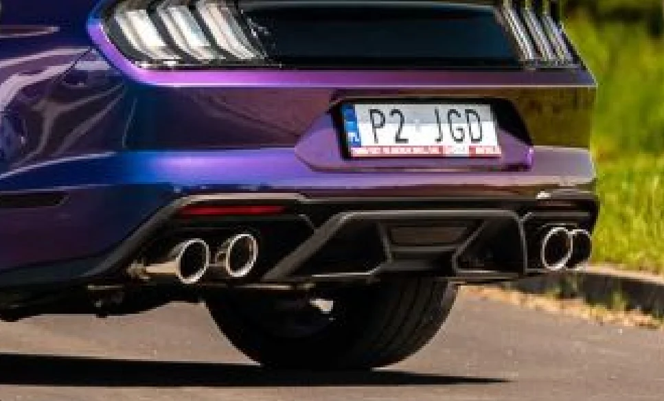

Hey I’m looking for a Quad active exhaust for my 2016 GT. I don’t want to spend big money and have a budget of €1700 -€2000 (£1450-1700).
Have found this but don’t know much about this company. Not a fan of the rolled ends but beggars can’t be choosers I guess.
Doesn’t seem too easy to find a quad active for these.
Any other options anyone can point me to ?
This is the one I was looking at.
https://jgdattack.eu/en/axle-back-exhaust-system-h-pipe-mustang-2015-2022-gt.html

Off the car, that looks to be quite a nicely fabricated system (and I quite like the internally perforated tail pipes), but the on car picture (from their own advert) suggests that fitment isn't great, or they didn't take much care with adjustment :
It would do them some favours to fix that, and to show the fitment better from multiple angles with high res images.
I would ask before spending €'s ... :like:
Note : I have never heard one, but I know others have commented that a straight piped / unsilenced coyote (essentially what that system is when the valves are open) has a very harsh tone i.e. loud, but not nice ...

They have more photos on Facebook that look straight. It definitely does them no favours posting the photos of the crooked one. Did you listen to the video of the sound on the website ?

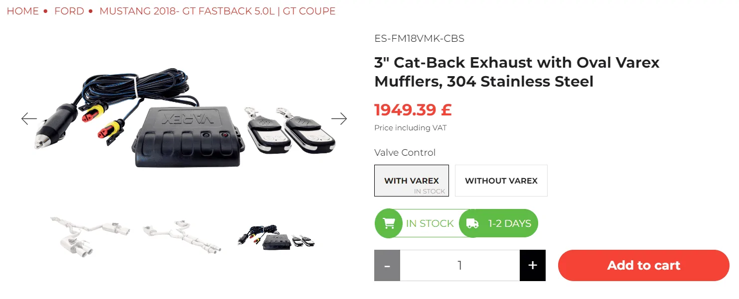

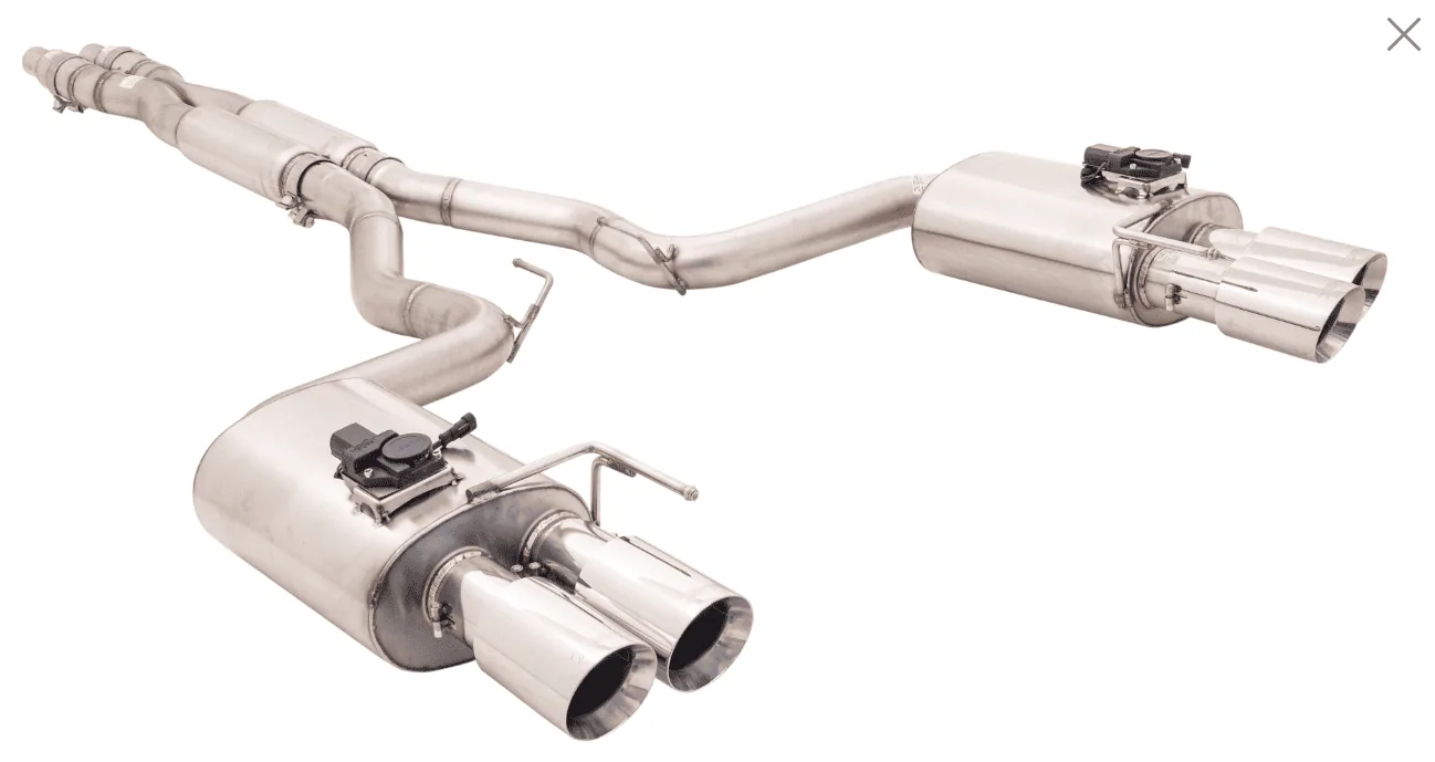

The quad pipe x Force looks nicely made (3" / full tig / adjustable tips / resonated x pipe etc) :
@raptor17GT should be able to give you some good feedback on sound / fitment / overall quality etc :like:

I was looking at them last night but will that fit the 2016 model ? It’s listed as 2018+ but is that only because they came with active exhausts so will plug and play vs having to wire them into the 2016 ?
I’m new to mustangs only have it a few weeks so still learning about what works and what doesn’t.
Looking at the advert, it suggests this is a stand alone system rather than having to interreact with the 18+ active exhaust :
Other than that, I believe the only difference across the years in the S500 GT exhaust fitment is the rear valance (which you will have to replace or modify anyway if you want to go to a quad design) :like:

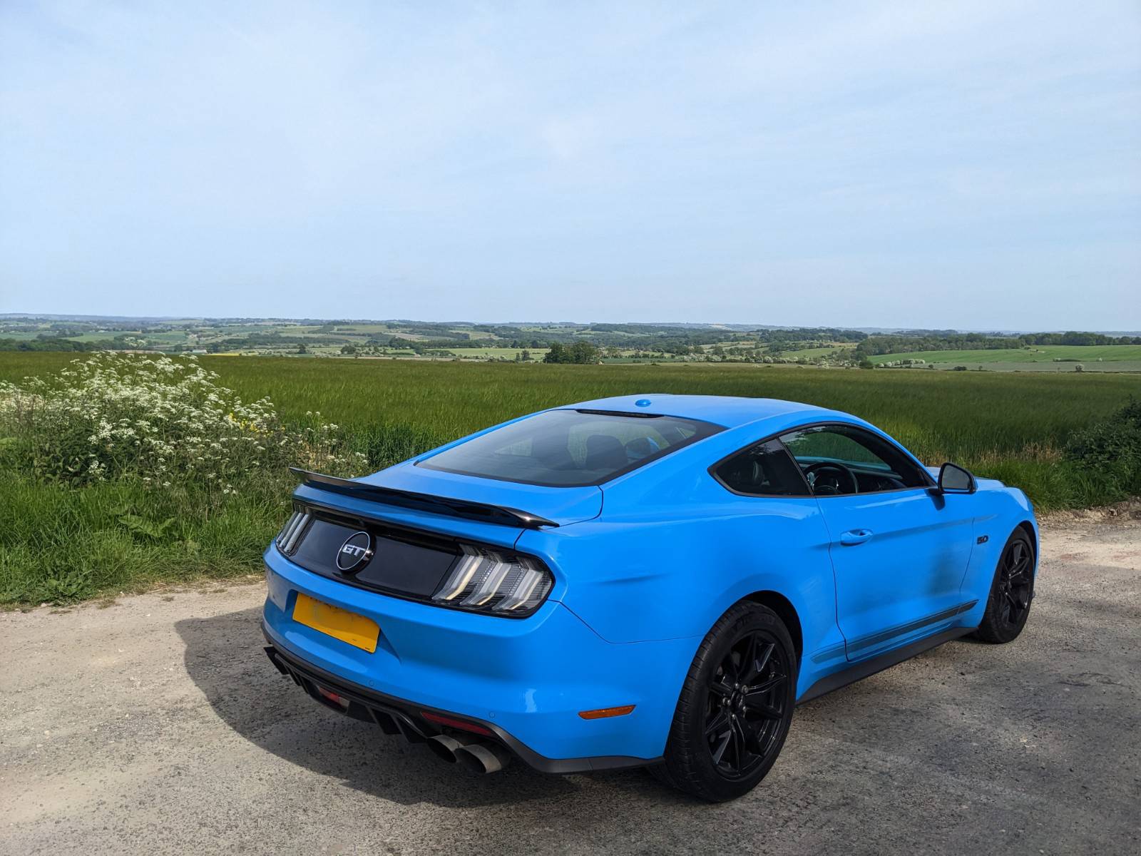

I managed to fit an active exhaust to mine all in for under £600 using a OEM 2018 exhaust as I wanted the quad tip look but didn't want to spend a fortune at the time on the Ford Performance GT350 Active kit that was £3k+
This is how I did it:
-Found a used 2018+ OEM exhaust, in my case it was one from a Bullitt with the black tips. managed to find it cheap on eBay - £300
-MP Concepts Quad Tip Diffuser - £180
https://nemesisuk.com/collections/m...mp-concepts-mu15-18gt-df-quad-mustang-2015-21
Originally, I just cut my rear diffuser but it looked messy so took a punt on this. Fitment is tight but acceptable.
The standard colour matched lower diffuser can be cut in a way that you can reuse it should you need to return to stock.
*I believe any 2018+ catback or axle back should work but might need some adjustment on the hangers to centre the tips. My friend has fitted 2018+ Borla S-type actives to his with some adjustments to the hangers.
-Valve Controller from Aliexpress - £100
https://vi.aliexpress.com/item/3283...002445253!sea!UK!0&curPageLogUid=yfz5UcMmP5WN
These are almost identical to what is used on the OEM 2018+ cars. Only difference is OEM cars run PWM so they can be mapped to the different driving modes, where as these are much simpler.
I have since removed the resonator and fitted a Borla Switchfire X pipe which sounds really good in my opinion.

That sounds great !! now to find one here in Ireland where there’s hardly any mustangs 😁 I’ll be in Wales in a couple of weeks I could also have a look there but don’t think it’ll fit in the boot of a mustang 😁
That give me some hope that it can be done without spending a fortune like you said 3k.
I can then get an H pipe too.
did you do a writeup or photos of how you got it to work with the AliExpress valve ? Presume it’s not rocket science.
