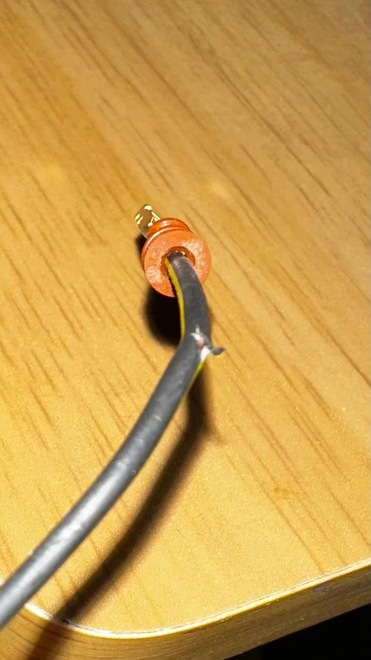

Since the rain was off I pulled the wiring harness off the drivers side exhaust and inspected thoroughly, removed all the covering tape and whatnot
The only damage I could see was was a small cut only just exposing copper, which to be fair could have been me with Stanley I used to carefully remove the covering tape

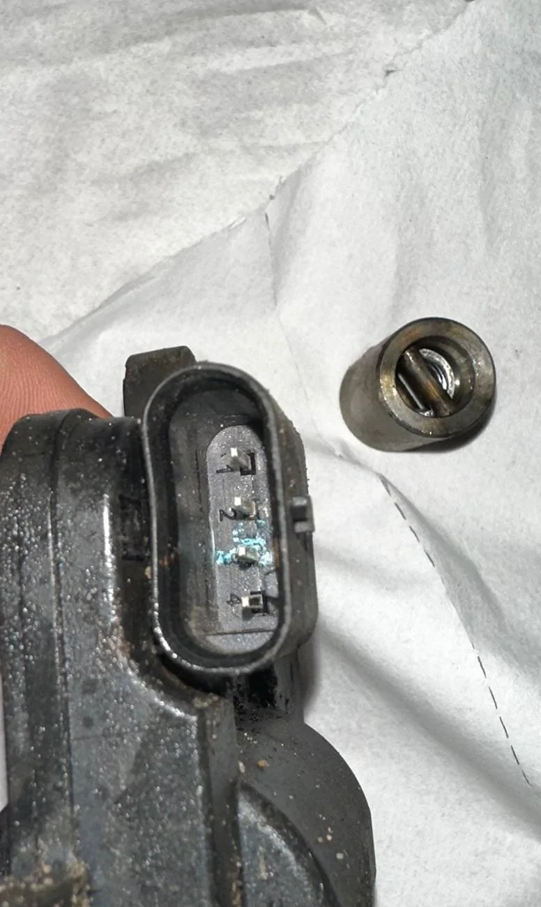

Took the actuators off again, found a bit of corrosion in what was originally the passenger but now drivers side

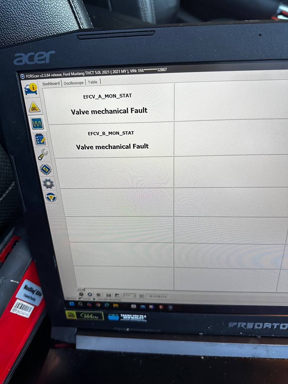

plugged into FORScan on the off chance, looks like I need valve actuator x 2 so I’ll probably live with it for the time being until a cheap second hand pair come up

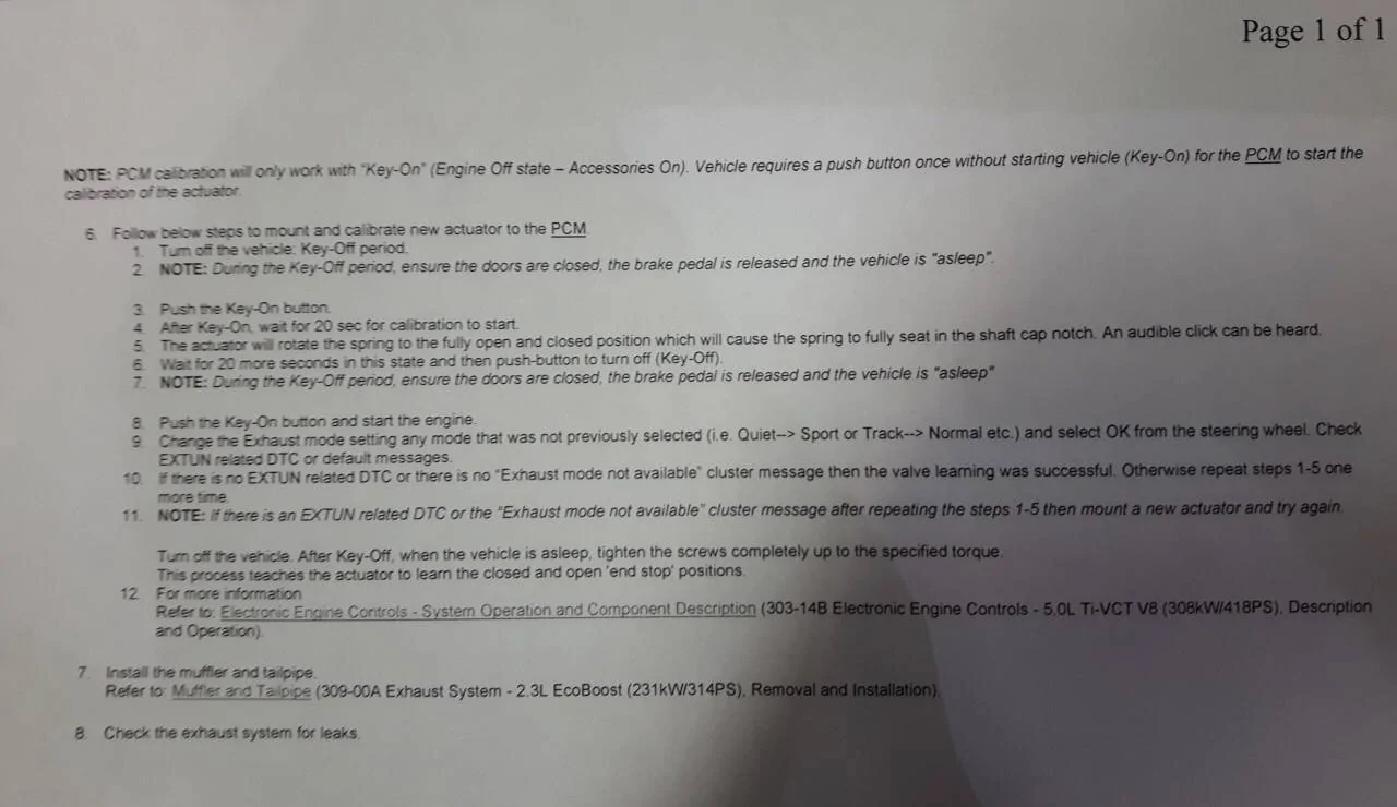

I saw this posted not long ago, have you tried this ?
https://www.mustang6g.com/forums/threads/active-exhaust-sounds-like-crap.121345/page-5#post-2920036
edit: my bad yes you have as per picture above. Can you actually see the valves in the exhaust, ie if someone else was standing behind the car looking up your exhaust (oo-er) can they see the valves move position? My Xforce exhaust you can see the plates move as you operate the soleniod
Yeah the valves move as they should in quiet, normal and sport, wide open in race then straight back to normal, no sticking or jamming if I take the motors out
