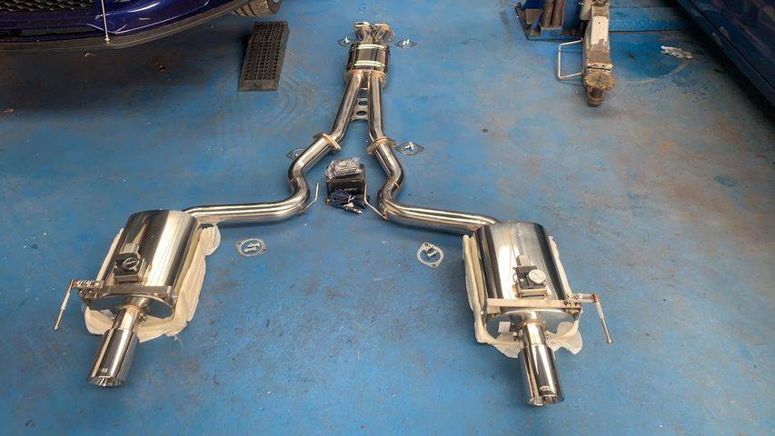

it is strange how the give such nice extras but above is for the facelift model and we ain't got that hence we're here lol. I like my Varex, quiet as stock when closed and no bark on start up like the facelift models even in quiet mode and then obviously a lot louder when opened up but i'd say not as loud as facelift models. However, you could change that by swapping out the Varex suitcase for an xpipe though obv that extra kerching.. My actual Xforce Varex before fitting
