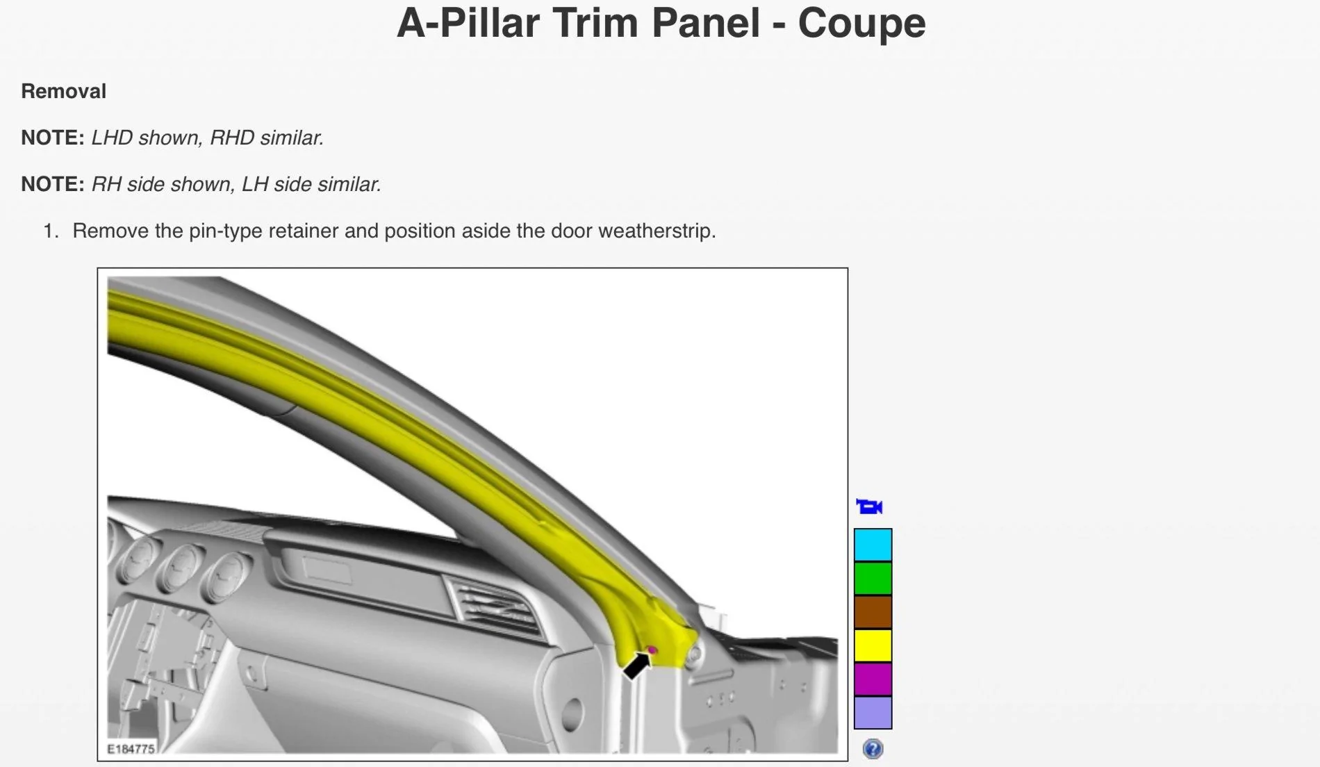

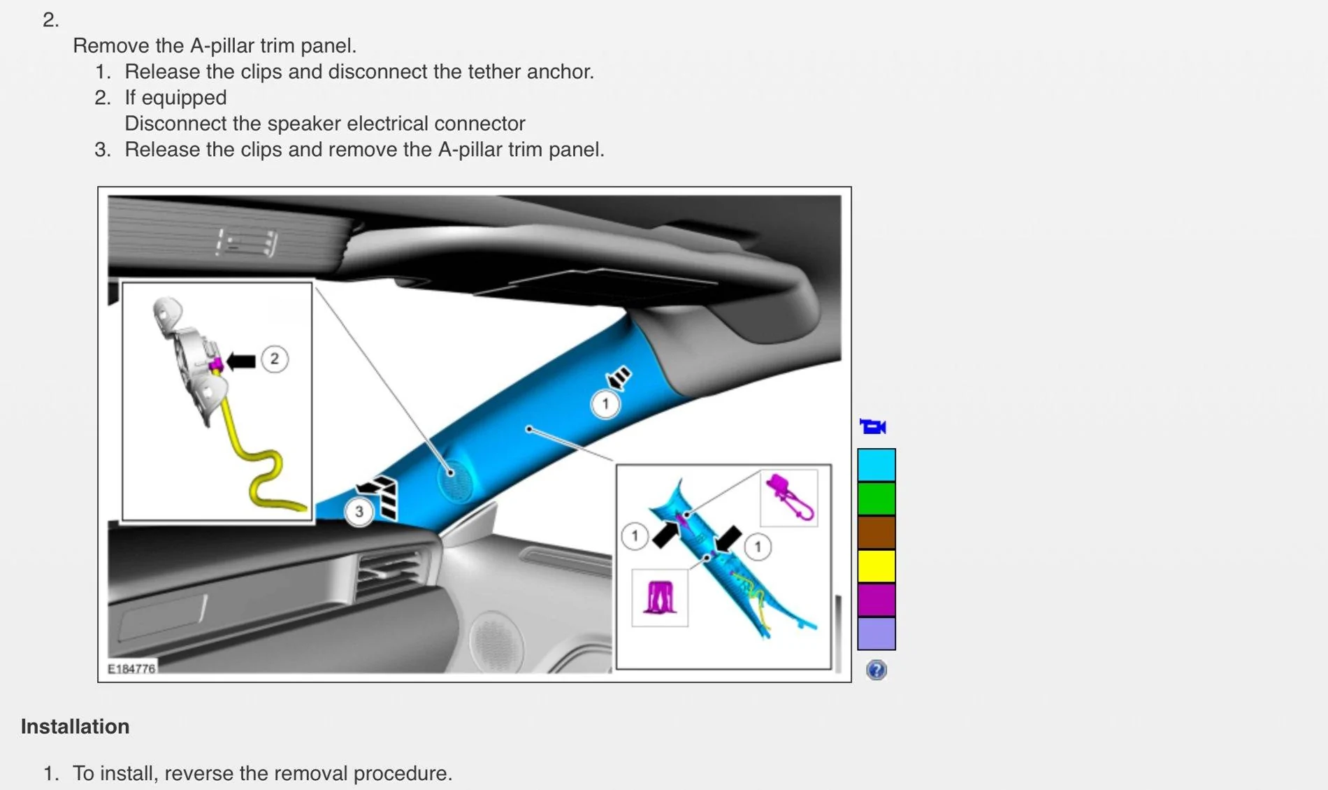

In case anyone needs it for future reference:
Thanks, I needed this! My tint installer didn't put this trim back on correctly after putting film on the windshield. I was afraid of pushing in the wrong place and bending something.

Good info. I was wondering how to remove it without breaking something.
Need to run my N-gauge wire.
Removal is the easy part
