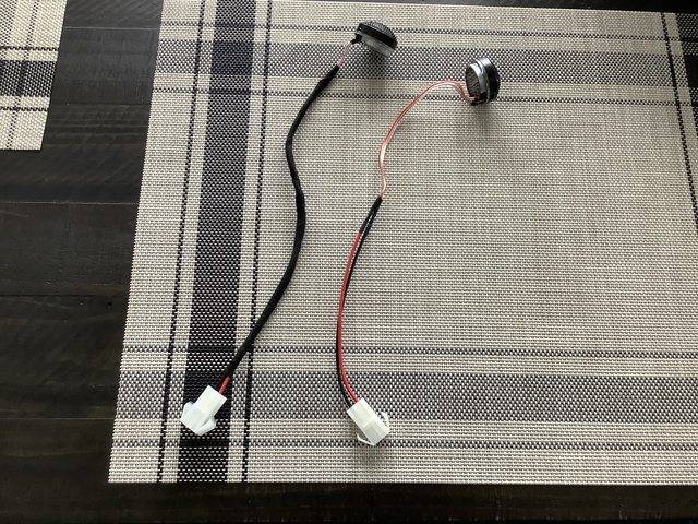

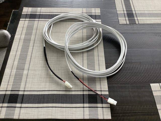

I don’t have any experience with that specific tweeter, but I can share what I encountered when installing Hertz 24.3 tweeters in my ā€˜19 Bullitt A-pillars. This specific tweeter does fit nicely in the stock location behind the factory grill, although you will need a way to secure it, as it is not a tight fit. I used 5 minute epoxy to secure the Hertz tweeter ring inside of the stock mount and let it dry for two days. When I went back to press the tweeter into the Hertz ring, the epoxy failed to hold to the stock tweeter mount and left a big mess. Long story stop, I ended up ordering a new set of A-pillar covers and tweeter rings. This time around I will snap the tweeter into its ring first and then use a hot glue gun to secure it to the stock mount, as it will be less messy and hopefully hold just fine. As for harnesses, I soldered Molex connectors to my new speaker wire to make them plug and play.
