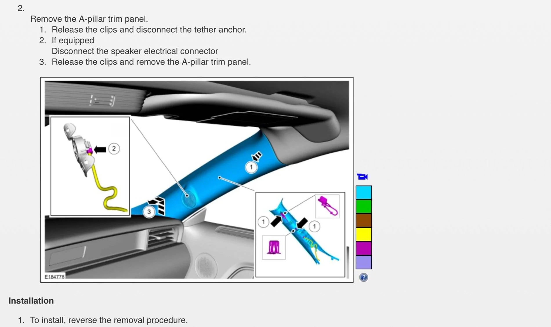

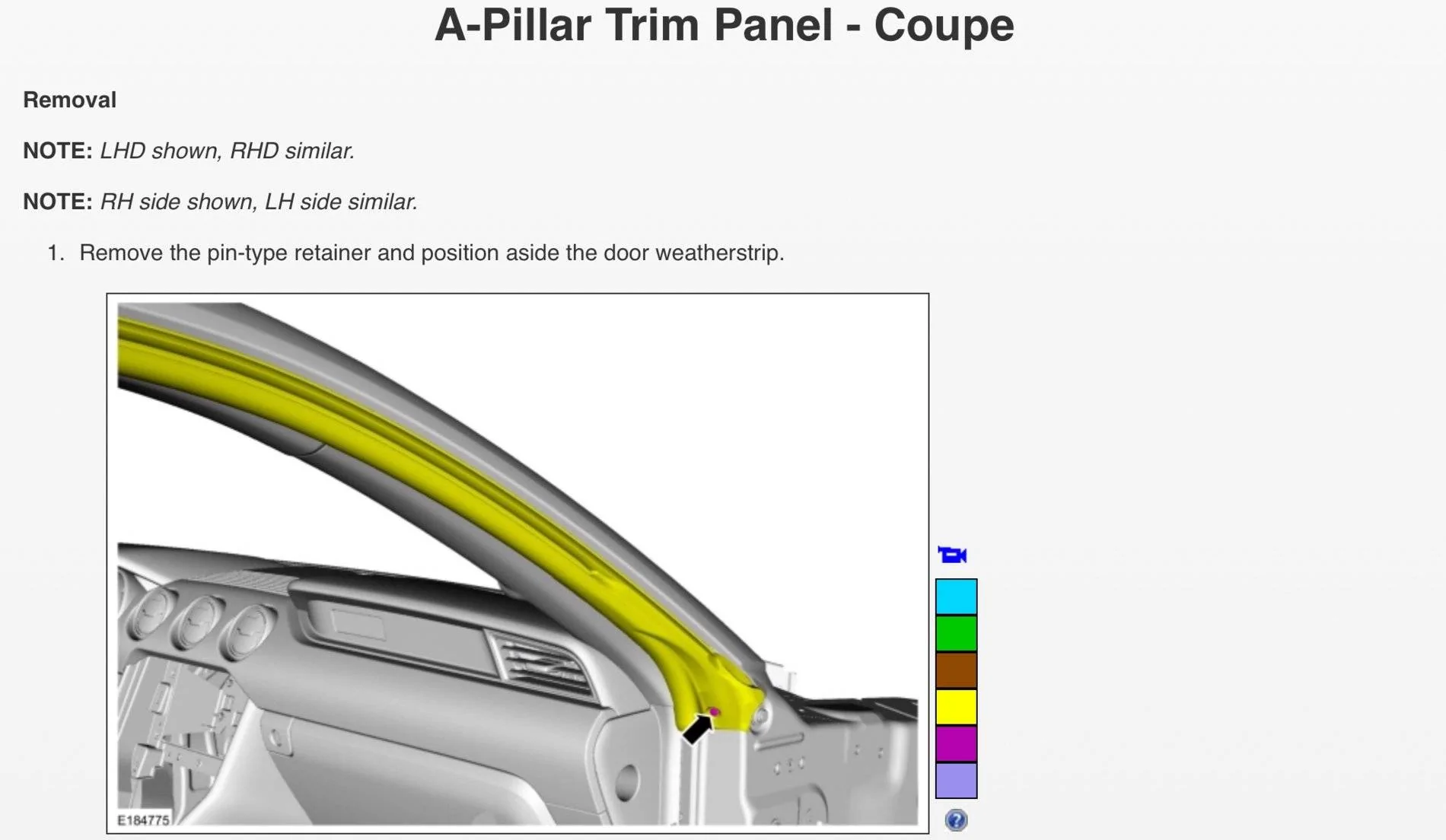

Today I tried tackling another step in my stereo upgrade and started to install the new tweeters in the A pillars. Got the drivers side off without a problem. Passenger side was being difficult. When it finally let go, my head was in the way. Ended up taking a chunk of skin off and now have a 1 inch bloddy scrape across the middle of my forehead. Hurt like hell. Should have stopped there. Because that was a sign. Got the tweeters into the mounting holes successfully. But now I can't get the A pillars to back in. Unknowingly bent the tab that goes into the slot up by the most forward part of the dash so many times that it will never go in that hole again. It's no longer stiff enough to engage with the slot. I will likely need a new A pillar trim or might have to get creative and try to repair the tab with some JB weld.
Got pretty fed up with the ordeal and had to walk away.
What the hell is the secret to get that sunnuvabiotch back in? Looking for suggestions before I ruin another A pillar.
