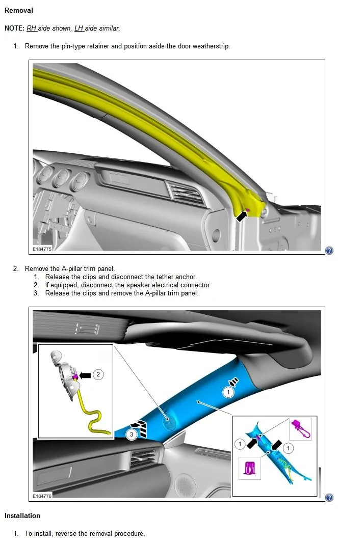

Hey man,
I removed the A-pillar for routing my dash cam USB cable. I wrote up a guide how to do this, so I will just quote what I wrote:
"Next, remove the A-pillar trim piece. Grab the piece at the top of the A-pillar by the window and also on the other side under the rubber weather guard, pull it down and slightly towards the interior of the car. I think there are only two clips that hold this piece (based on the picture below, I do not remember). Once those two clips pop out, do not pull the trip piece down further. There is this plastic "cable" thing attached to it and, if you have premium sound, the tweeter cable. Disconnect the plastic "cable" and the speaker cable by pressing down on the clip, and then slide the trim piece towards you since there are two hooks towards the bottom of the piece that attach to the dash."
Picture of the piece removed is here: http://i.imgur.com/8apZ8gF.jpg

Here's the procedure for the Coupe.
