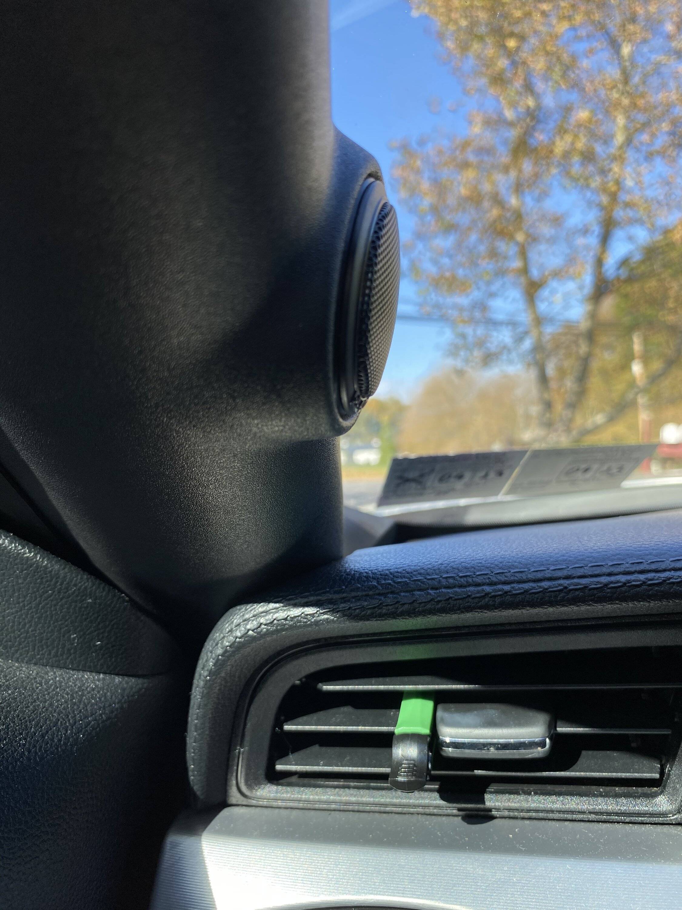

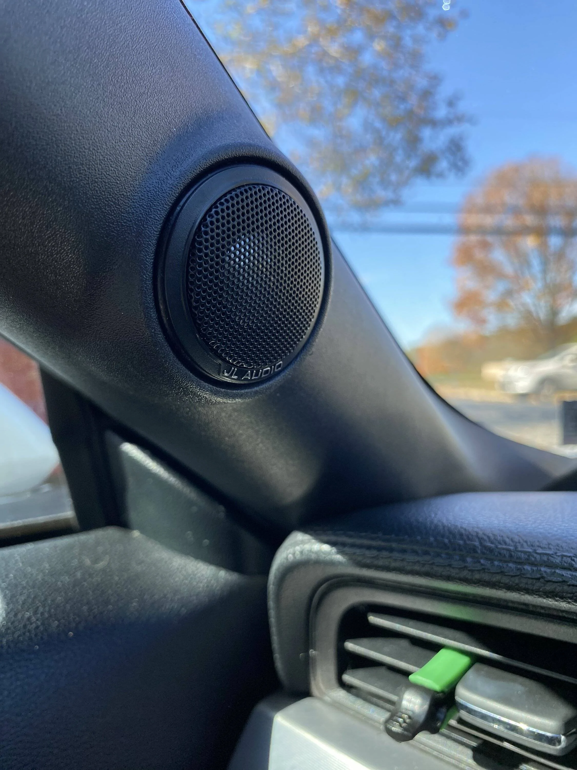

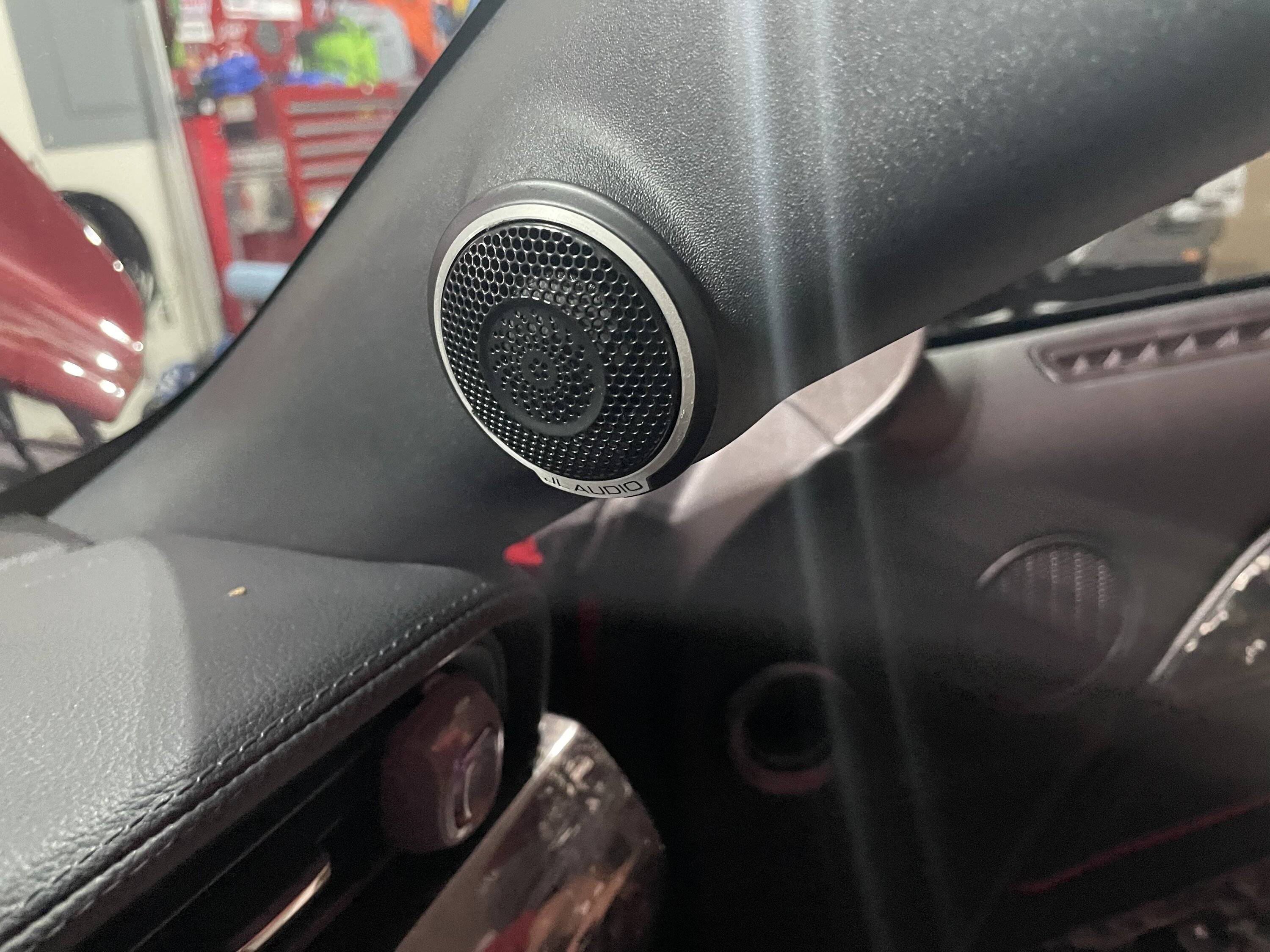

The tweeter replacement was the easiest replacement (I haven’t replaced the 3.5s yet). I can see how it can be really frustrating. I think people might try to get the lowest clip on the wrong side of its mate on the dash. It does take patience. I went with the JL C1-075ct. I added rubber o-rings (1.5” ID and 1.75” OD and 1/8” high) behind them to make them perfectly flush and airtight. No glue or increasing the opening size. The stock mount did need to get dremeled out. The mounting kit for the JLs is literally perfect for this application. I noticed- unless mistaken- the polarity of the stock tweeters was opposite all other speakers in the car. I switched the polarity of the JLs to match the other speakers.

Nice work! They look like they belong right where they are.

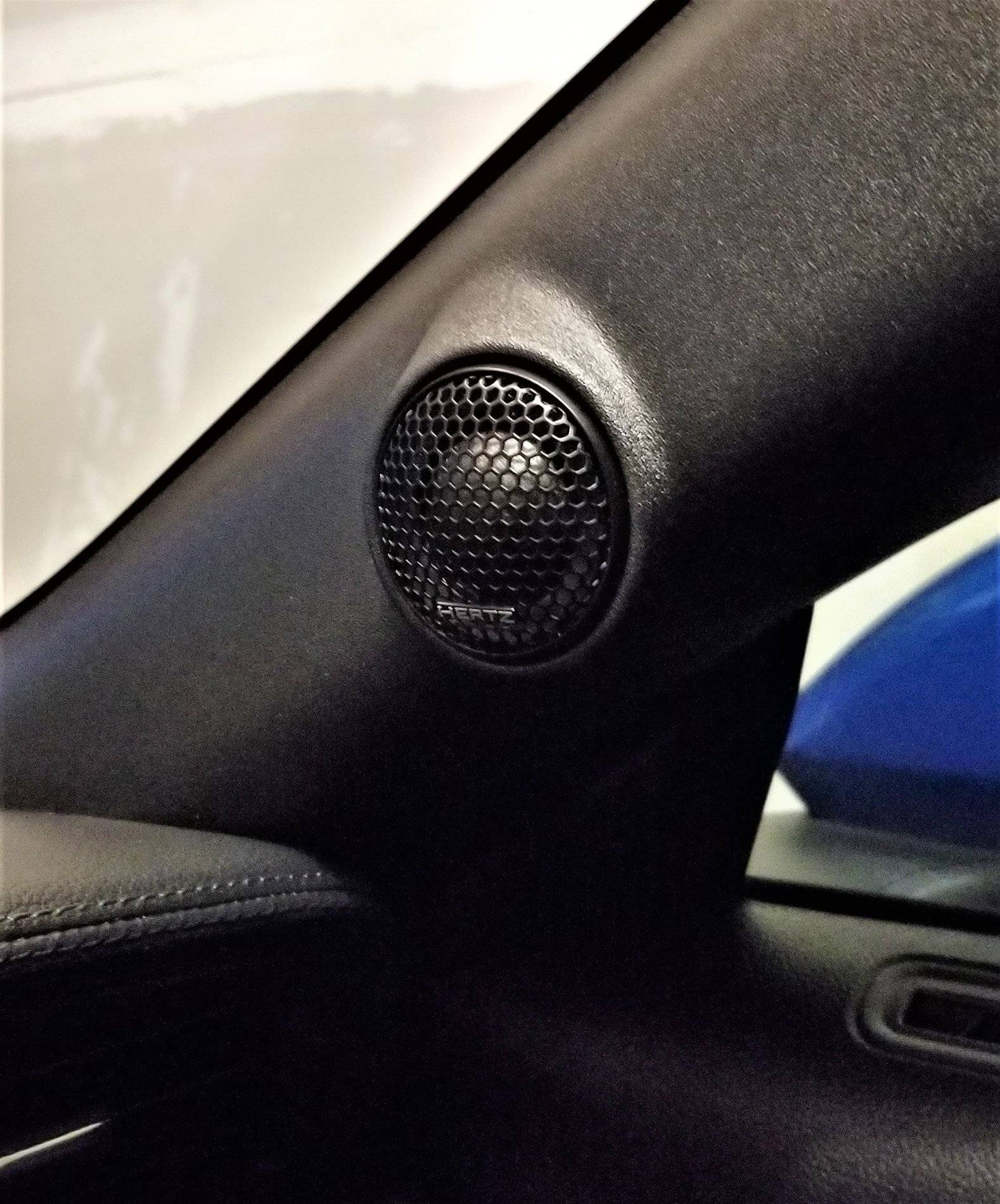

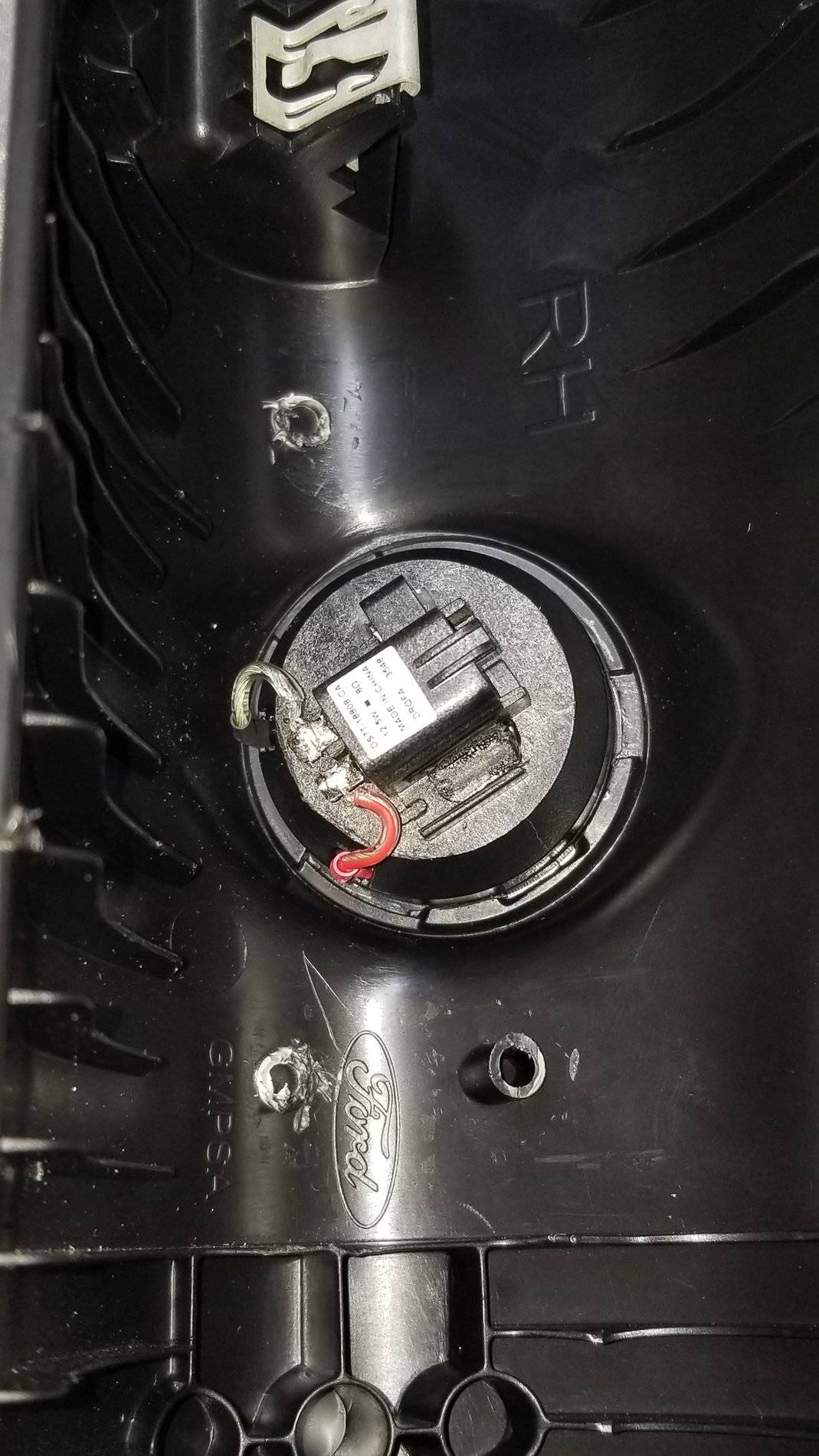

Removed the factory midrange it sounded like garbage. Installed Hertz 2-way Mile pro MP165P.3 component set. The tweeters fit perfect after you cut the OEM tweeter out, open the hole a little larger so you have a tight fit and just press it in. I used a knife to cut the connector off the back of the OEM tweeter trimmed up the plastic and epoxies it to the back of the MP25.3 tweeter. If I were to do it again I would mount the connector so it points downward toward the dash, not upward and adjust the wire length. Had to re-install the A pillar then install the tweeter last. This worked great though and I can remove the tweeter with a trim tool without taking the A pillar off again. The A pillar is a complete bitch to re-install.

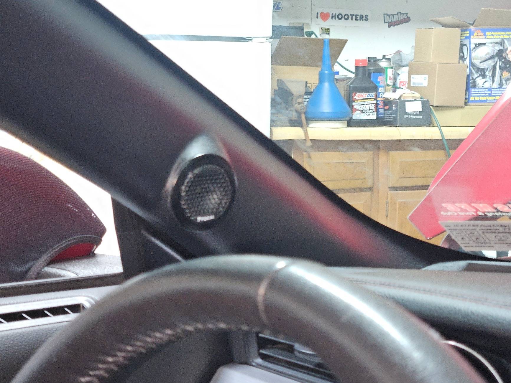

Wow!! That looks really clean. Great job. I flush mounted Focal TN43's there.
