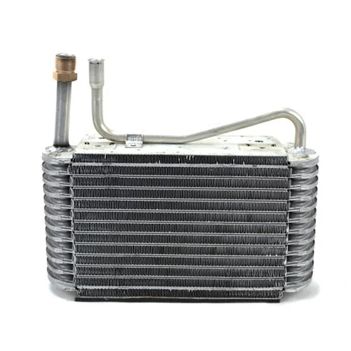

Looks like it would have to be disassembled to see the actual failure point.
Couldn't find a photo of an S550 AC evaporator, but it would look similar to this on from an older Mustang.
My bet is the welds crack and start leaking over time from all the thermal cycling. Automotive AC design shouldn't be rocket science these days since it's been around forever. And the fact that there's been multiple revised evaporators make it look like the 3 Stooges are working in the AC organization.

HoosierDaddy
Jan 2, 2016
266
4,711
9,102
Randy
Have to agree with that. I can understand how a flaw can get thru to production but its unbelievable how it takes multiple tries to fix it!
Here's a video of a S197 evap core removal. They disassemble the box. The S550 is basically the same.
