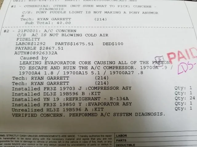

The ESP approved the replacement of the compressor and evap. Good thing! It's a $100 deductible.

Got my mustang back. The evap number they installed is FR3Z 19850 Y

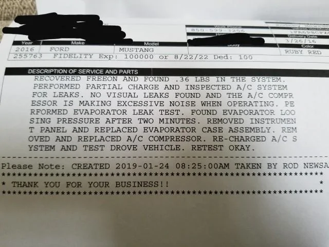

Here is my receipt:

Hang on to it because the parts have a 1yr warranty. Glad to hear its fixed, just in time for summer.

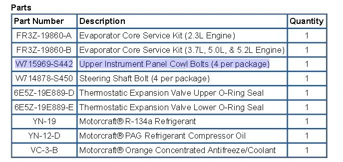

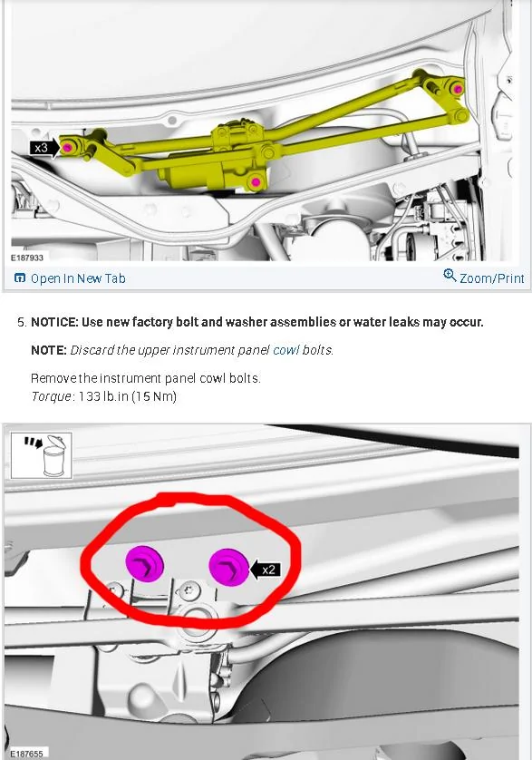

Anyone know what the part number is for the 2 bolts with the gaskets under the cowl? The factory gasket look weird and not too confident on the rtv.
