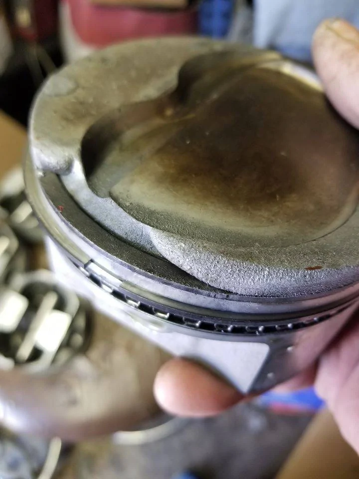

I wouldn't. Here's a result of running 87 octane while hooning on the street. Warmer ambient temps, higher IAT's, this is usually the end result on 'but it can run on 87' engines. Broke from knock, melted from higher combustion temp 87. We took his engine apart cause of oil fouling 2 plugs. He didn't here a damn thing, and no indication other then the fouling.

Mustave hooned hard! Also how long was he running 87 in the mf’er
All spring (coolish temps). Didn't hoon hard, I think he only did one WOT run for a few seconds. That's all it took.
