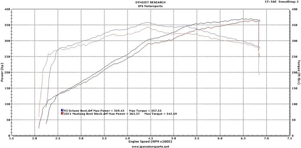

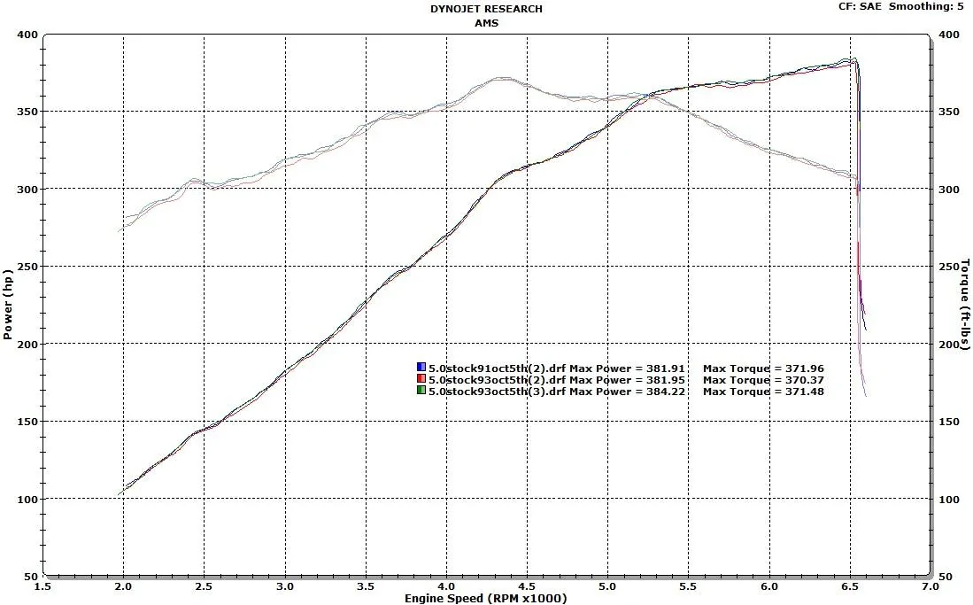

Take it for what it's worth. 2 stock 2011-2014 Mustang GT dynos. 91 vs 93 and 87 vs 93.
91 vs 93: Final run it made like 3 rwhp more and 0 rwtq more than the two best 91 octane runs.
87 vs 93: 6 RWHP peak difference. Not that much, but look at the difference in the mid range, especially 4500-6000 rpm. Looks to be ~20 RWHP difference in places (corresponding increase in torque, of course)
5.0 GT Stock dynos 91 octane vs 93 octane
First two runs the car made essentially NO more power.
Then on the third and final run it made like 3 rwhp more and 0 rwtq more than the two best 91 octane runs.
They probably put in the ability to adjust up to 91.5-92 on the high rpm range which gives it a couple extra hp but no additional torque.
I think we can safely say using 93 octane instead of 91 octane gains you 3-4 hp up in the higher rpms for a bit, but as you can see it's not sustained over a large rpm range. So it just may be an anomaly that it made the additional 3 rwhp at the peak.
So 91 octane state people don't need to feel bad, without a tune, guys in 93 octane states aren't getting really any more power out of their stock 5.0's
87 vs 93 Octane Dyno Graph
Below is a dyno graph showing the difference between 87 octane and 93 octane. According to the shop, no other changes were made to the car/tune/etc. Similar weather for both passes, car at normal operating temperatures.
Note: 6 RWHP peak difference. Not that much, but look at the difference in the mid range, especially 4500-6000 rpm. Looks to be ~20 RWHP difference in places (corresponding increase in torque, of course).
This is good evidence.
I assume the difference between 87 and 91 octane is similar to that between 87 and 93 considering how close it is between 91 and 93 from the first chart. This means about ~10-20 ft-lb torque between 2500-5000. Not too small a difference.
