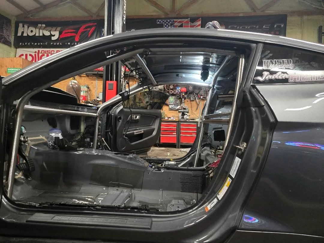

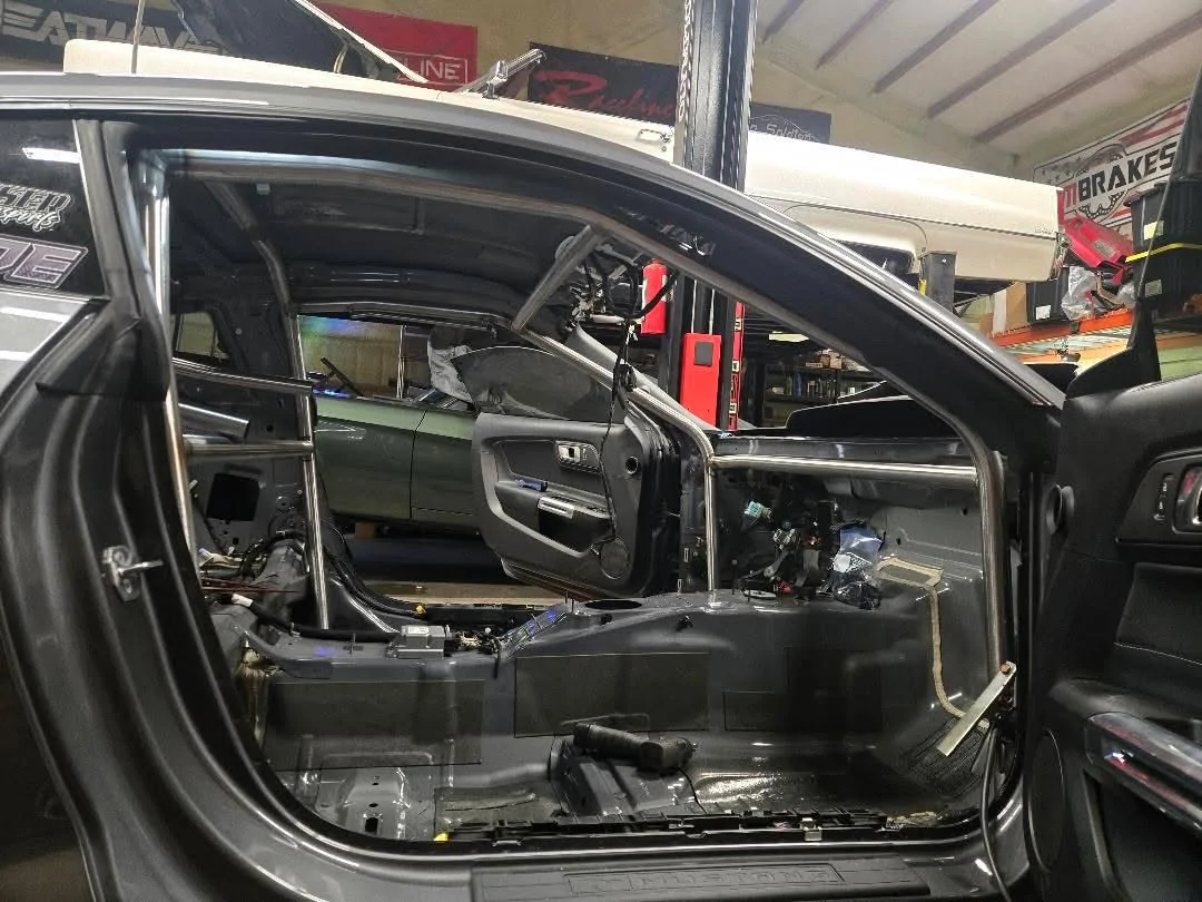

Progress so far.
NGOT8R
Jul 19, 2020
154
9,400
7,897
Adrian
2019 Bullitt
Everything is looking great so far! Are you going to leave the carpet out of it and maybe spray the floor with bed liner to make it durable to foot traffic when getting in and out of it? They can also add color to it now, so you should be able to find a close match to the exterior.
Carpet, headliner etc….is all going back in.

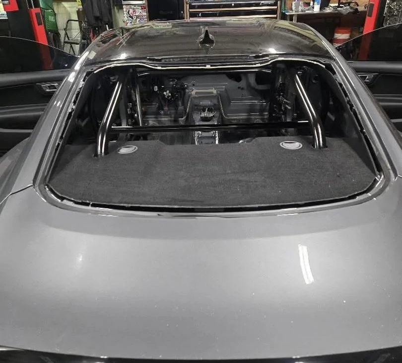

Getting painted…

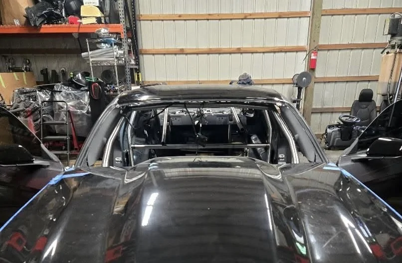

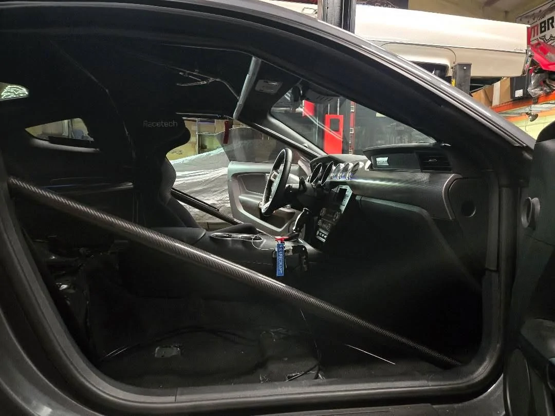

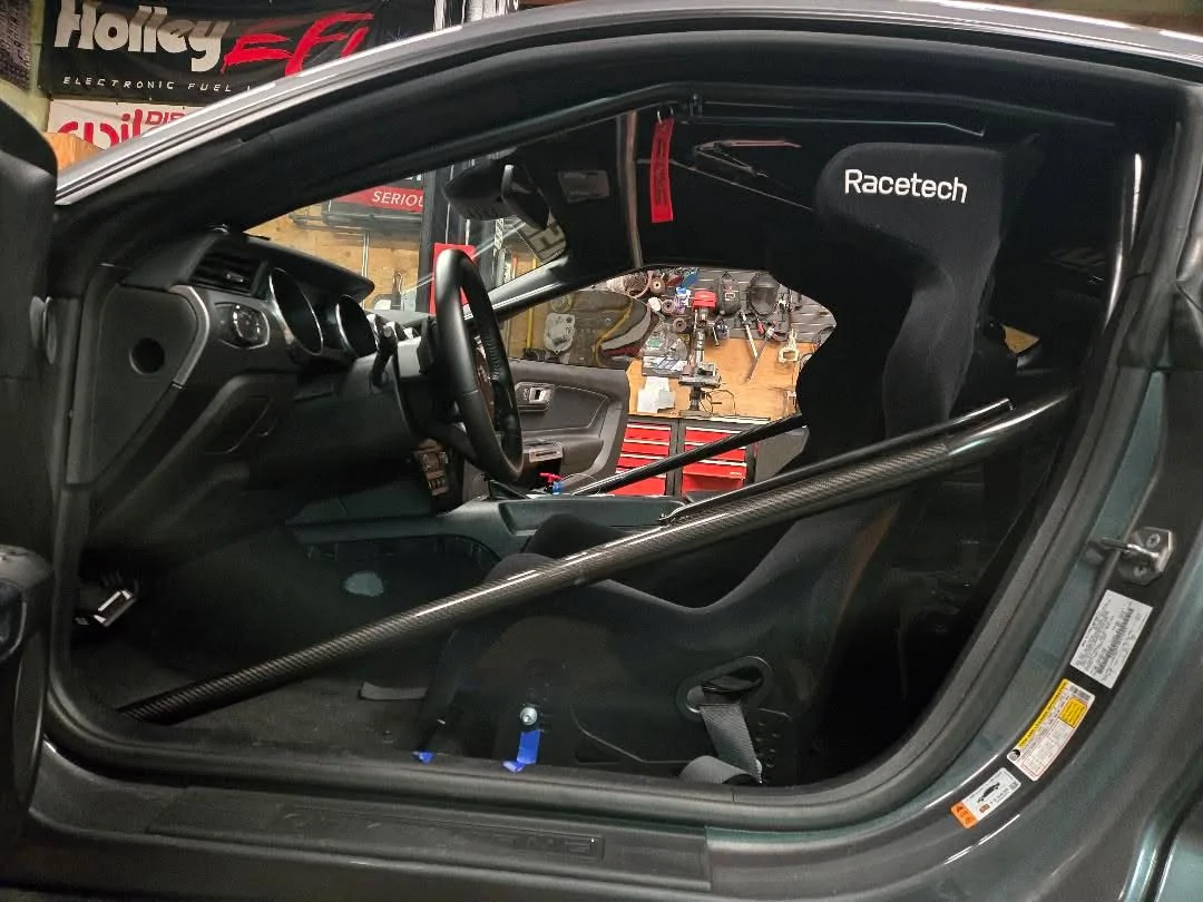

Almost at the finish line.
NGOT8R
Jul 19, 2020
154
9,400
7,897
Adrian
2019 Bullitt
She’s lookin’ really good my friend! Did your fabricator make provisions for a parachute lever on the cage and if so, is a chute being installed during this process?

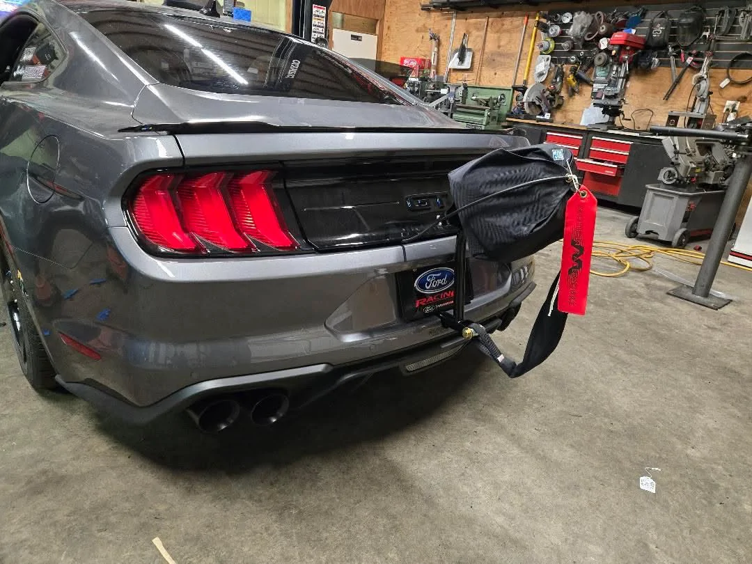

It’s all in already…you can see the handle in the pic….its up top. That being said, the parachute is removable and won’t be on the car until it’s supercharged.
It looks awesome! I’ll circle back later to talk to you some more about the chute. I have some of the components for mine, but I’d like more details and closeup pics with the passthrough for the cable and routing inside. Thanks

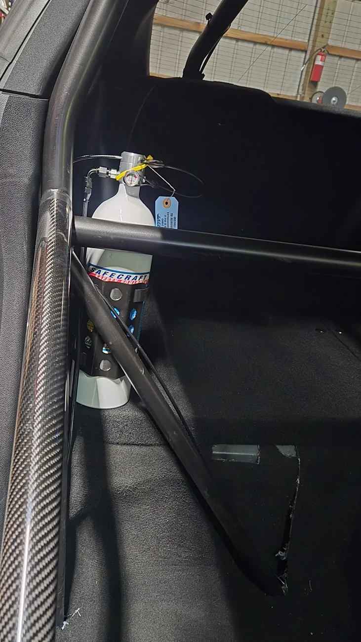

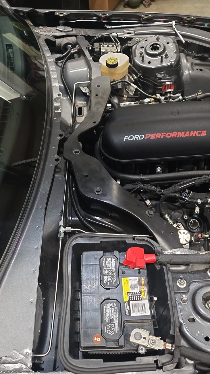

Fire suppression plumbing is all in.
NGOT8R
Jul 19, 2020
154
9,400
7,897
Adrian
2019 Bullitt
Looks great! I see the 1up Fab mount for the fire suppression system hiding there on the passenger side. I have one of those as well for my parachute lever.

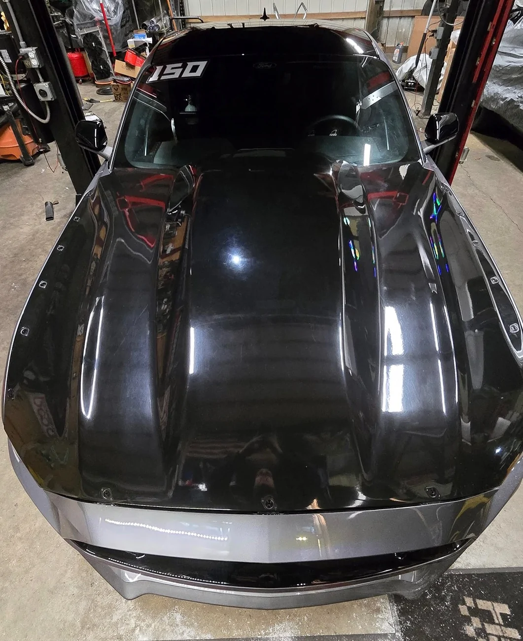

Pin-on hood was done today as well.
