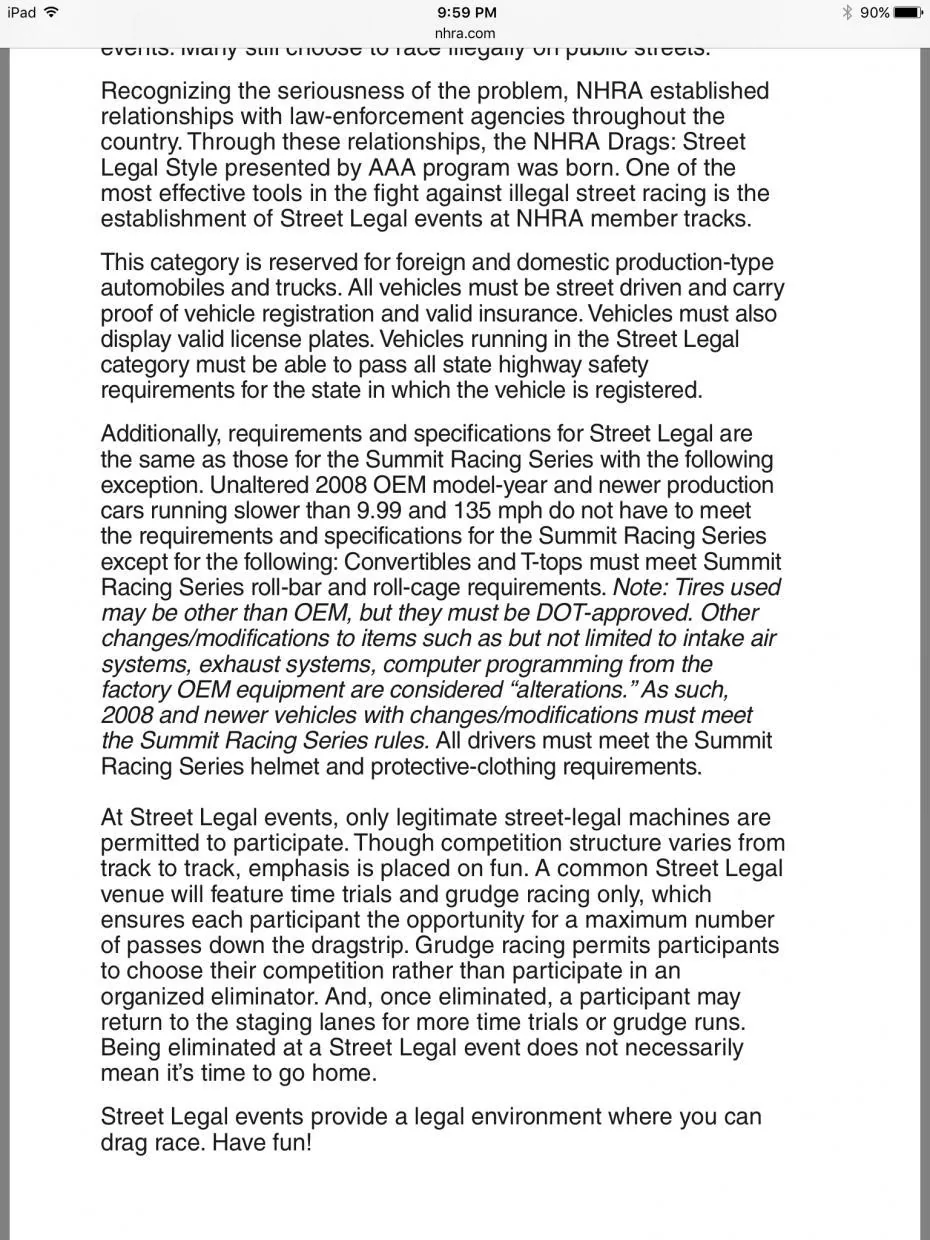

A NHRA removable harness cross bar is not legal. Forget putting your kids in the back seat.
1320'
Aug 26, 2014
3,758
1,616
Medford,Oregon
2011 Avenger...sadly
Yup...modifying your car down into the 10 second range has it's consequences...
9.99? Welcome to the land of chassis certs, license and cages.

You could fight, that, he doesnt read too good. I agree, it sucks.
It is also what he feels comfortable at his strip since he has liability if you get injured at his premise.
