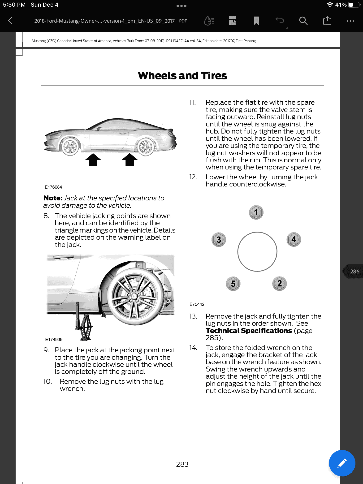

Yes, people keep saying this, and I tend to agree. And yet if you look in the owner’s manual, the illustration for the section on using the spare shows it being mounted on the rear.
Just remember, the mechanical engineers aren't the ones writing the manuals.
True, but then again if you blow out the diff after using the spare on the rear axle within warranty, Ford wouldn’t be able to claim that it was your fault and not cover it. But I guess chances are you’d only reduce the lifespan and not blow it up.
