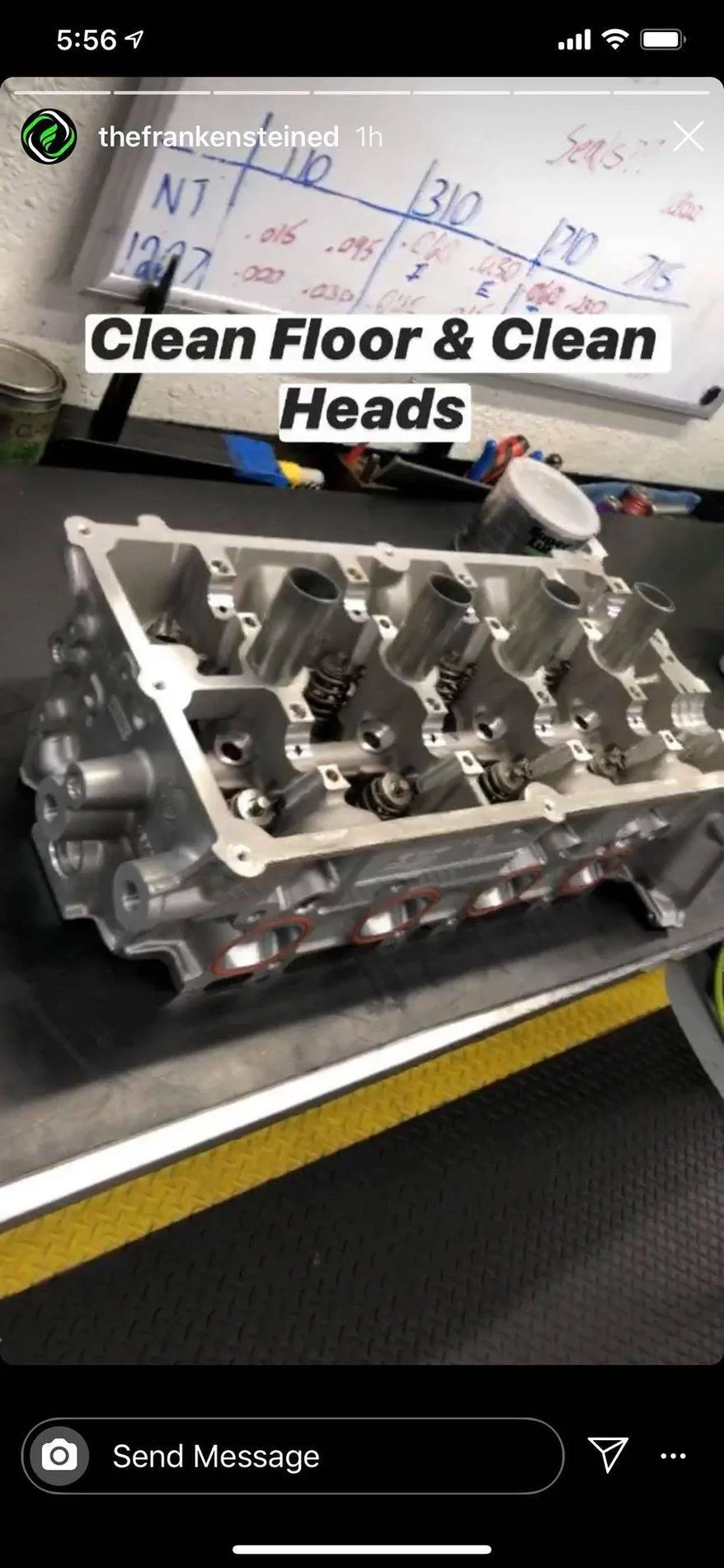

You boys ready to see some of that sauce here soon? :punch:
Definitely better machining work than RGR did on my heads. FED looks like they do great work!

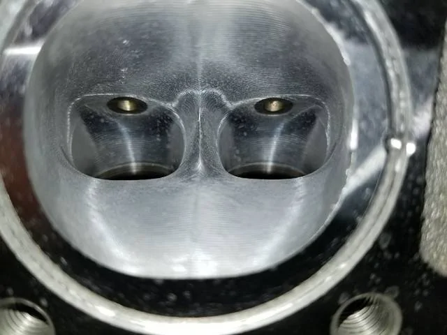

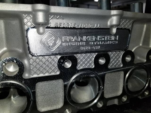

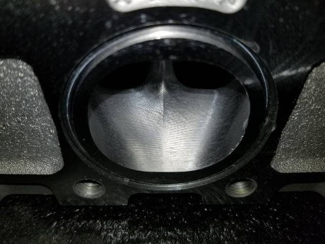

Well boys, as promised here they are, fresh from Frankenstein Engine Dynamics:

Stay tuned for more information as we get these installed on the car and get it tuned.

Can you tell us more about the intake manifold? That's a nice piece of work!
