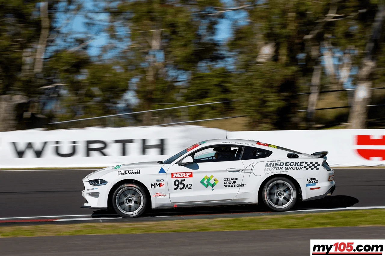

I was worried about that in my 2020 GT. However, after fitting the very inexpensive Steeda transmission bushing and changing the oil out for Castrol Syntax, it's now that much better. And, there's more. A mustang FN GT just one its class in basically a stock showroom spec 6 hour race at our gruelling 6.2 Km Bathurst circuit in Australia. I downloaded the rules for this car and this race, and was pleasantly surprised. Its homologation included the standard Getrag MT82. Suffice to say, cooling was free and legal, and that was added, but still. An interesting test!
