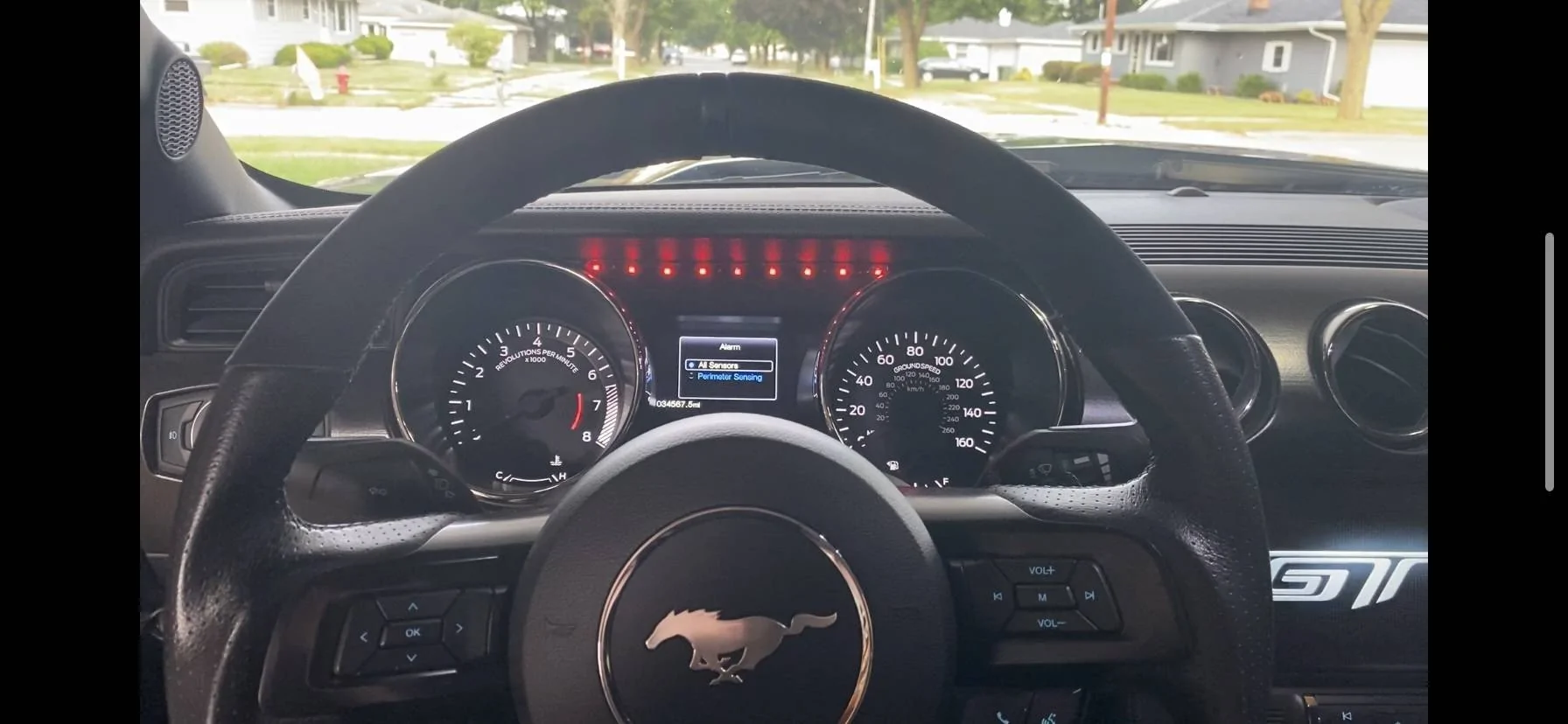

Aftermarket shift light or the one in Track Apps? My shift light only goes to 7200 in Track Apps.

Any pics of how you have the light mounted? I have a WOT Box too and should be able to easily add one. I may look into this myself.
