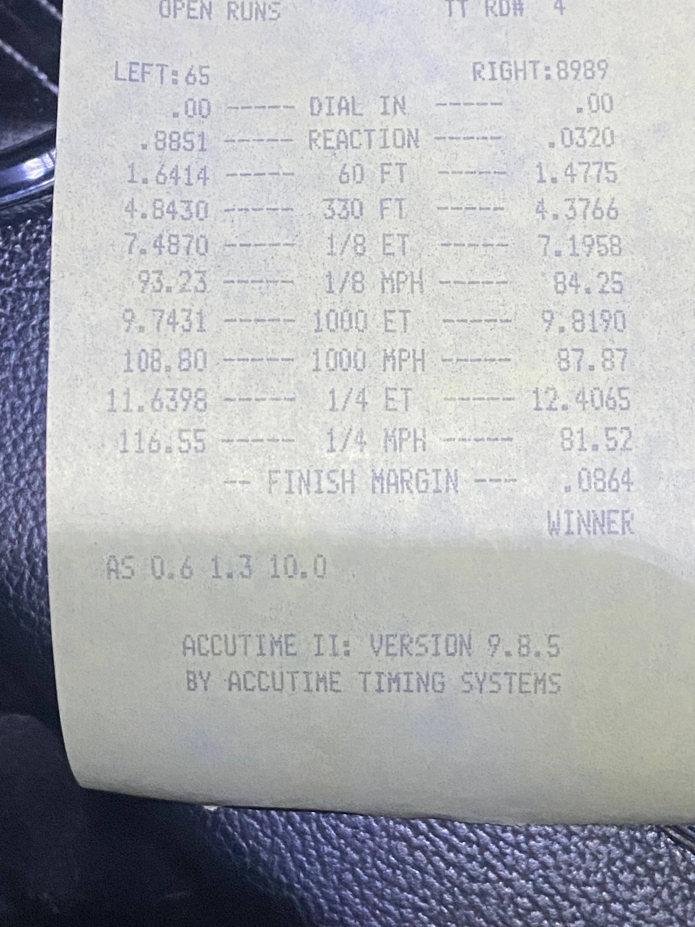

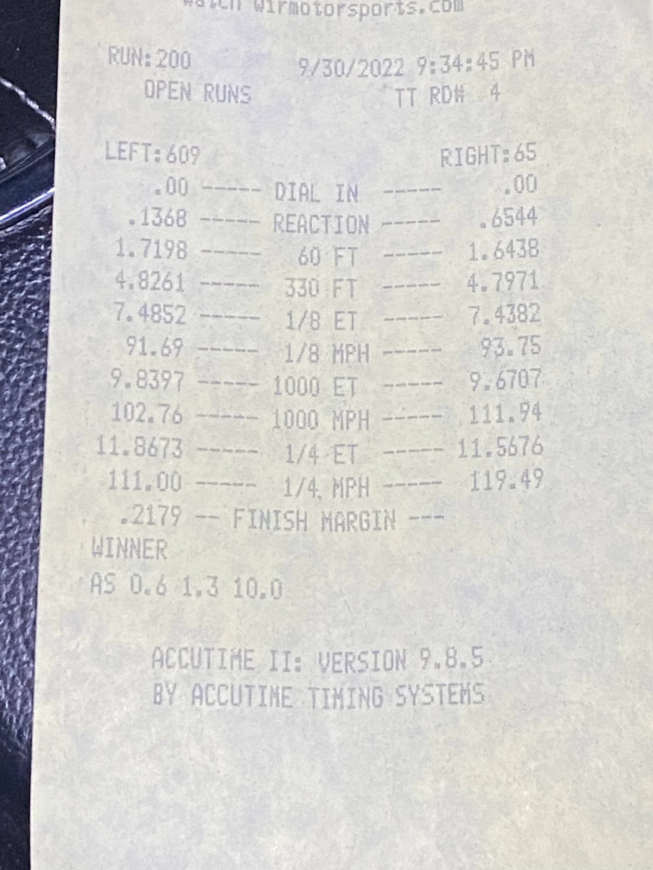

looking for advice based off this video. viking rear shocks set 12/12 times between 1.62-1.64 last night.

Weight transfer looked good. Maybe adjust the rebound to 14 so it does not throw the weight forward so quickly. I forget off the top of my head maybe try 12/14 then 12/10 (or 12/11).
It squatted really well but it looked like it threw it forward a bit too quickly.

yea it seems to squat and pop right back up. tried more comp and the made 60 worse. didn’t get a chance to try more rebound.

I would leave the compression alone. It is squatting hard, that is good.
It needs to stay like that for a bit longer. But looking at your mod list you may not have the power needed to keep the g force pushing the car down.
This might be weird sounding but I would try a 4/10 (compression, rebound) and see what it does. That is uniperformances recommended settings on less than 600 hp cars

Rear Tire pressure ?
Starting line track temperature ?
I slowed down the video play speed. Some good wheel spin going on shortly after the launch.

What was your ET and MPH on those 1.6 short times?

18psi. think it was between 50-60 last night air temp if you mean ground no clue

@PickleGT, those are some nice ETs. MPH is good too. What gear did you trap in and what rpm ere you shifting at?

shifting around 7800 running out 3rd gear. 331 rear end 28x10 tire 6 speed manual

D06 slick. tried less it didn’t help 60 and swayed more on the top end
Tried less as in down to 9-12 psi range.
What’s the production date stamp on the rear tires ?
