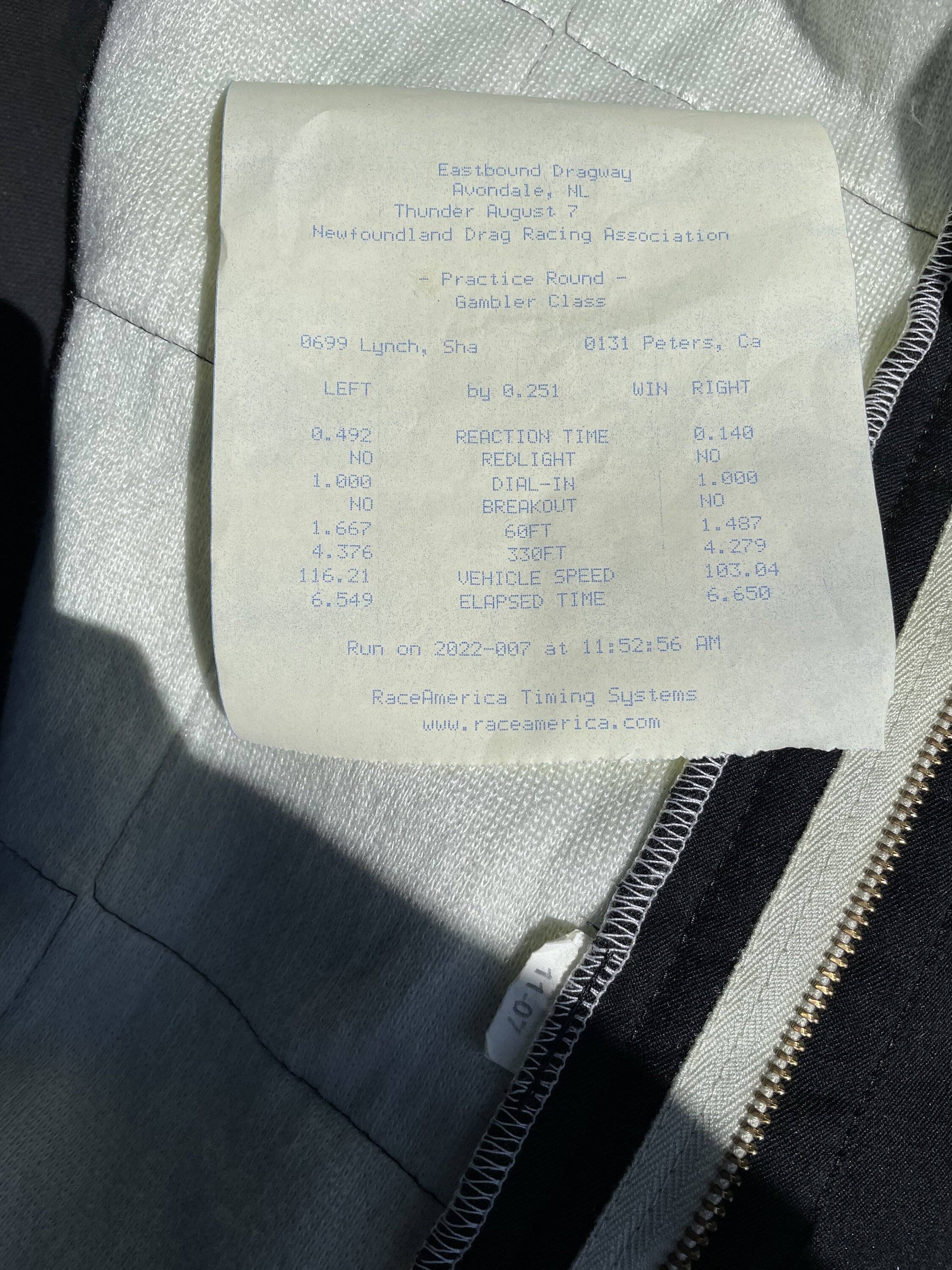

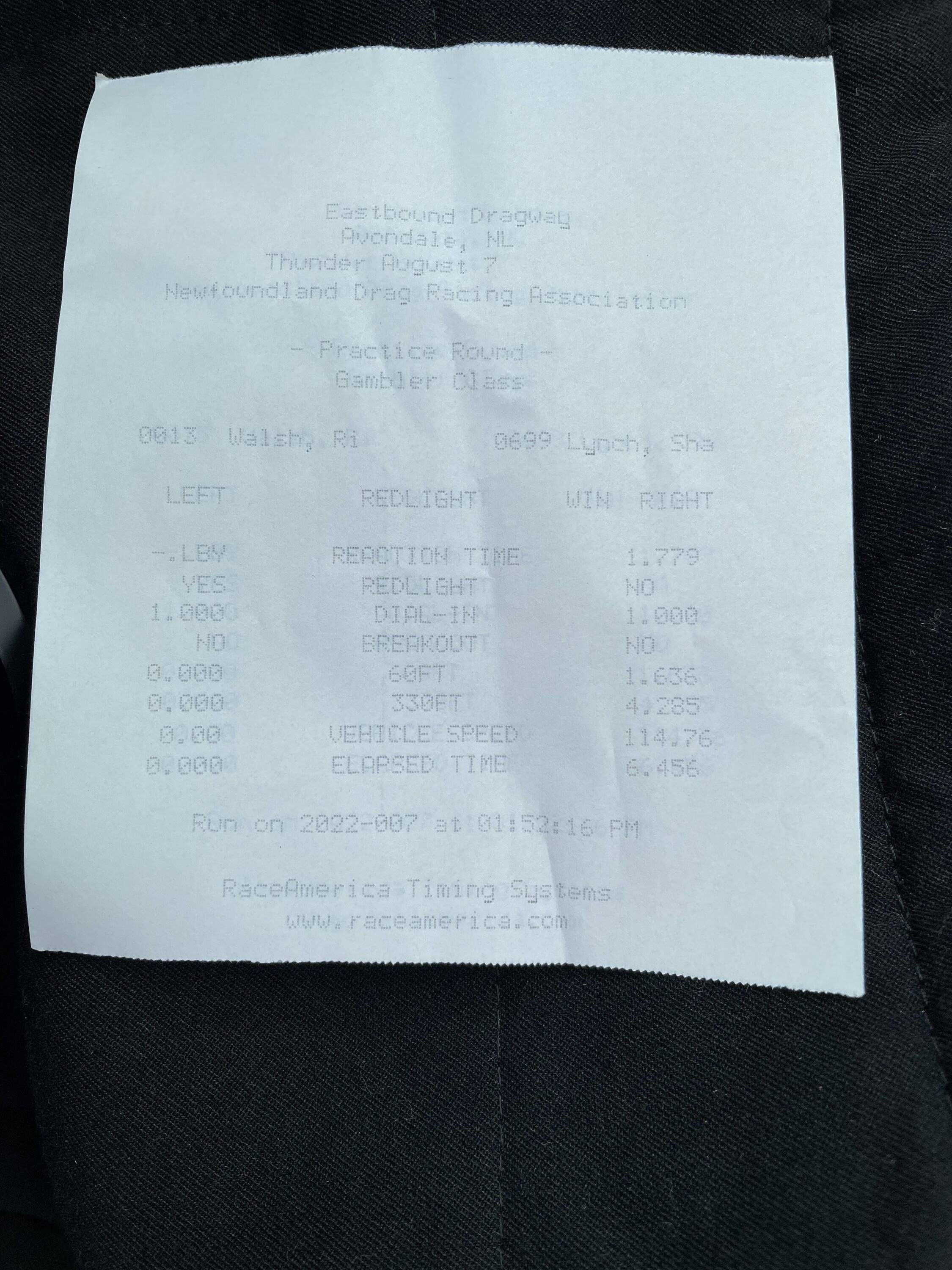

I’m looking for advice on how to get my 60’ down. Fully built E85 Hellion TT with a 6R80 and C02 boost control.
I am running a 305/45R17 ETSR drag radial. 16 psi cold. Full BMR and Kelltrac suspension. Settings is no-prep as our prepped track is essentially as good as a no prep venue.
I left on about 3.5-4 psi and 3000 RPM on the 2-step/transbrake which netted me a 1.6X 60’. This is zero boost on the launch command on the Boost Leash. I added 2 psi dome to my Boost Leash, but a car blew up and I didn’t have enough time to stay around. I figured this setting would put me about 5-6 psi on the launch.
Boost ramp rate was 40 of 50 on my controller.
What would you do next if you had my car? I’ll try it when I get home in September.

Looked good. Just bogged. Definitely seems like a heavy car like mine too. That's why I'm going 3.55's. I'm at 4100lbs.
On those Street R's, you should be able to leave at 7-8psi no problem, maybe a tad more. That should bring the 60' down a bit.

Yeah. The car is almost 4200 lbs race weight with me in the drivers seat. All add more boost next time around.
Would you keep the 2-step RPM the same? 3000 RPM?

Yeah, she's a beefer as well. I would try 3400-3500 on the 2-step and bring boost up a couple psi. It will make the converter flash higher as well. Those tires will hold a LOT.....

I’ll give it a go. I’ll also have my boost ramp rate in at 100%. It was at 80% for that run.
