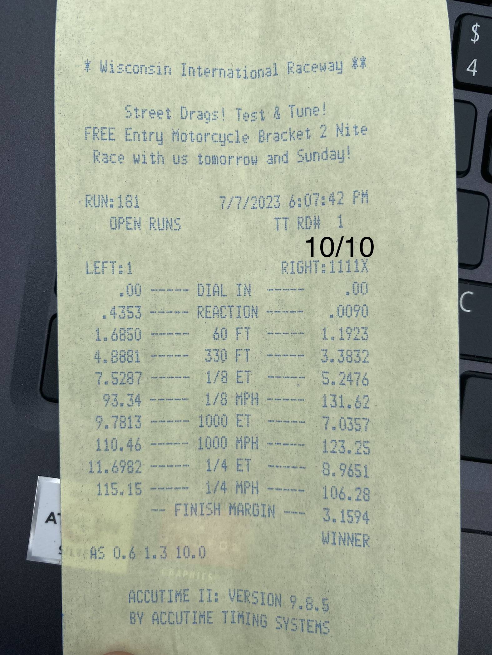

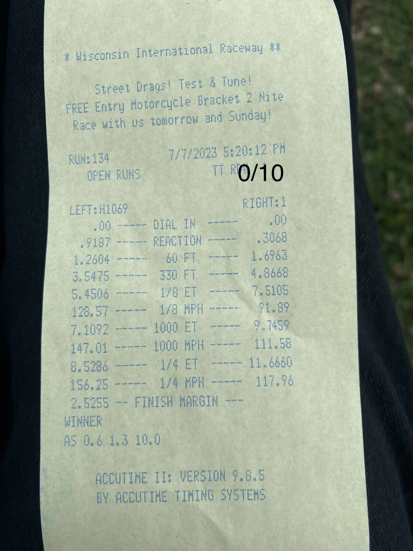

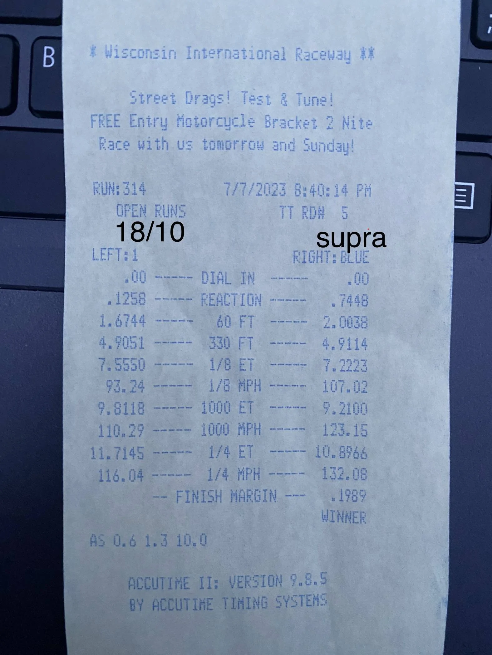

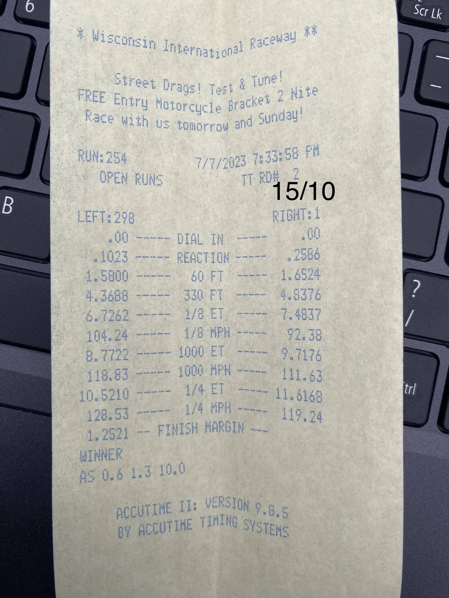

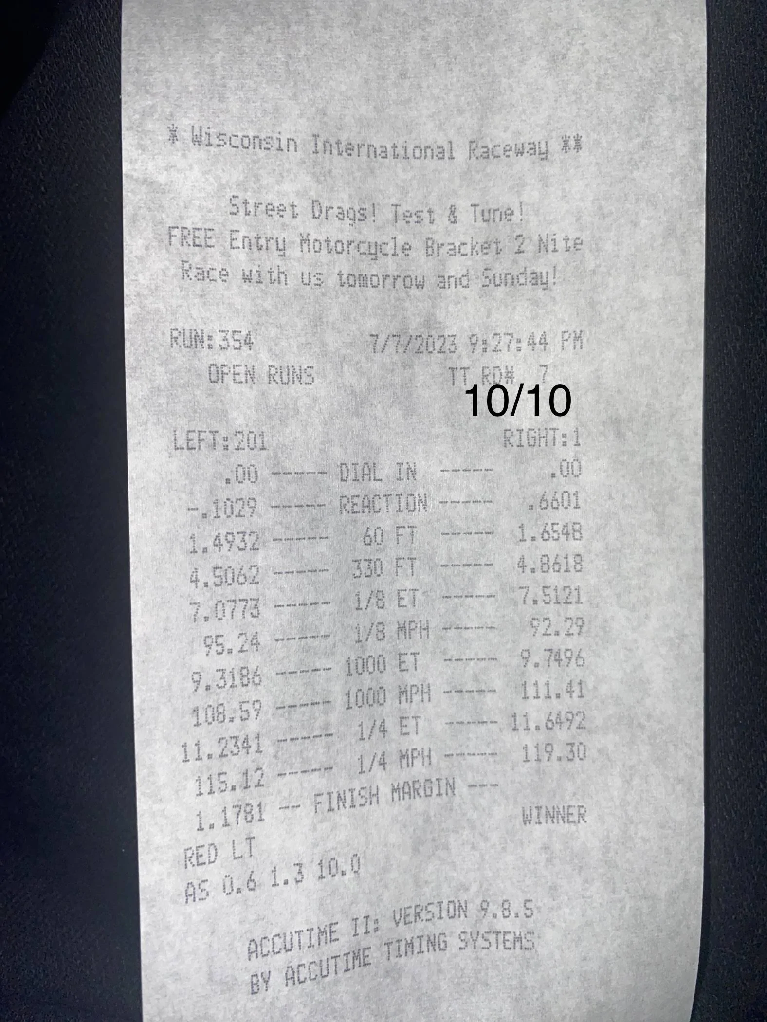

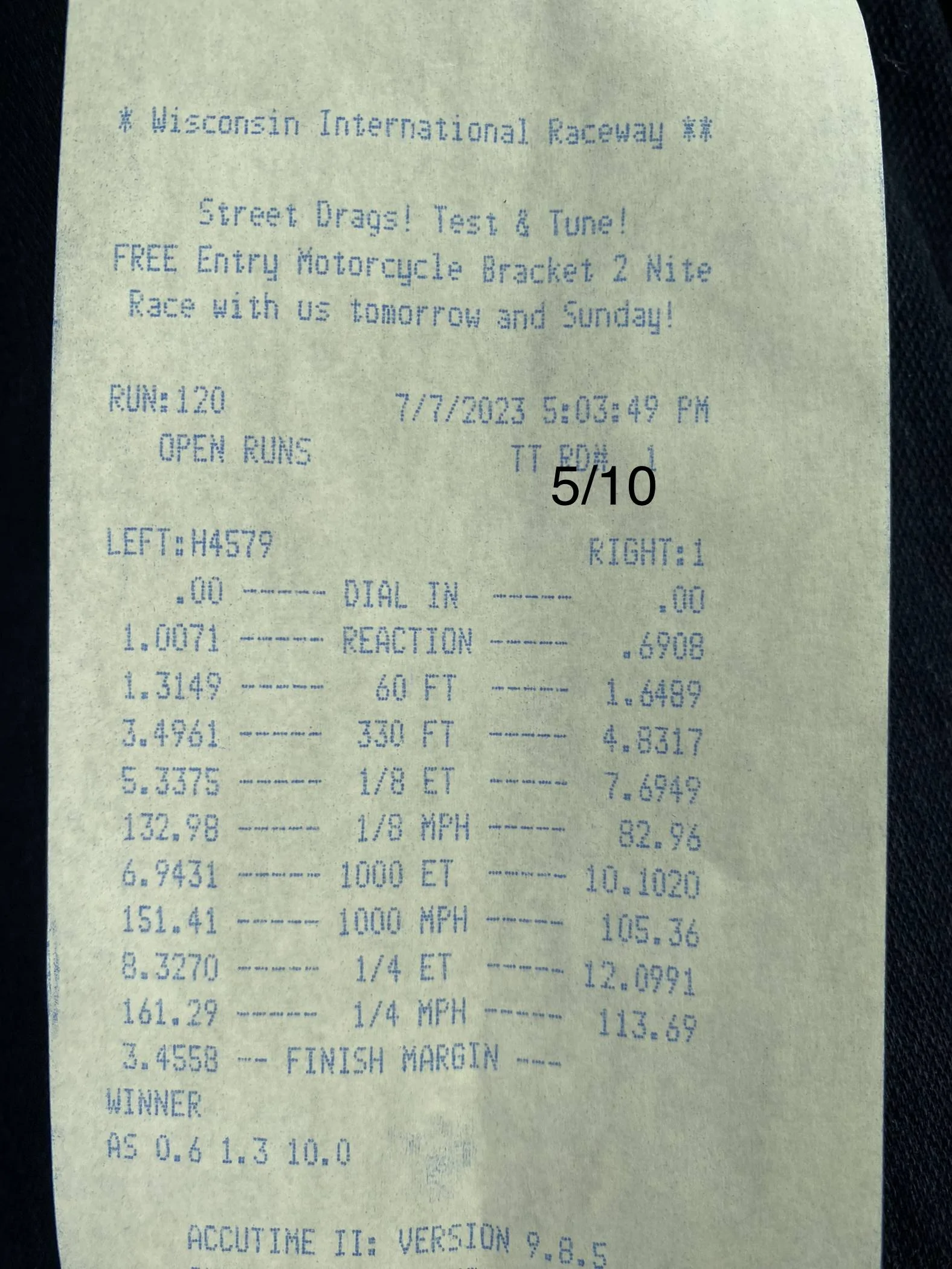

zero progress to report, no good videos, 2000 DA

At least you’re consistent. I’d love to hit those ETs repeatedly like you do. What‘s strange is the different compression settings aren’t really changing the sixty by much at all.
