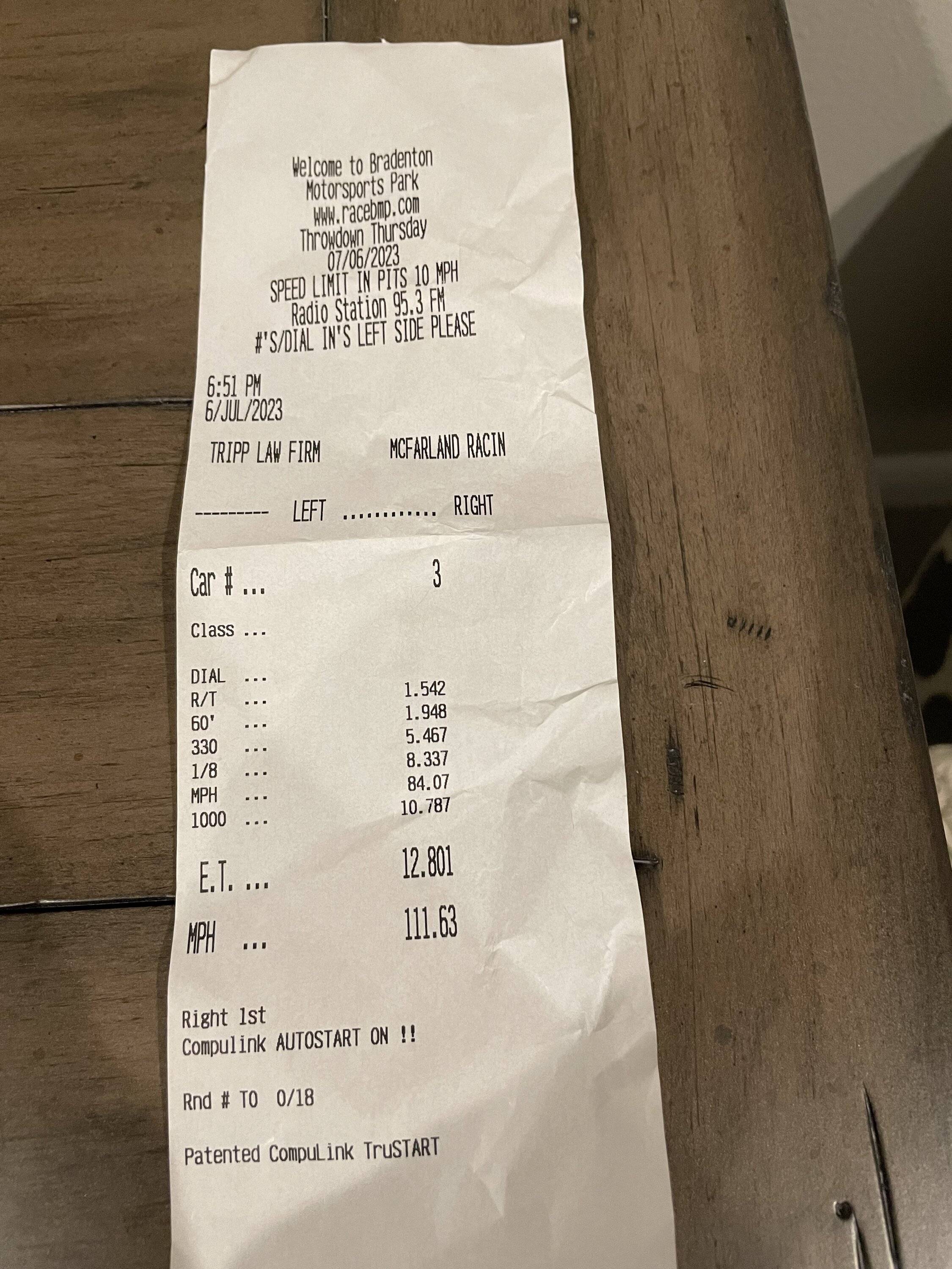

At first I felt like holding the Hitmaster trigger button in my right hand, releasing it at the exact same time that I dump the clutch and then grabbing hold of the shift lever to prepare for the 1-2 shift was a lot, but I’ve actually gotten very used to doing that now.
I feel like my real issue now is, I have yet to achieve proper weight transfer on the launch and therefore, the rear tires are skimming the track and spinning, thus killing my sixty and et.

At least you’re consistent. I’d love to hit those ETs repeatedly like you do. What‘s strange is the different compression settings aren’t really changing the sixty by much at all.
I wen’t back Thursday myself and really don’t have nothing good to report. I pulled into the track in preparation for my first pass and the factory launch control activated to 3000 RPM, even though it was turned off, so I told the starter that I wasn’t going to make a pass and just drove down the track and back to the pits to try and sort out the issue.
I was able to get one pass in and it was really crappy. I stayed in 3rd through the traps. MPH seemed to have increased again after the fuel pump swap though. I left the track afterward and headed home. Viking settings were 6/11 btw.
