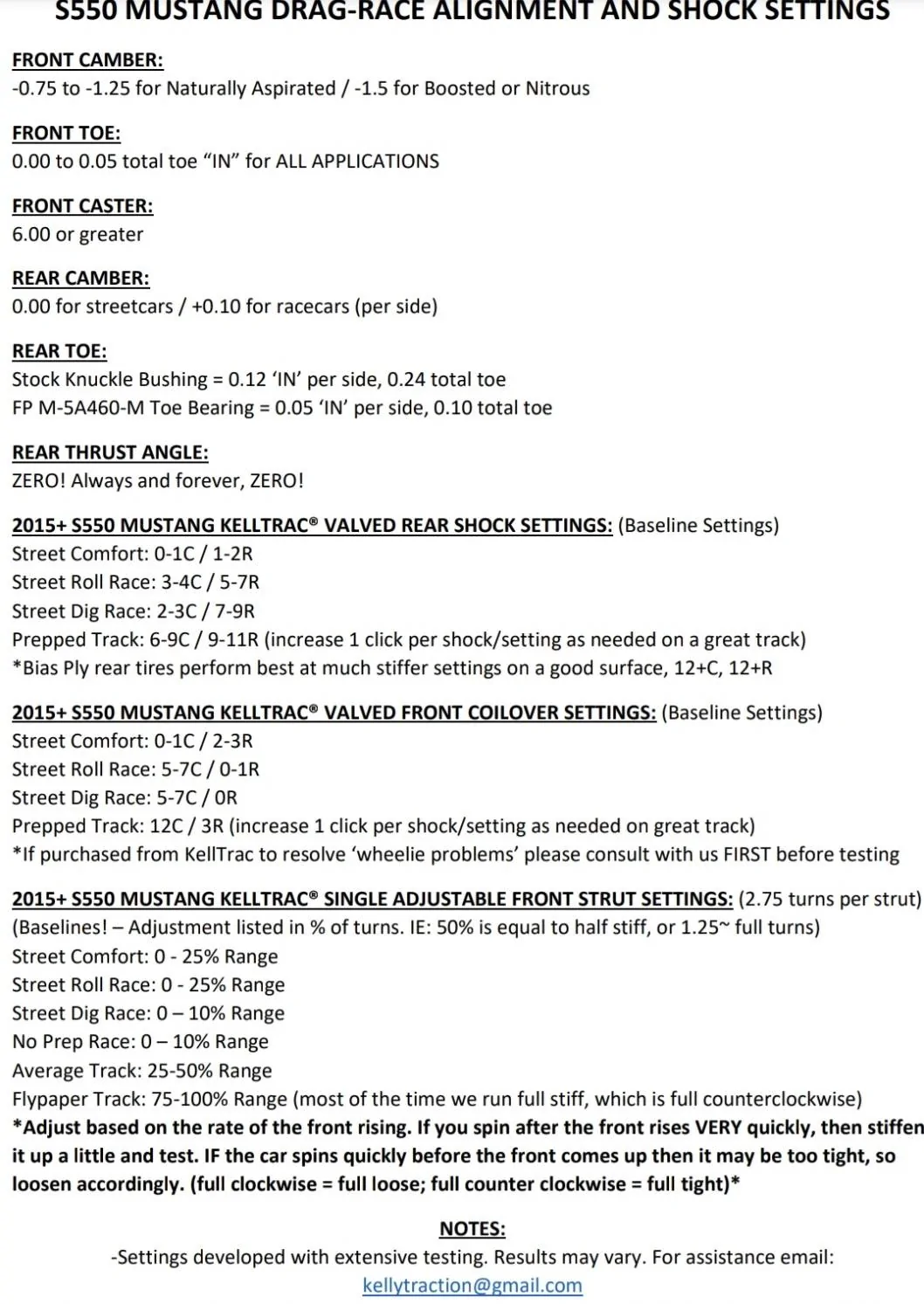

anyone got advice on which way to adjust rear shocks if i’m spinning on the shift?
tried increasing rebound didn’t help

yea those baseline sheets are basically useless and don’t give advise based off scenarios

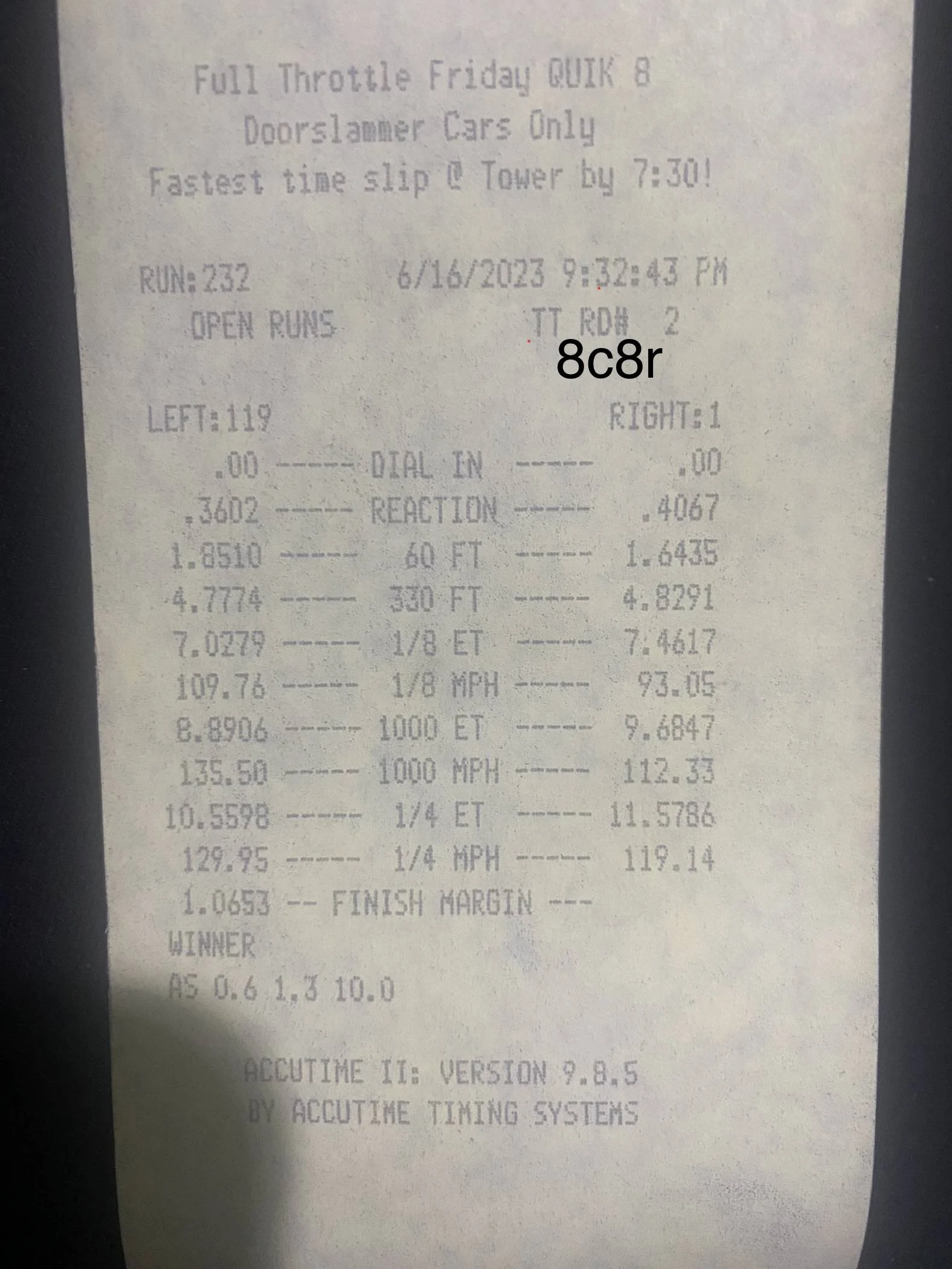

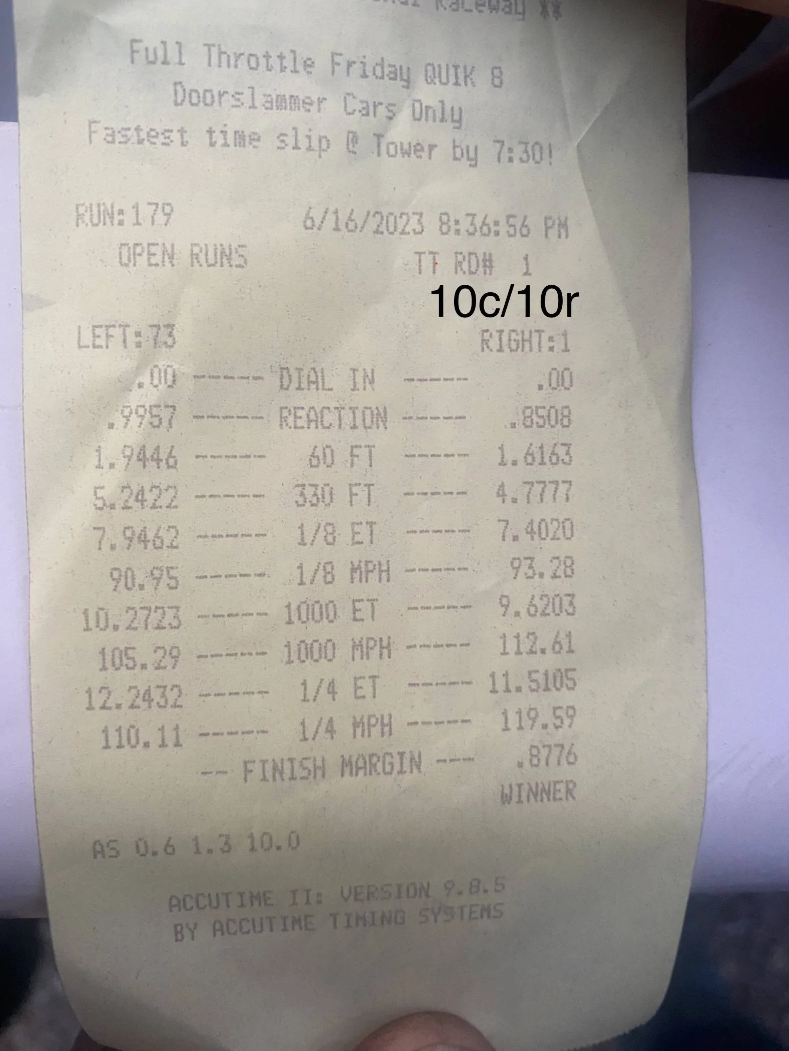

12c16r but the new clutch and other stuff are making this an apples to oranges thing
dropping down to 10c10r and see how it likes that

That could also be some of the problem with my short times too. I have mine set at 7C/9R.
I have t tried anything else with them yet.

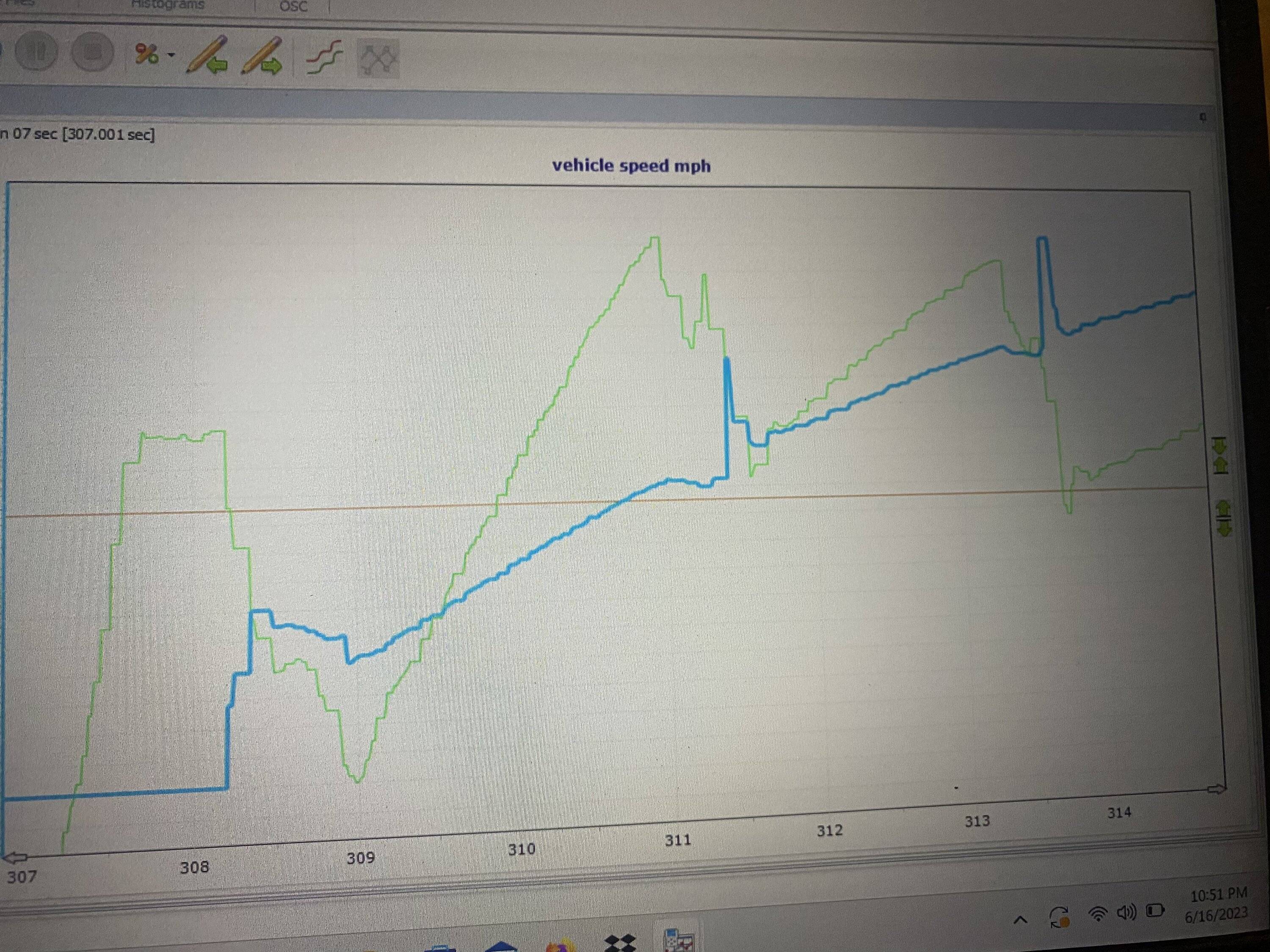

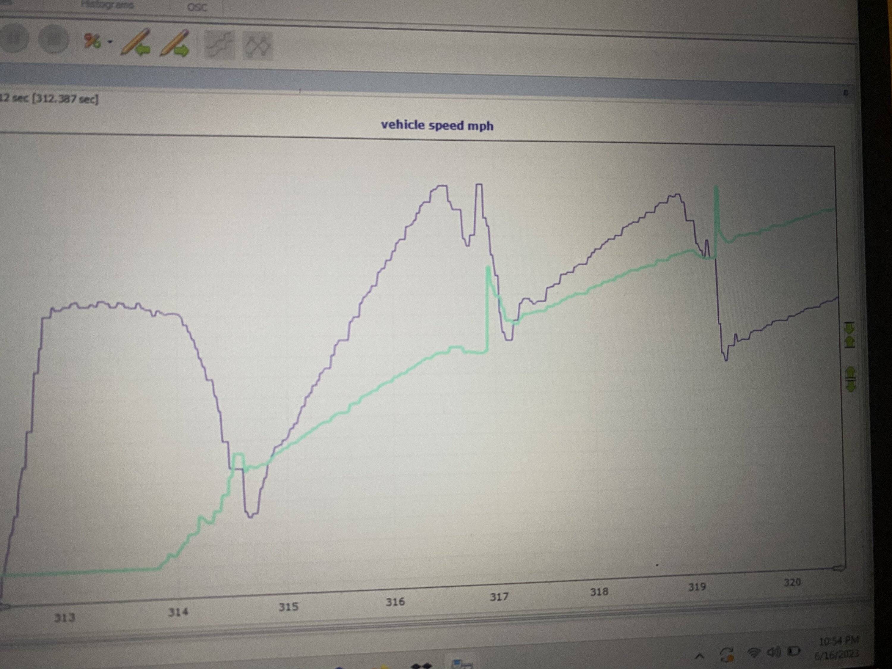

launching at 6k almost made a decent pass
graphs for rpm and speed
