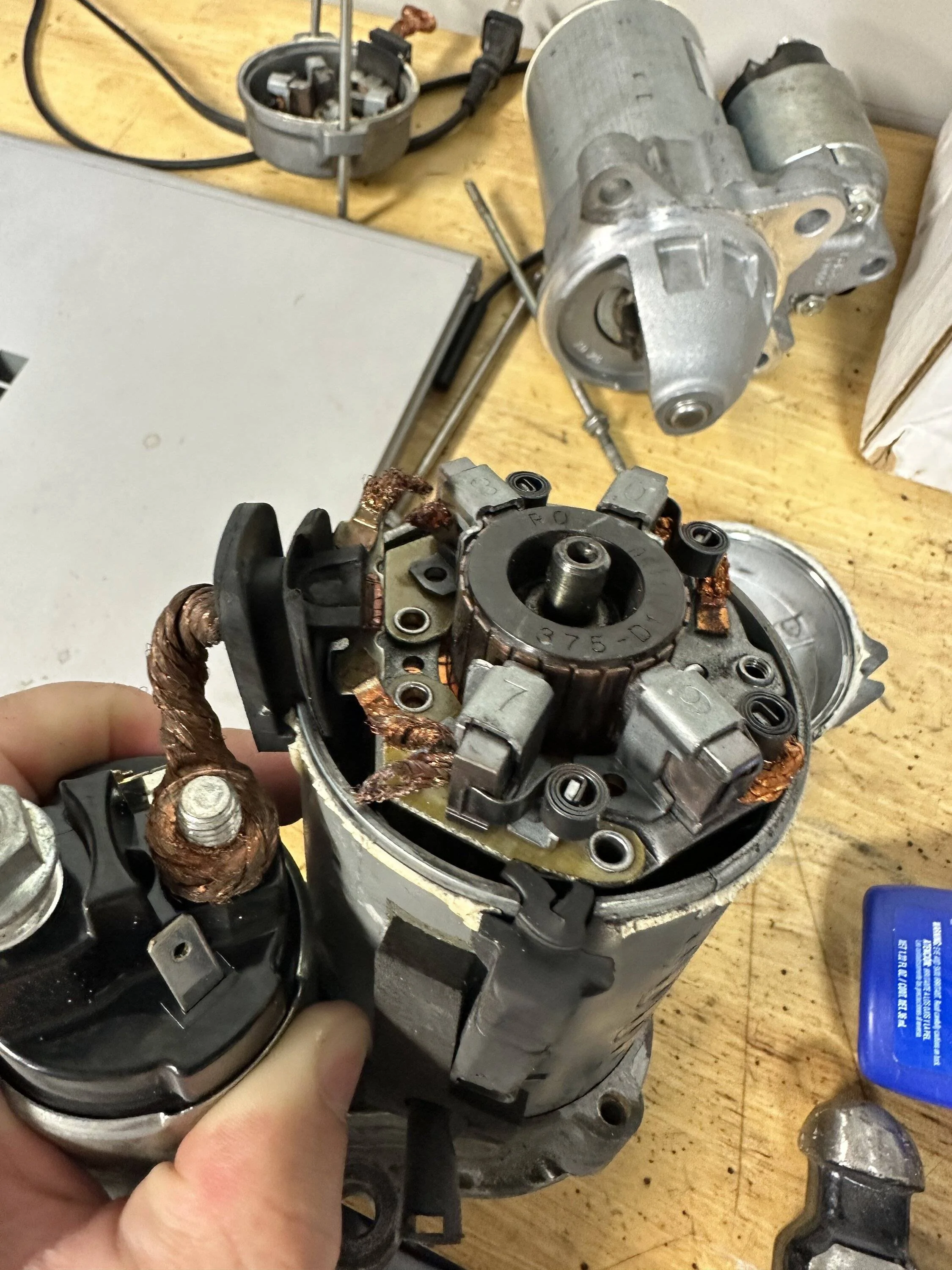

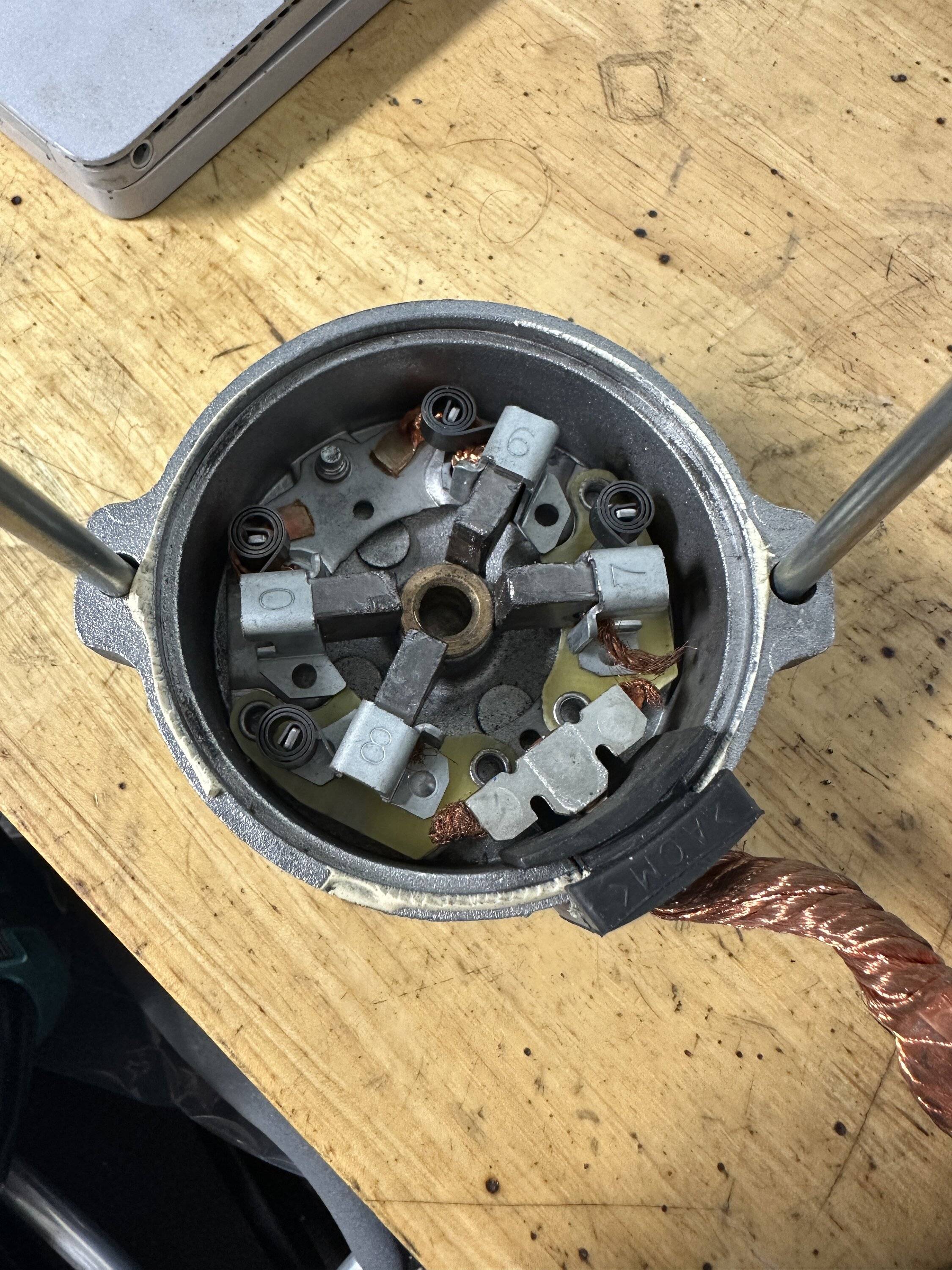

I didn't get a chance to test it for more than 6 months, but I've been very happy with the Powermaster XS https://www.summitracing.com/parts/pwm-9532
The build quality is very high and Powermaster was pretty adamant that it would survive (they also said no heat blanket - those kill starters according to the engineer I talked to).
For reference, I took apart a couple of my starters and they were dying because they were vibrating enough to fray the leads on the motor

Since starters are dying from vibration, would be curious how starter life changes from lowering peak engine rpm. If not competing, and only doing regular track events, try shifting at 7k rpm. Not as fun as winding out the engine to 8250 but not fun dealing with dead starters all the time. Plus you’d be surprised, can have just as much fun on track shifting at 7k.

That’s interesting. Never thought about the flat plane vibrations killing them vs heat. I will try the aftermarket one next. Free warranty replacements is nice but if this can actually be fixed for $300, I’m in.
