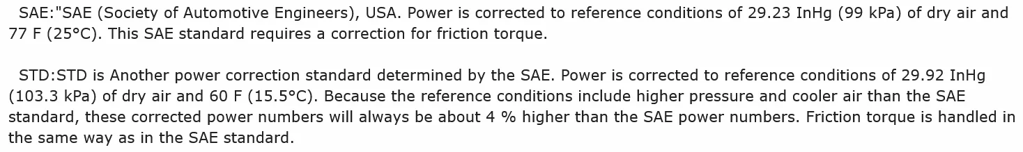

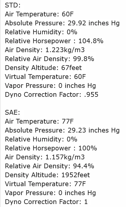

Without going too much into details STD snd SAE are the 2 major standards for dyno measures.
SAE represents more realistic standard conditions, STD is uncorrected and some refers to it as " boosts numbers"
In our case STD reads about 25whp higher.
But key is not to focus on absolute values. But more on the DELTA between mods in order to track the car progression.
Not every dyno jet is calibrate the same.
And even a new update of their software can make a difference up to 3% in readings.
3% of 450 hp is almost 15hp.

Many dyno graphs posted are SAE corrected. STD correction will show a higher number than SAE. Comparing your number to someone else's will have a ton of variables. The only way to know how much power a given modification may produce would be to see a before and after graph, same car, same dyno, preferably same day.

Does your Dyno sheet show a correction factor? May be 1.05 or 1.08. If 1.05, your 437 RWHP would roughly translate to 416 RWHP SAE though there are still other factors that can change the number.

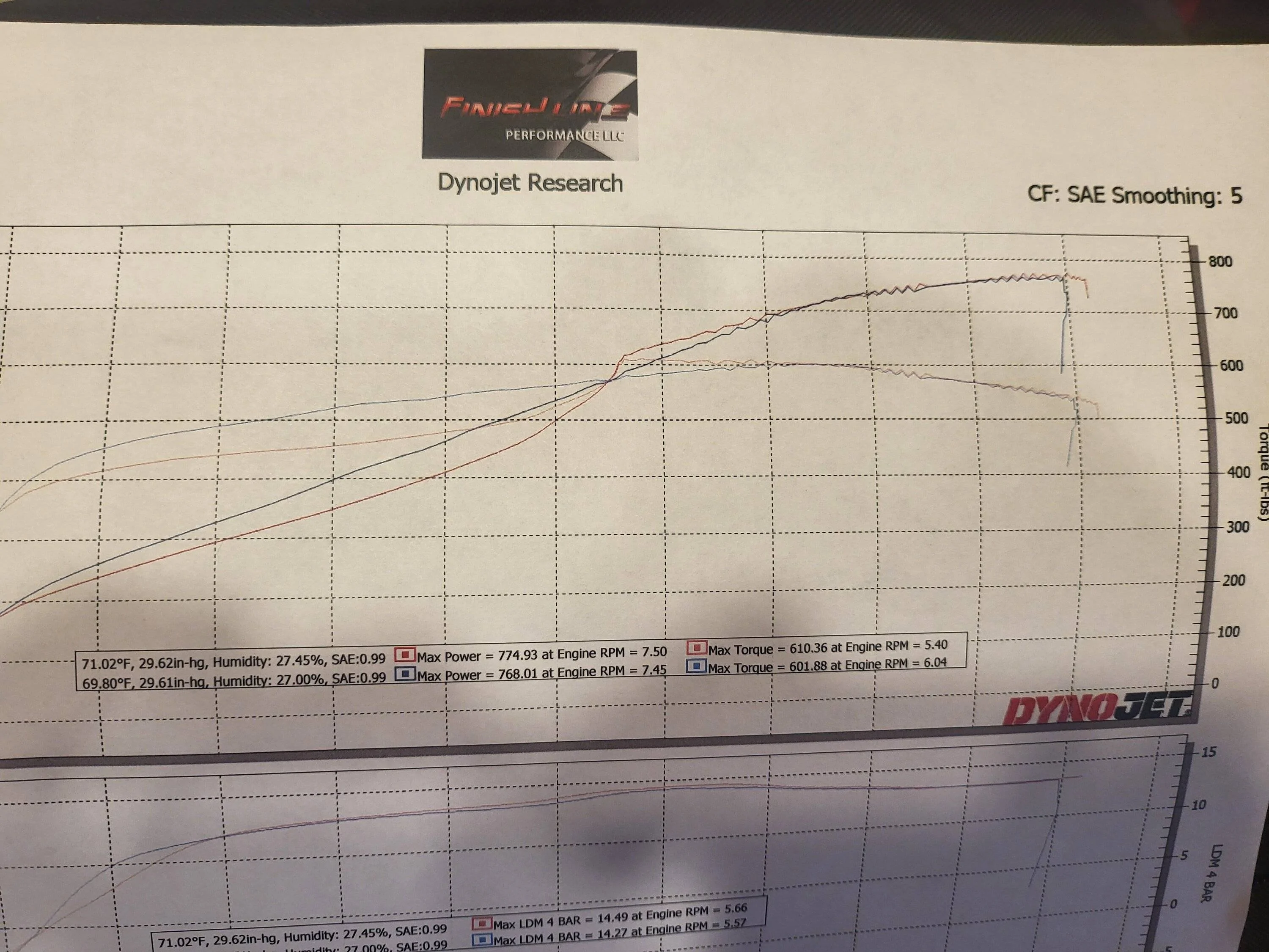

I'll quibble with you a bit ! -- at least with Dynojets since i have 25 years experience with them, I believe I can discern a reliable result and not worry about same dyno/same day. I mean that the correction factors do what they are supposed to do. Very possibly forced induction, more than say 3% away from 1.00 correction, the correction factor may not work accurately. I used two Dynojets with my Mustangs, one is a heavier drum/higher horsepower unit. From the shop's statements and my comparison between the two, I estimate the heavier drum dyno is about -1% to the standard unit or around 5hp. There are things, of course that can make it hard to estimate the impact of a modification. I see a few hp in pulls as my car warms up and I understand this to be reduced drivetrain loss from warmer fluids... as otherwise engine heat soak is going in the other direction. Determining whether a change is worth 2-3hp, very hard to be definitive, even back-to-back runs. Finally, I won't use a dyno where I can't have the run files. You can evaluate correction factors, compare to logs you took while on the dyno, at your leisure at home.

E-85
6Th Gear Pull on Drag Radials, 775@7500
