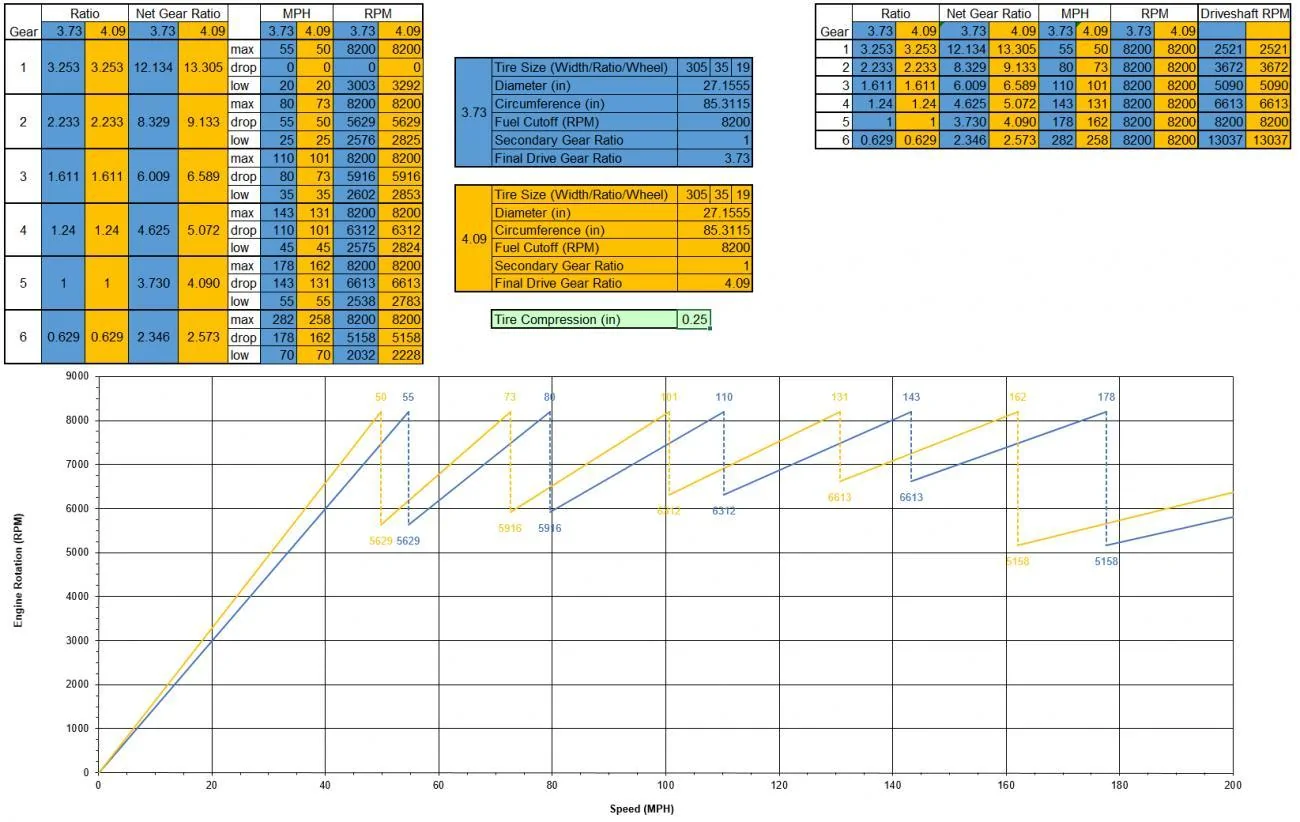

Anyone compiled a speed in gear delta with these gears?
Adapted from a spreadsheet I found on the Internet...

It looks like it could really use even more gear - like a 4.56 or possibly something over 5.xx. 4.09 just doesn't make much difference looking at the speed in gear. I agree that 4.09 might be faster on a track - depending on how long the straights are.
First gear is just way too crazy tall. I should say - it's fine, but really set up for a road course and not optimized for acceleration on the street.
