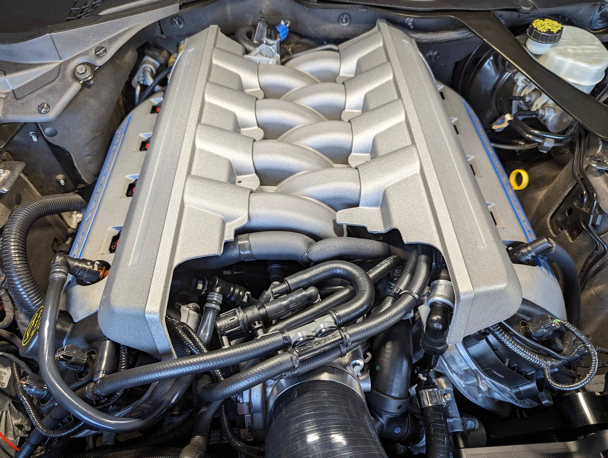

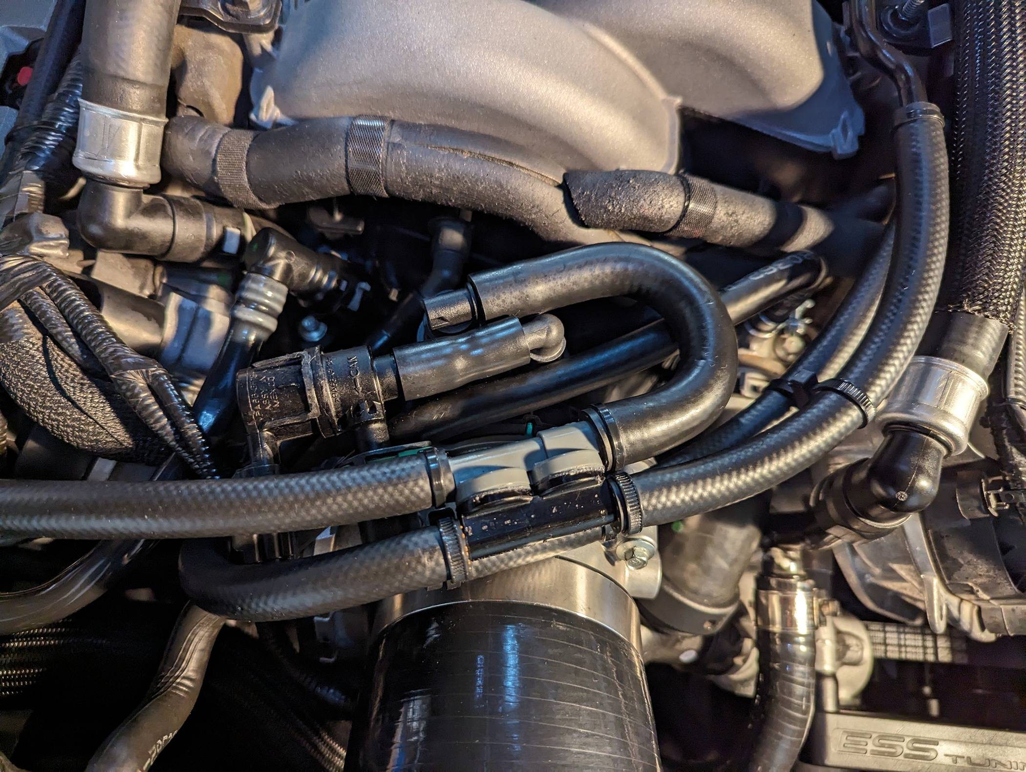

Take your time and route everything neatly. I kept my purge valve at the same location instead of using the '18 set up and lengthening the wiring. Also, keep your IMRC's enabled. You won't hear that often on this forum.

Well, your engine cover won't fit without bracket fabrication. Then surgery is needed for it to clear the IMRC.
If you remove the center section the covers post's will slip into the '18 manifold. I just wanted to cover the fuel rail sections.

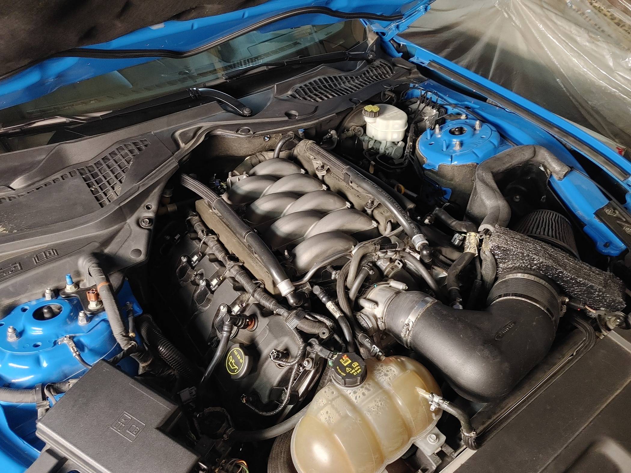

I think it's Purdy! thanks to @cmoneyracing and yes eliminate the IMRC.
I saw the intake going towards the pass side and thought "wtf he got where the intake was, thats a big space"
.Oh..........
How much power you making?

Are you referring to the "Turbo Guard" if so, yes, I added this in place of the intake that came with my setup. Apparently, it's an easy 40 to 50hp gain by eliminating the intake. (Keep in my mind that my car is not driven daily) The guard does get dusty though. With each car wash I always clean the engine area (wipe down) just recently, the guard had light dust.
As for power, Unsure at the moment since it has not been on the dyno. If I had to guess I'm probably at the 650hp or above but possibly under 700hp with my setup. Sure he'll feels like it 😅 I have a video on here when it was on a dyno and I think it made low 600hp and the car now is another animal to say the least.
Last thing on the List is Fuel system/E85 😳🫣🤦🤣
Tuned by Wengerd Performance 🏁

The sheet metal coolant tank definitely helps with tying everything together too. Also kudos to @Magony15 that modified stock cover looks really neat.
Magony15
Jun 11, 2016
158
109
Northern Illinois
2015 GTPP Base/Prem, 2009 Ram 1500
Thanks. Lots of Dremel use.
