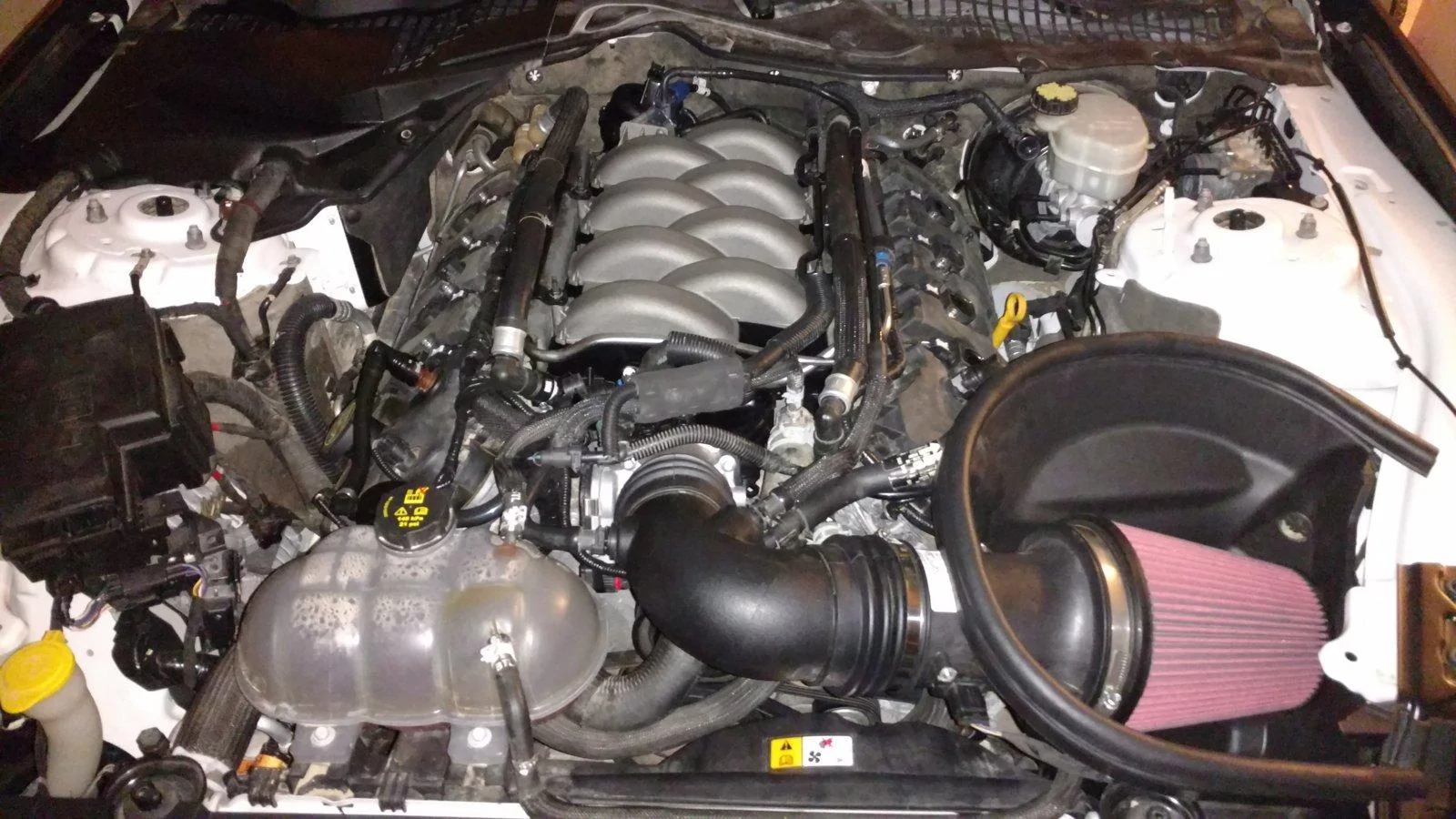

You don't have to delete your imrc's like others are saying, my tuner "Lund" recommended that i did but i did not want to lose any torque down low. Lund even has a guide on their website that i used to keep imrcs along with the plug and play harness and have not had any issues keeping imrcs. You will also need some small stainless worm gear hose clamps to keep everything down and to keep your purge valve on the hose. The vacuum line job is much simpler without the imrcs i will admit and the idea of cleaning up the rear of manifold is enticing. I ended up not even using any of the extra vacuum line i bought for this as i just scavenged everything off the old one including inner hard line to run atop coolant lines to top of imrcs. My engine bay is really dirty for reasons i dont want to discuss, but this shows most of the routing using all old hoses and connectors made to work from old intake.
Thanks for the pic. I'll be keeping my IMRC's as well. I guess I will need to review the install a bit more. I thought you just needed the plug and play harnesses and you were good from there as long as the voltage is set properly in the tune? Or am I going to have to learn soldering? Lol.
I've got a 17 so I'll be down a hose on the intake.
No just buy a plug and play harness, see link for where i bought mine from. I also agree with others to get the LU47 injectors at same time as well, otherwise you will need a retune if you ever decide later and i think it will cost more. Also i would get your state inspection before you start doing all this to give you time to work the kinks out if its coming soon. As for tune files, don't be shy and ask for a few of them, Lund gave me a flex tune(91-93 or E85) with all ecu/module checks disabled, another flex tune with all ecu/module checks enabled (needed when you swap back your cats if removed for inspection time, im on stock cats still), e85 tune an 85R (strictly e85 tune). I mentioned the two flex tunes because im in texas and they are pretty strict in my area about not letting you get inspected when things like O2 sensers, cat check, evap checks, misfire checks are all disabled.
